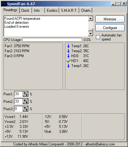

    After twelve or thirteen years of near-perfect 24/7/365 operation (only ever needing to swap out a power supply where Teapo did its magic), my trusty old 2.8 GHz Celeron system (aka Northwood P4) has suddenly gone from dead quiet to flogging the crap out of its fan. As in, while sitting with CPU temperatures under 30°C for several days it randomly jumps from 2400rpm all the way to 3000-4000 and then stays there sounding like a jet engine until power off, never stepping back down at all!
    Right now it's on 3750rpm and staying there while practically idle.
    The insides are spotless with no dust or anything (having recently been cleaned trying to find the problem), the heatsink has new silver paste on it and there are no bad caps in either the PSU or the mainboard. The heatsink clips are on tight and the CPU is not overheating in the slightest (at 100% load for five minutes straight the CPU goes up to 37°C).
    Additionally, all three fans speed up at the same time (CPU fan, rear case fan and PSU fan). If I deliberately try to slow one down with my finger, all three slow down and then speed back up - or the system itself will forcibly speed them up even more!
    Fan1/PWM1 in SpeedFan is the CPU fan, I can make it run faster but never slow it down more than what it originally was - I can even set PWM to 0 and it will still run at the same speed. All fans are 3-pin fans except the PSU fan which has 2 pins. Fan2/PWM2 has absolutely no effect on the rear fan aside from showing the RPMs, and Fan3/PWM3 is an unused connector without a fan. There also doesn't seem to be any fan settings I can change in the BIOS either (Award/Phoenix).

    Apparently not even SpeedFan itself works properly with this PC and it's been known since forever! A bug report from an identical PC way back in 2005 can be found here.
    Coincidentally, my PC has also had a Radeon 9550 since 2006, albeit Sapphire rather than Abit.
    Unlike my problem, theirs was the fact that they couldn't increase the fan speed - but it's clearly the same bug; the system immediately overrides it regardless of what value you force in the PWM section. My problem is that it just goes faster and faster and faster until it maxes out, without ever slowing down. Now it's sitting on 3924rpm while the temperature is virtually unchanged. The maximum speed for this fan is just over 5000rpm.

        This one is a Northwood so it doesn't have all the heat problems of the Prescott design. I recently swapped out the heatsink/fan combo with another P4 fan but it is still as erratic as ever despite remaining at the same 20-30°C temperatures - note that the rear fan is also speeding up and slowing down at the same time as the CPU fan. Right now it is actually running quiet as it is meant to be, but I can guarantee it will probably soon be like a NASCAR crate engine at full throttle while the machine sits idle at the desktop after a few hours!
        I can leave this machine running at full load for ages (e.g. 7-zipping a DVD image or running games in MAME which are too powerful to emulate for this system) and the CPU temp won't even hit 40°C.
        Temp1 and Temp3 are presumably both the board and/or ambient temp, they are always identical. Temp2 is the CPU temp.
        Also, I recently "upgraded" to SpeedFan 4.52 and it does not show anything whatsoever except for the HDD temps (not even the fans!), hence I am staying with an older version.
