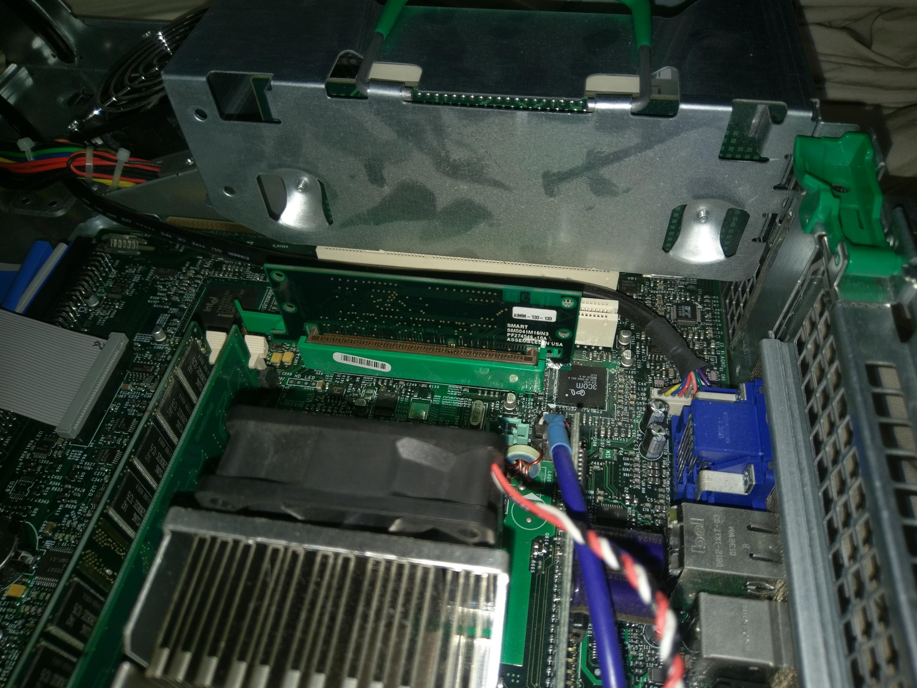

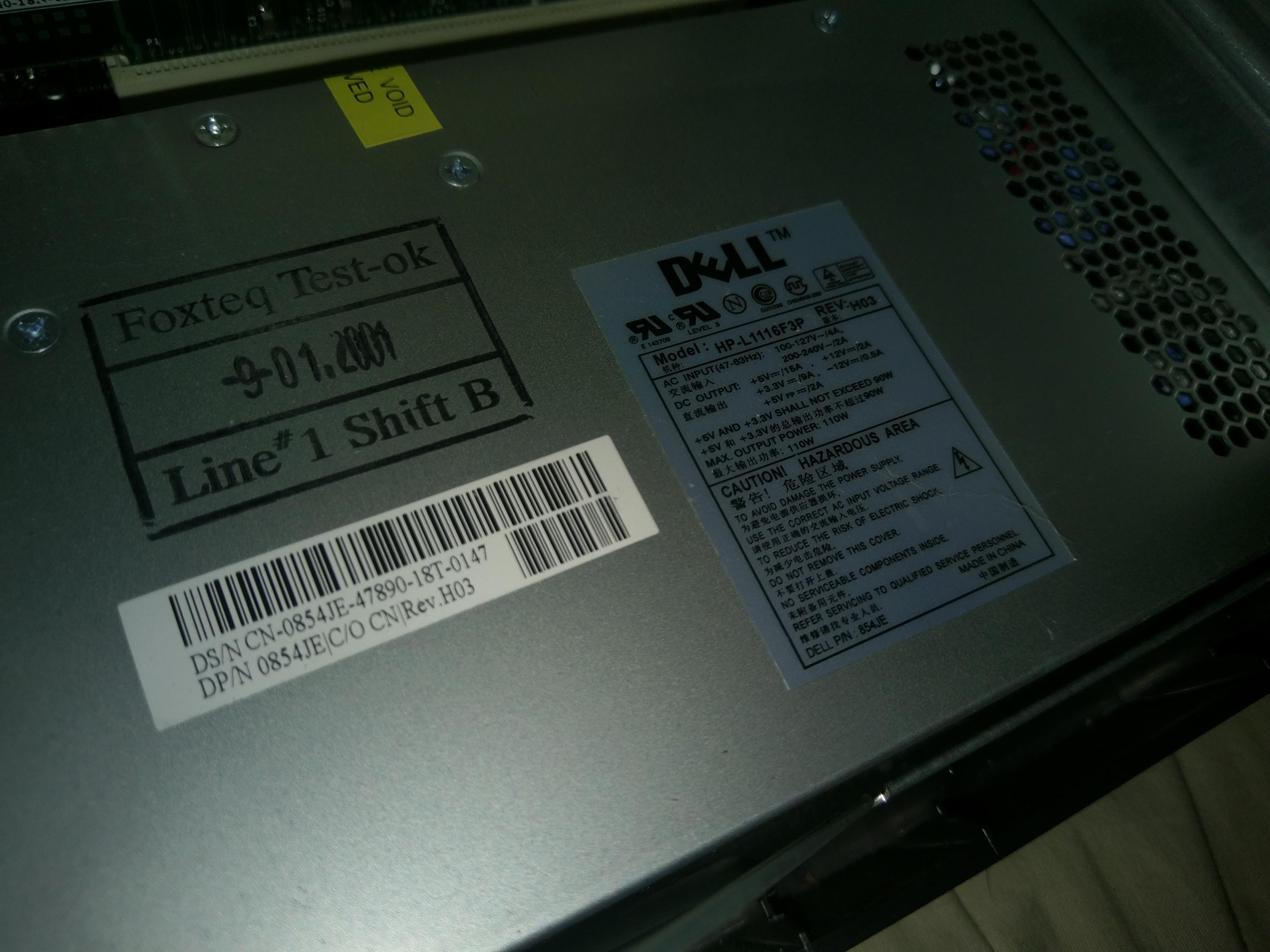

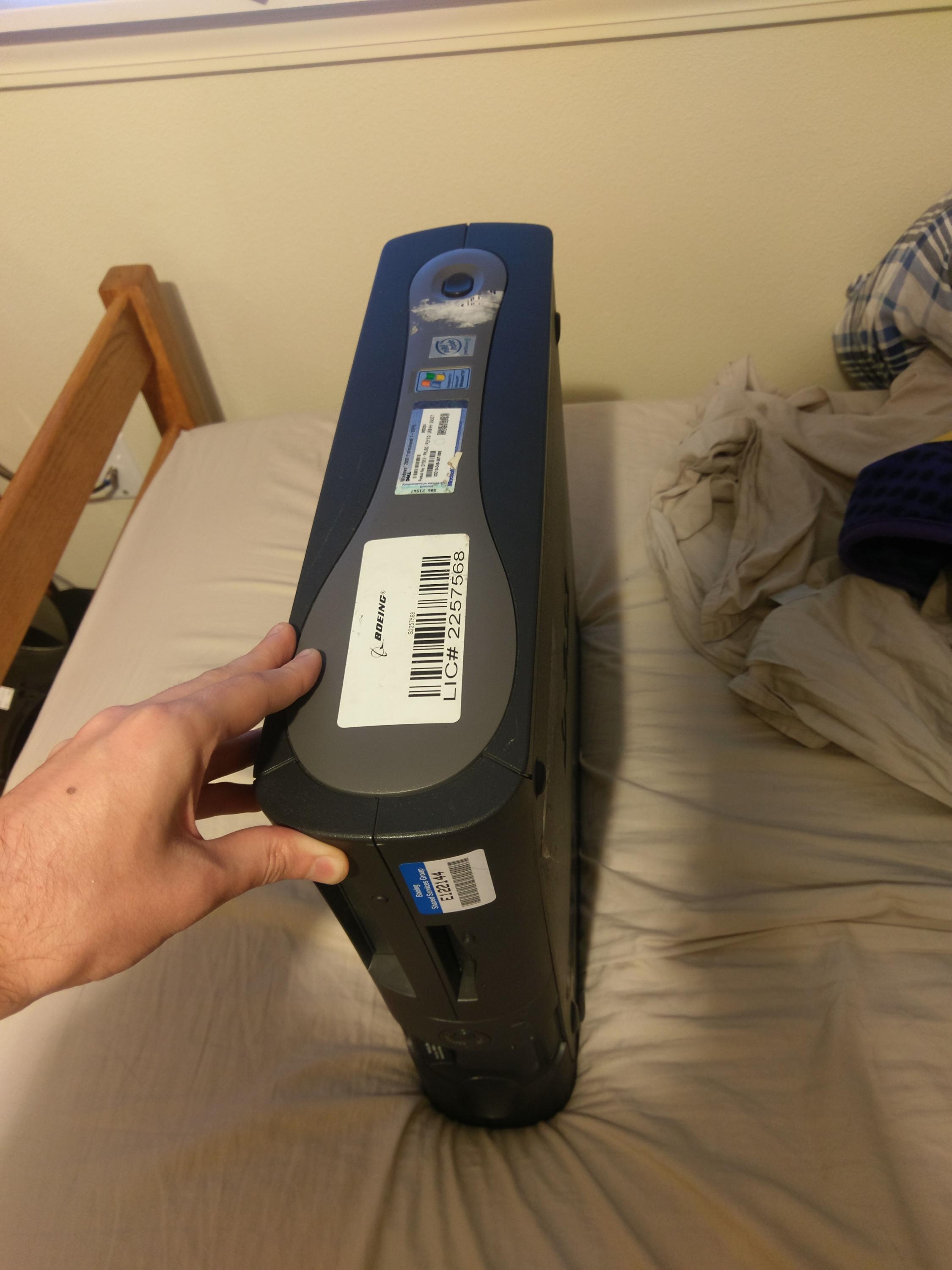

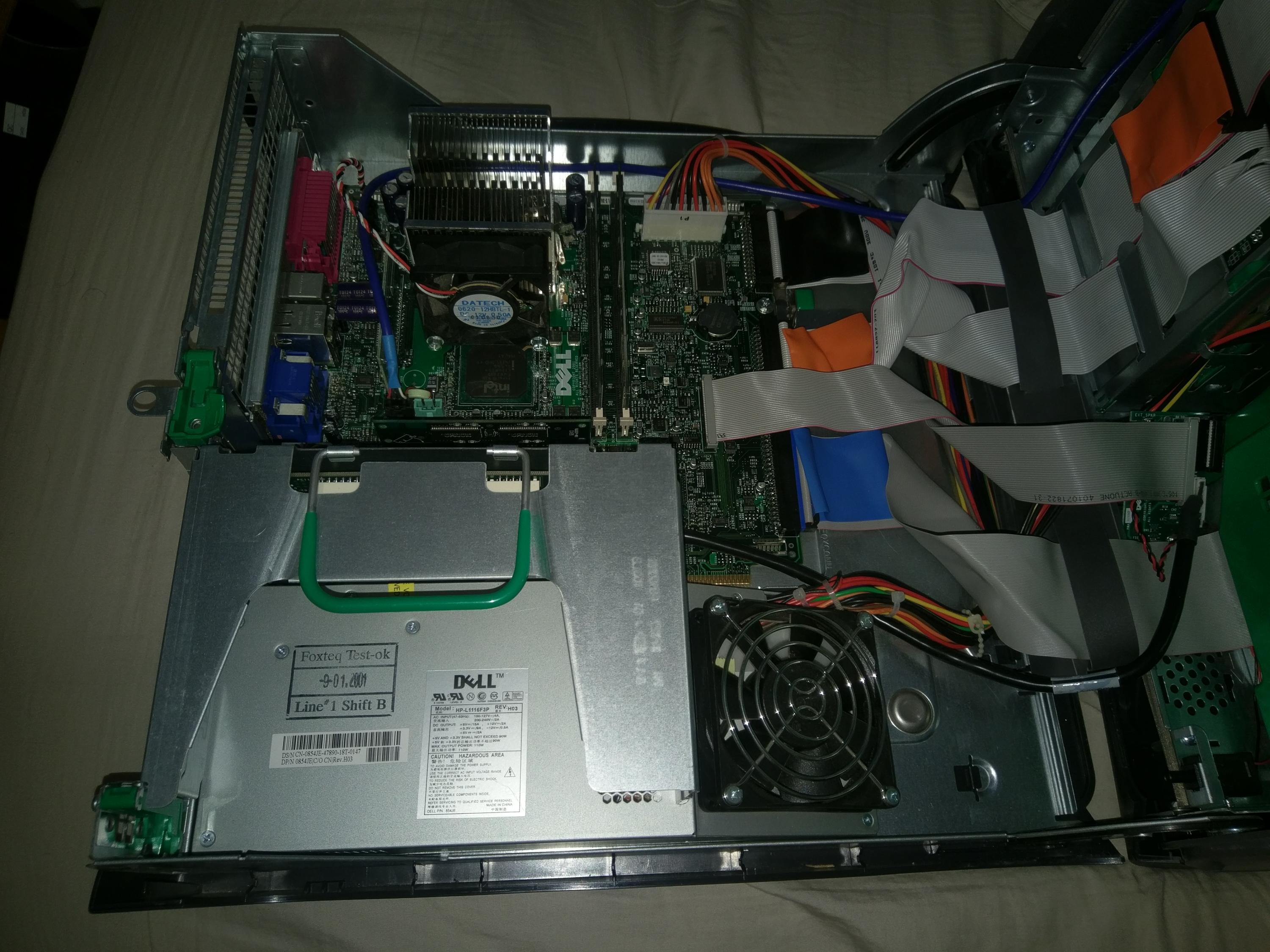

    A sweet dumpster find! How could someone just dump a perfectly good P3 system here?! As you can see, there are Boeing stickers on this. This was at one point used by a Boeing employee and they had a surplus store where they would sell used equipment. Unfortunately, they closed that store in December, 2007.
    I noticed right off that this thing was in pretty good shape. I didn't do any dusting. It looks pretty clean. I cracked it open in the parking lot to make sure it was intact. It used all Rubycon on the motherboard. The filtering caps are MCZ. They all look good....but if I use this (which I probably will) I might want to replace them.

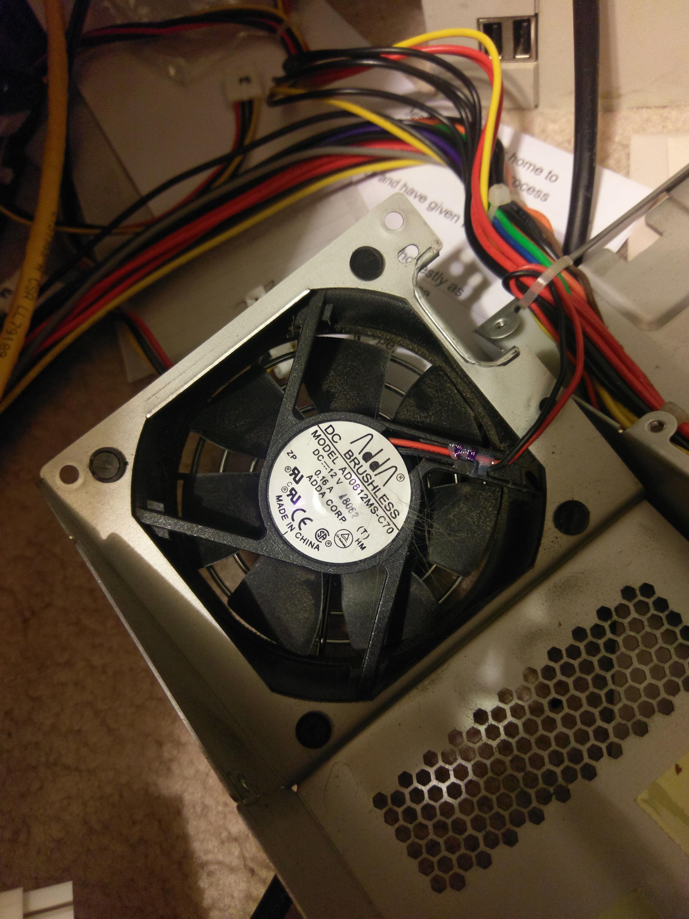

    The first thing I noticed when I powered it on was that the PSU fan is almost completely seized. It would make about 3 full revolutions and then come to a stop. I haven't opened it yet but by looking at the fan blades, it looks like a Sunon. I can also see tons of Teapo caps in there. Those will be going.... It powered on and fortunately it had the original 20GB WD drive in there. Only 31,390 power on hours on this bad boy. It's just breaking in!
    It's maxed out memory wise, with matching Samsung modules to make 512MB 133MHz. Speaking of. What is that card that's in the AGP slot??? Is that just added memory for the integrated graphics?

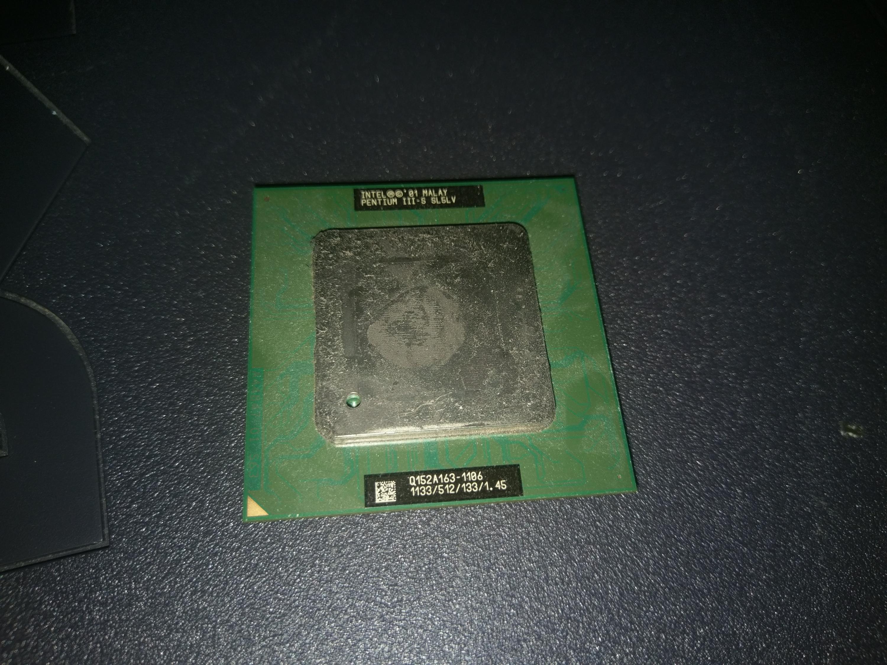

    The stock CPU is a Coppermine 1000/256/133. I noticed while it was running with the top off that the CPU heatsink got warm pretty quickly. Probably because of the original crappy bubble gum "paste" Which brings me to a few questions....Will this support that pictured P3 server CPU I have sitting there? Will I have to remove the IHS to install it? And....is the CPU fan blowing downwards the best course of action for a chassis like this? Seems strange....
    I plan on installing PCI Gigabit cards in the expansion bays and installing pfSense to run my home router duties, and run a VPN. If it supports the better P3 that might help a bit with VPN encryption.

    That's a Tualatin CPU, you need to research the chipset and see if there's Tualatin support....but odds are it won't....there weren't a lot of 'big box' systems that supported these. it would be a nice upgrade if it would.

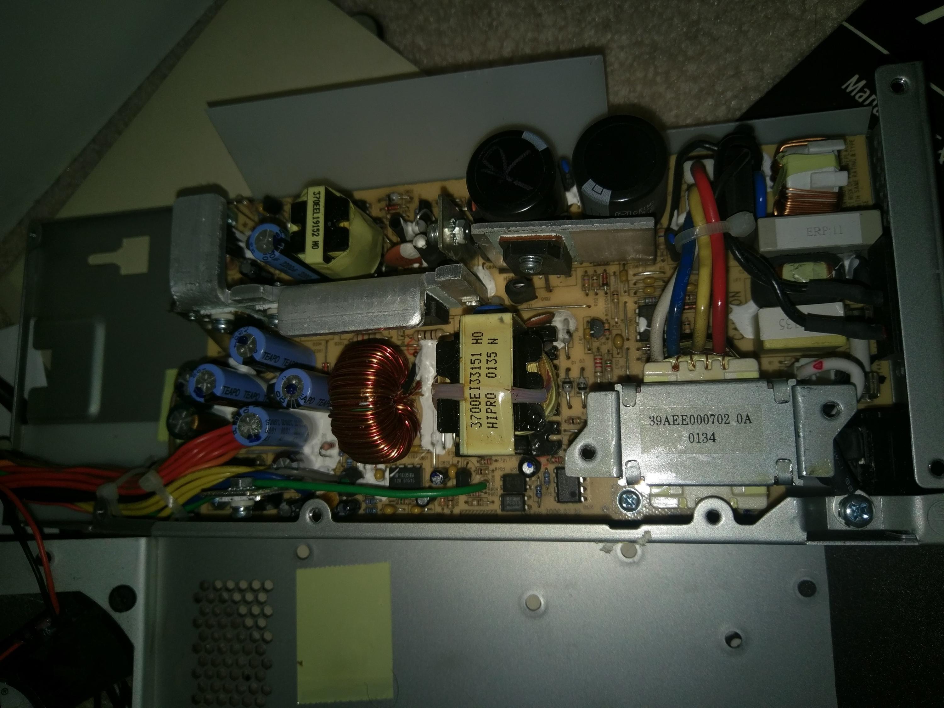

      Okay, I hate to be a buzzkill but I’m pretty sure they are actually MBZ unless the board was previously recapped (the blue and gold sleeves denote MBZ). The GX150 boards are 2001 vintage, which was well before MCZ was in production. Looks like a nice score though!
      No surprise the Sunon sleeve bearing fan nearly seized after over 31,000 hours of use. Many Hipro back then used death ADDA fans, so the fan probably would have seized sooner had it been an ADDA. That JMC/Datech fan may not be in a good condition either. Those fans were failure prone compared to the NMB/Minebea equivalents.
        It's an 815E chipset. So it looks like it does support some Tualatin CPUs but doesn't show support for the 512k cache CPUs.
        Originally posted by Wester547
        Okay, I hate to be a buzzkill but I'm pretty sure they are actually MBZ unless the board was previously recapped (the blue and gold sleeves denote MBZ). The GX150 boards are 2001 vintage, which was well before MCZ was in production. Looks like a nice score though!
        I intentionally put the wrong series to see if you were still on your game Either way, I think they should be replaced if I want to use them. Even for high quality caps, they are probably getting tired.
        I'll see if I can oil the fan but I might just replace it. The JMC fan seemed to spin pretty well. Might not have one on hand with the same size, but I do have quite a few sleeve bearing fans around. Do you think moving air downwards is the best?

          The best way to find out is to stick it in the socket and fire it up. The VCORE difference is ~.3v, it won't fry by trying this.....if it POST's, its supported.
            Good...That's all I care about So then if it works I'd probably have to remove the IHS. I tried just to see and it was too tall to have the heatsink clamp down. Has anyone removed one before?
              Yup, I see a “T0124” datecode/factory code on them, which means they were manufactured during the 24th week of 2001 in Fukushima, Japan. That means they are well over 16 years old now. All the major brands don’t rate electrolytics for any more than 15 years maximum (mainly due to the evaporation of the liquid electrolyte through the rubber bung and the deterioration of the rubber bung), although I have seen many high quality electrolytics last much longer than that.
              I personally think those 2200uF 6.3V Rubycon MBZ may still be okay, but the only way to find out of course would be to pull them and measure them. Still, I’m sure they’re in much better condition than KZG or bad datecode HM would have been (but that’s stating the obvious...), both of which were used interchangeably with MBZ on these boards. I also wonder if the smaller Rubycon YK? are in-spec. Of greater concern may be the Teapo in the Hipro.
              If that’s the way the airflow in the case was designed, to exhaust the heat from the CPU heatsink rather than blow air onto it. The equivalent NMB fan is the 2408NL-04W-B66. The JMC fan may work fine for now but I wouldn’t be surprised if it failed sometime in the near future, especially with that much use. AFAIK and IIRC, these 2BB fans have shielded bearings even if they don’t have any sort of rubber seal, which means you would have to completely disassemble the fan to degrease and regrease the ball bearings.
                15 years? Interesting, because so many CRTs last forever. I've also pulled VRM high 1500uF 16V nichicon PW from a S478 board; the ESR was low and the capacitance was within 5% of original spec. They were 16.5 years old at the time. Is it just that the manufacturer doesn't bother to rate them after 15 years?
                I will pull them and test them. I'll probably even put polymer caps on the VRM of this board. I have another Optiplex from 2001 (With a P4) Where I put all polymers on the VRM of the board and it's worked well for more than 10,000 hours since then.
                Those will also get tested and replaced. I need to take pictures but I think it used mostly Teapo SD with two Teapo SC. None were bulging, but I don't trust them.
                The JMC fan seems to spin well but I actually have a brand new sleeve bearing fan sitting around that could do the job in a more silent manner. Although...if the machine was in an upright position, that would be the worst angle for the sleeve bearing to be running.
                Unfortunately it just beeped furiously when I tried it. I have a Tualatin 1.2/256/133 that I will try. Maybe it just doesn't like the -S P3 models.

                      Ah, so it does have a death ADDA after all. No wonder it failed.
                      The input capacitors look to be Panasonic, so you may not need to replace those at least. The output looks to use a mingling of Teapo SD, SC, and SEK series capacitors. I noticed that the +3.3V rail is linear regulated in this PSU and the regulator is on a finless heatsink - that can’t be good for the thermal output, which may endanger those already tired and likely out-of-spec el cheapo Teapos. Yet another reason to replace them. FWIW, I think the SEK and the blue SD / SX series is more reliable than the SC series, although not of such quality to be deemed trustworthy.

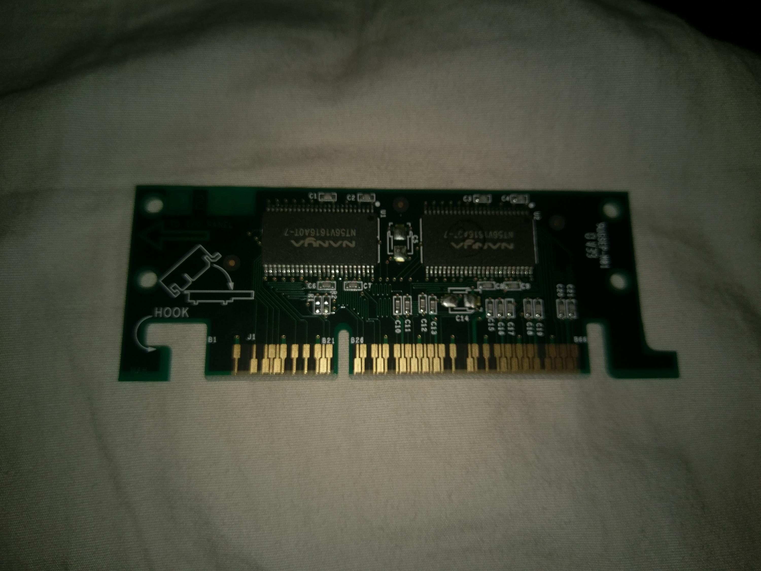

                        ... Speaking of. What is that card that's in the AGP slot??? Is that just added memory for the integrated graphics?
                        Correctomundo!
                        It's basically a Dell thing. Unless you plan to play old games on it, this setup with the onboard CDD (Crude Display Device ) should suffice for your needs.
                        Dell also had some weird AGP cards in the P4-era with a weird small chip and a single VGA output. I'm not sure if that was to add a second monitor output or provide extra RAM to the onboard RAM (the cards had a VGA D-SUB connector), but it was the same quirky stuff. Only the "higher-end" OptiPlexes and Dimensions came with cards like GeForce MX4000.
                        Though I do also have one GeForce 4 TI4600 that came from a late P4 model Dimension. Really nice mid-range AGP video card, but needed a reflow to get rid of the artifacts.
                        Yeah, that's weird indeed. Heat tends to rise, so it might be a good idea to reverse the fan. Better yet, make a fan duct over the HS and curve it so it exhausts the hot air from the back.
                        Dell in general made okay cooling designs back in that time period, but they could still be improved tremendously with a few hacks and mods.
                        Should be fine, as it's probably a ball bearing fan.
                        Ball bearing fans don't really fail - they just get louder and louder until they drive you insane. I recently recapped an old FPS PSU with a dual BB Nidec Beta SL 80 mm. Had to change the fan too, because that Nidec was LOUD! - as in, I could hear it from the room next door. The bearings were quite worn. Not shot, though, because they didn't make bad grinding noises. Adding oil/grease did not help them at all (I actually opened the bearings with a fine needle).

                        No, don't downgrade that JMC to a sleeve bearing.
                        Also, I do think you should flip the fan up.

                          Well, heat generally does rise but it can rise, descend, or even move sideways depending on the orientation of the computer and the design of the chassis. I definitely agree that Dell’s cooling designs were less than ideal, even back in those days. Can’t hurt to experiment with it, as these old PIII CPUs don’t run that hot anyway if even that.
                          JMC double ball bearing fans were known to fail quite profusely back in the day. Just because it’s a 2BB fan does not mean it will last. If you Google their Dell model numbers, you will find many examples of failures, dating back to well over a decade ago.
                          Generally, ball bearings made by Chinese/Taiwanese companies (like Datech) are nowhere near the quality of those made by Japanese companies (like NMB and Nidec). I had a thermistor-controlled 9232-12HBTL-2 fan die over five years ago after 17,000 hours of use and no amount of greasing or oiling made any difference - the bearings were dead, even when I used a screwdriver to try to short the leads of the thermistor (to force the fan to run at +12V), and even after desoldering the thermistor itself, the fan would not run at all. It had been slowing down considerably before it finally seized. Removing the sticker did reveal an open, shielded 2BB fan (it wasn’t a 1B1S gimmick).
