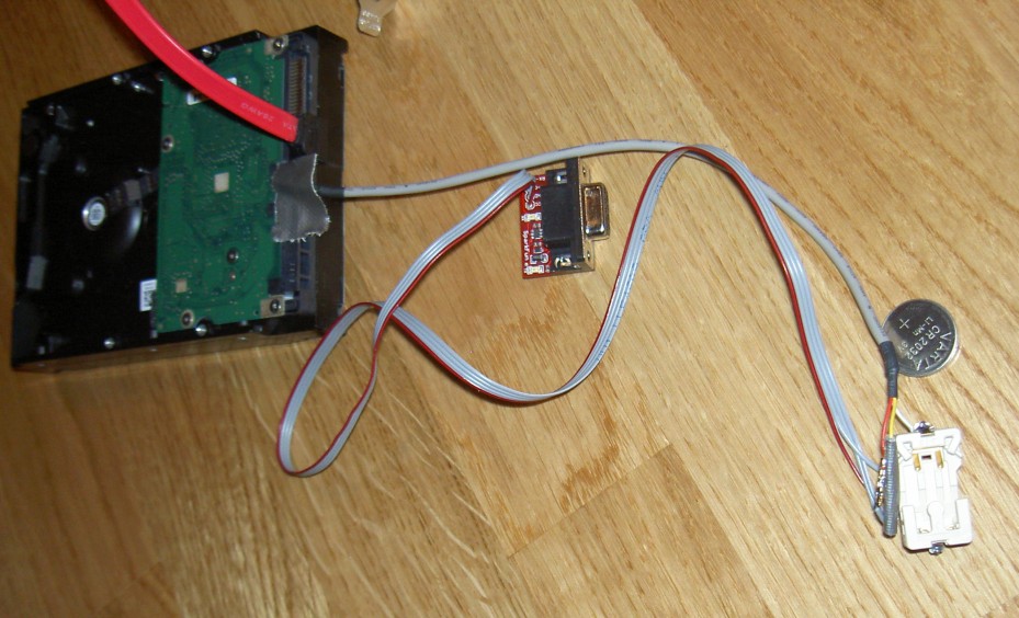

                            I'm resurrecting this old thread and bringing it back on track by saying I just fixed a Seagate 7200.11 ST3500820AS drive with firmware SD15
                            It had the "BSY" error (not even recongized by systems BIOS and computer hanged when the drive was attached to the system)
                            I bought a new nice TTL interface because my old one was, well, not the prettiest thing in the world
                            Following this guide everything went great except for the instruction to reverse the TX/RX pins on the TTL interface > drive, I had to have them TX>TX and RX>RX so I guess my TTL interface is labeled "incorrectly" (or just more logically if you will )
                            I soldered my wires directly to the drives PCB because I could not find a suitable header for the drives jumper block, and I used cardboard from a milk box to insulate the drive connectors per the guide
                            After the process was done all of the users data was readable, now that I have recovered the data I will try to flash it with the latest firmware SD4A-2D tomorrow and then run Seagates test program on it to see if it works well, then I might put it to use somewhere
                            These where the commands I gave the drive and it's response;
                            Code:
                            F3 T>/2
                            F3 2>Z
                            Spin Down Complete
                            Elapsed Time 0.140 msecs
                            (Comment; now remove milkbox cardboard and secure torx screws)
                            F3 2>U
                            Spin Up Complete
                            Elapsed Time 6.410 secs
                            F3 2>/1
                            F3 1>N1
                            (Comment; now power cycle the drive)
                            F3 1>
                            F3 T>m0,2,2,0,0,0,0,22
                            Max Wr Retries = 00, Max Rd Retries = 00, Max ECC T-Level = 00, Max Certify Rewr
                            ite Retries = 0000
                            User Partition Format Successful - Elapsed Time 0 mins 00 secs
                            F3 T>

                                    #97
                                    Re: Seagate 7200.11 turds
                                    I fixed another one
                                    Same enduser, when the first one failed (the one that I repaired in the post above) he got it replaced under warranty...
                                    Know what the suckers at Packard Bell did?
                                    They put in a 7200.11 with the exact same firmware and also manufacture date!
                                    09013
                                    Just amazing work of them!
                                    This one also works fine now that I did the recovery procedure, I have already flashed the first one with firmware SD4A-2D, it works great...
                                    Will flash this one too but it was a pita because only 1 of 5 computers I had would let the firmware update thing run properly! (And of course this one had only SATA ports so I had to borrow a SATA CD-ROM from one of the others!)
