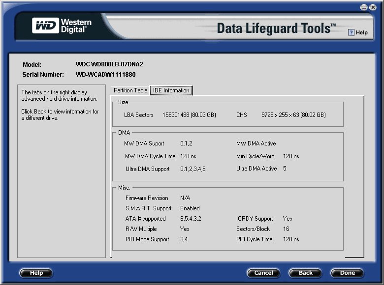

                      current status of HDD
                      Reading this thread I become curios so I searched for tools to read my SMART status.
                      I tried 3 tools: smart.exe, HDD Health and Western Digital Data Lifeguard Tools.
                      The last one doesn't give any information about HDD health even if my system HDD is WD; ok it seems to have some useful tools... but what about the HDD life status?

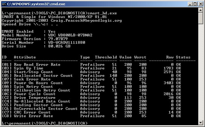

                      smart.exe read the parameters and everything seems OK.
                      HDD Health said my WD HDD is critical

                      P.S: it is curios that Datalife can't read firmware revision while the other tools can

                              It seems that smart_hd.exe and WD "hdd health" are giving conflicting information. If the WD utility is the most recent, I would believe its output over the 3rd party utility output.
                              Look at parameter ID 03: "Spin up time":
                              smart_hd.exe
                              value: 95
                              threshold: 21
                              hdd health:
                              value: 95
                              threshold: 200
                              So for smart_hd this parameter is OK, but for hdd health, it is a sign of error.
                              The SMART table consists of a list of parameters. Each of them has three values associated.
                              value: actual value of the parameter.
                              worst: worst value the parameter took on the past.
                              threshold: lower value the parameter can take without signaling a failing state.
                              All these numbers are on the 0-253 range.
                              The "raw" column gives the actual value of the parameter before being normalized into this range. For some parameters it has a real meaning. For example, the Power On Hours Count gives the time the hard disk was switched ON.
