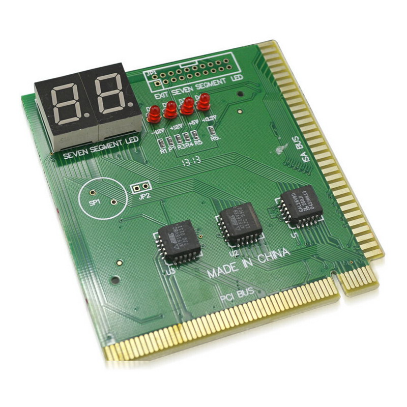

    I'm in the market for a good POST card reader. Does anyone have any suggestions?
    I was looking at something a bit more fancy, kinda like this:
    https://www.newegg.com/Product/Produ...7574-_-Product
    But if you guys have any experience with any of them and can recommend a real good one, I'd appreciate. Right now, it's for a desktop. I wanted one that had multiple connections. I see some work with certain laptops. That could helpful, although I don't really expect to find one that'll work with all laptops.
    I've seen some that have USB ports and I'm guessing certain laptops now send POST codes through the USB port. Does anyone have any experience on that? Is it fairly common now to find laptops that do that?
    Thanks!

    I have no idea, but I bought a cheap one once ages ago. It didn't work very well except in one machine, and when tested in another it died and took the motherboard with it.
    I would say you'd have to go by the feedback, find one which people seem to like.
    I do notice though, that that one says "The compatibility passed the test for a series of motherboards of INTEL 815,INTEL 845,INTEL 865,INTEL 915,INTEL 945 INTEL 965 ATI SB600,ATI Xpress 200,ATI Xpress 1100,AMD 480X chipset."
    I am going to assume it only works with those chipsets, or at least, it can only produce meaningful results with those. Which is a bit limited...
    It might be more useful to buy a book like the laptop repair one here: http://www.chinafix.com/thread-962449-1-1.html (which could also apply to desktop motherboards) or otherwise learn more about how to troubleshoot the board, because I think that most repairs will require knowledge of how to test at board level rather than just expecting that card to do all the work for you.
    I repaired an MSI motherboard (Post is on here somewhere) just looking at the schematic and testing voltages mostly. It turned out the NB and RAM buck regulator controllers were dead.
    I doubt a POST card like these would have told me anything of the sort! Since the NB was not getting power, I expect this card would have simply said nothing.

        I use an old PCI POST card i bought form dealextreme many years ago and it works nicely, the problem with this kind of hardware is that you don't know the exact order of the condes in the boot secuence and it can add more confusion, but it's usefull to see things like the reset signal or if there are changes when you use a different ram.
        Keep in mind this cards won't work with most laptops unless you take the schematics and solder the cables to the right place.

          Thanks Cpt.Charlie. When I was going through college, I thought the POST process was the same on all computers. I thought the order didn't change any. Are you saying that's not the case?
          Also, yeah, last time I had checked, it was almost impossible to see the POST codes on a laptop. It's changed a bit from what I've read. Some laptop boards now support it via a mini-PCI-E connector or something along those lines. I think some even provide them via USB port.
          I'm interested in the soldering stuff you're talking about. Do you know what points I'd be looking for on a board to solder stuff to? I doubt I'll find schematics now-a-days, but that could be a real fun project. I also wonder if there's some way to read them without a POST card reader using some of the equipment I have around here....I have to admit, I don't fully understand how the POST codes are generated and I don't know much about the PCI connectors with their pinouts and everything.

            It looks very very much like this one: https://www.aliexpress.com/item/Comp...595977642.html
            Now that I think about it, I probably inserted the ISA connector wrong. It's not keyed and the manual was in Chinese.
            Interestingly, here's the schematic for one which operates on the ISA slot - no use now I guess, but interesting to see how they did it then. http://bbright.tripod.com/information/postcard.htm

              Wow, thank you. I think I see what the Capt'n was saying. I'm going to be referring to just Desktops, unless I specific otherwise. I didn't realize different manufacturers used different codes. I've never used a POST card reader before but I've known about them for a very long time now.
              From looking at that link, it almost looks like I can just build one for a PCI connector, doesn't it? I mean, I'd have to modify it a little, but I don't really need the 7-segment display right now. If I got it in binary, I could just manually convert it. The ones I saw all had some sort of surface mount chip soldered on. I thought there was more to it. Maybe that's because the ones I were looking at were for more than one connector.
              I wonder how hard it'd be to rig something up real quick like, just to try and read the codes. If I could get a few LEDs to light up with the code, that'd be great.

                I see some boards don't give POST reports on the PCI bus at all, on those boards, a POST card reader won't work, obviously.
                I think I'll probably go for the red one I first linked to.

                  i use a hde post card that i got off amazon. the 4 digits instead of 2 are useful to find out what it was doing before the post sequence hung up.
                  obviously, dont rely on the post code manual that comes with the post card. the post code "translations" may be for 80s or 90s era 286, 386, 486 or pentium pro bioses. different bios manufacturers (phoenix, award, ami, ibm bios etc.) use different hexadecimal codes for different post checkpoints. even different bios revisions from the same manufacturer use different post codes. the post checkpoint boot sequence is different also.
                  there used to be a postcodemaster.com website that had all the postcode checkpoints "translated" so u know what it was doing or booting at each post checkpoint. but i think the website owner forgot to pay the bill or sumthing and the site is gone. i did manage to save the post code "translations" for the latest ami and award bios which are the dominant bioses used on post-2000 era mobos.

                          The boot secuence depends of the chipset (and bios software) AFAIK, but the meaning of each code depends of the bios maker model and version
                          I think USB is used to provide power to the post card, most mini pci-e connectors used at laptops won't provide post codes just reset signal.
                          Consider the following image:
                          To read post codes in laptops you need the signals LAD0 LAD1 LAD2 LAD3 LRESET# LFRAME# LCLK these signals are generated at the EC (sometimes the manufacturer is kind enough to take the signals to a pad for testing in production)
