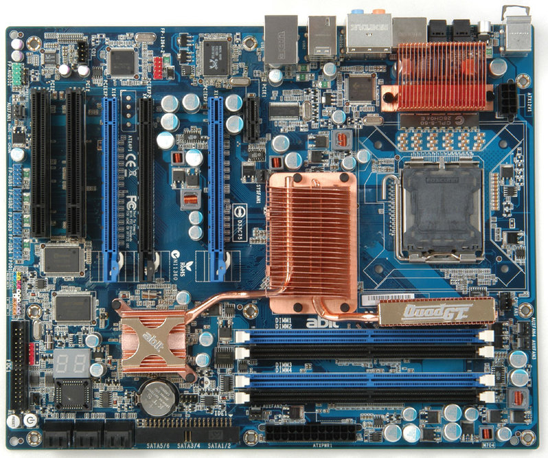

                        Well.......there's been some updates in this little saga......
                        On or about April 18th, I booted up this beast. It booted just fine. It had been sitting for over 4 months. Then I remembered something about the HS that I had bought for it and its proper orientation. Seeing that I couldn't mount it properly, I bought another HS/Fan. I put it on and it was running fine...........
                        ...until today. I just noticed today that it wasn't producing. Same old situation. Runs fine for about a month. Then dies. I'm going to let it sit for a week and try it again. This is really odd.

                            If you have that goofy Chipset heatsink with a pipe connecting north and south bridge take it off, cut the pipe connecting north to south, and reinstall the two heatsinks [now not connected] with some fresh thermal paste.
                            Because they don't heat/cool at the same times and with thermal expansion/contraction [even just due to load changes] that pipe pushes or pulls the heatsinks around on top of the chips.
                            I saw a case elsewhere in which the north, south, and MOSFETs had heatpipe interconnected heatsinks. The north bridge was in the middle and it kept overheating because as the pipes expanded it was being lifted slightly off the chip. .. Or at least that was the conclusion when clipping the pipes fixed the problem.
                            You may also have static building up some how.
                            Make sure all the ground points are making good contact.
                            Airflow across some plastics can make static so make sure all the fans are actually PC fans.

                              This is the board....for the most part....
                              I see what you're talking about for the heat pipes. I saw some versions of this board and there were no heat sinks at all.
                              How do I get these off? Tell me I don't have to remove the mobo (again ). And what about that piece by the memory slots that has 'Quad GT' stamped on it? I don't think there's anything under it. Just makes it so I can't install the other HS/fan I had before.
                              The fans are PC fans and everything is grounded.

                                The closest Abit board I have to look at is a IP35-E. Should be the same about that.
                                The black spring loaded rivet pins are shaped like an arrowhead on the underside of the board. Use a small needle-nose pliar and pinch the arrow-head closed so it will slip back through the hole. [Be careful so they can be reused.]
                                If the piece with the GT isn't fastened to the board then it isn't doing any pushing or pulling so you won't need to mess with it.

                                      well...i'm at a loss...again.
                                      it sat for two days. still stops at 99.
                                      i'm thinking about just finding a good Intel board as a replacement. Chalk up the big bucks as a lesson learned. Funny....Abit is out of business now. Guess they didn't learn their lesson from the badcaps dayze.
