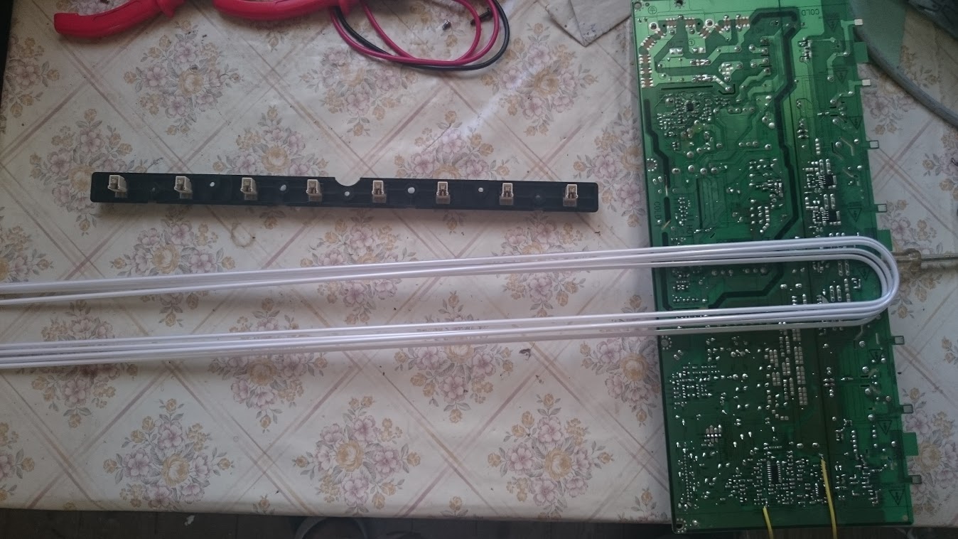

    My 7 year old Samsung CCFL LCD lost the backlight. It would just blink for a moment after turning on.
    I got to this forum via Google and after some tests and measurements suggested in this thread, the backlight started acting moody and I realized that diagnosing and repairing it wouldn't be an easy job.
    But then an idea came to my mind: let's remove CCFL, put the LED strip in and voila - "LED" TV
    Without any research, a couple of minutes later I had this on my table:

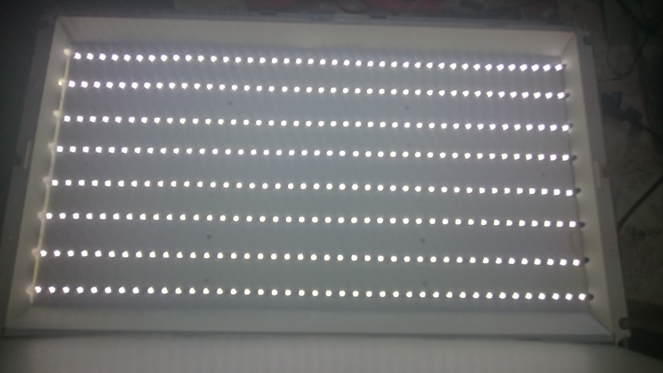

    I replaced CCFLs with pieces of LED strip on the same place as CCFLs - 8 rows of them, all connected in series just like if I didn't cut it at all.
    This is the end result.

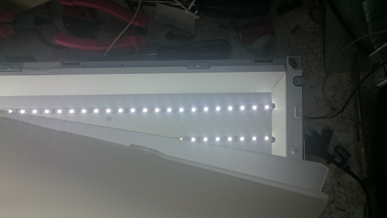

    With plastic sheets on top, there isn't too much difference when compared to CCFL. Maybe it's not as bright (but I don't have a reference as CCFLs wouldn't stay on), but it's quite good in reality.
    One more...

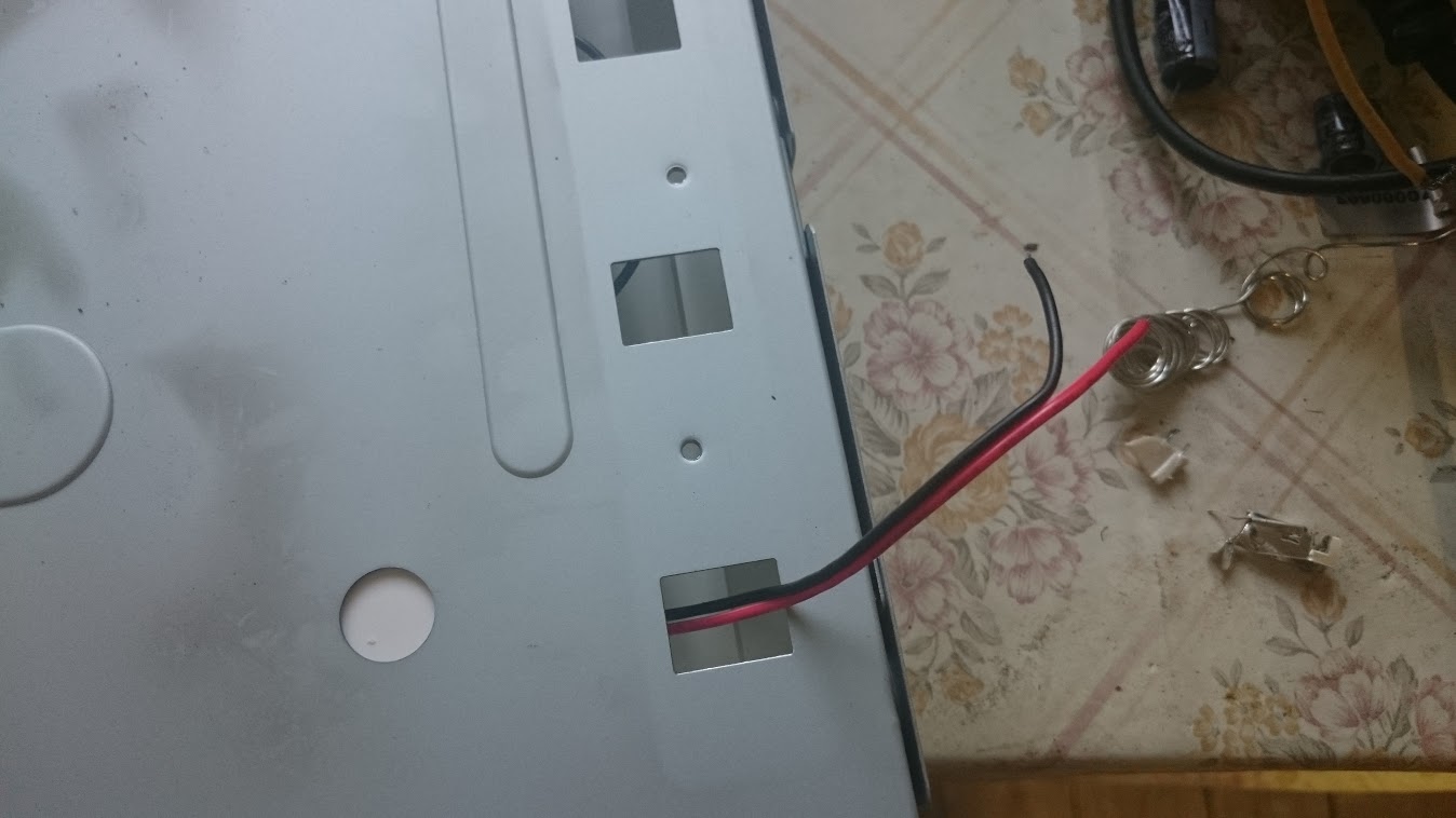

    I used existing CCFL holes for the power wires.

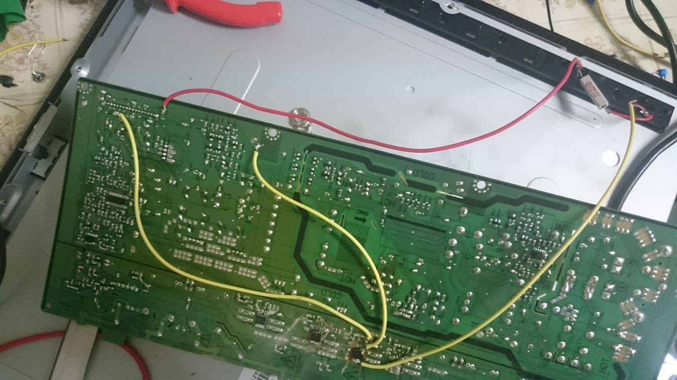

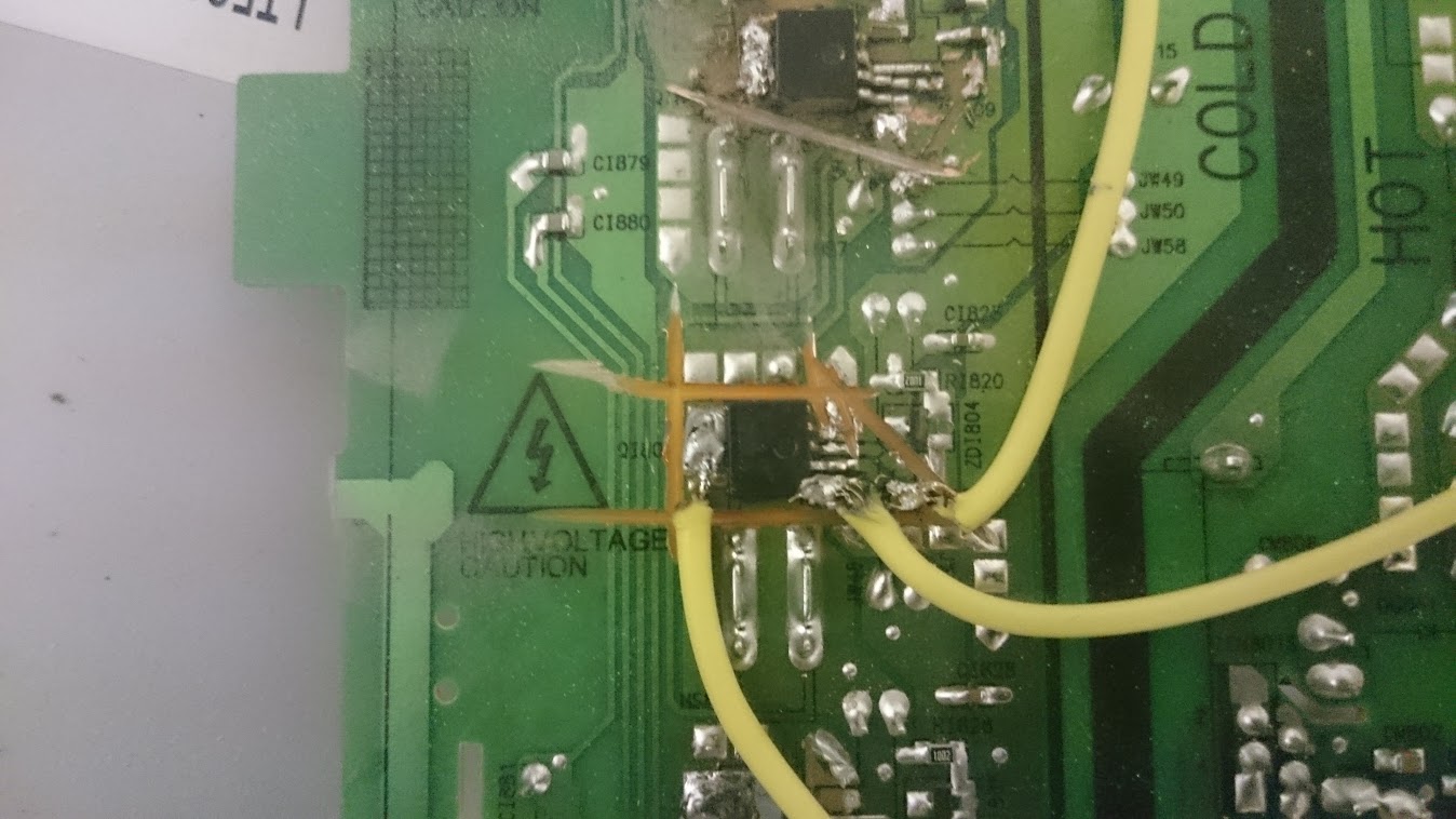

    Test run proved the concept, but what about turning the LEDs on and off?
    Well, it turned out to be very easy. I first removed HV transformers that used to power the tubes to avoid nasty surprises and used Dremel to cut the power to the entire CCFL HV section which is conveniently marked with a black line on the PCB.
    Then I reused one of the MOSFETs to toggle the power - mainboard pulls the INV_ONOFF line high when powering on the TV, that's connected to the gate and controls the MOSFET. LEDs get power from permanent 13V line that's powerful enough to drive them. Voltage is dropped under 12V with 10 ohm/5 watt resistor which drops it to about 9-10 volts.
    5 watts is too low and resistor quickly gets hot, but it's enough to prove that the entire thing works.
    Close-up of the MOSFET. I cut it from the rest of the circuit as I experienced some weird problems.
    Total cost: ~€20 for 6,5 meters of cool white LED strip and one high power resistor.

    So what is the Voltage drop on that resistor?
    What the Max current rating of the LED string?
    BTW, the 13V power supply is used for the Audio power amplifiers.
    The pictures looks OK and bright enough?
    As long as the TV is for your own use then it is no problem, different if it is customer's set.

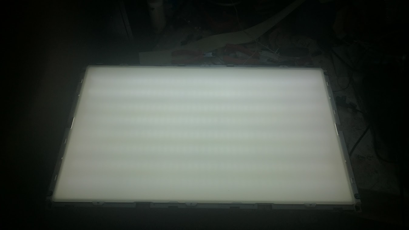

          Good work, have you a picture of what the image is like ?

              Yeah I bet there is going to be light bands and dim patches between the leds in the display. Should have used some ones out of Tv's they work fine.
                Re: Samsung CCFL to LED conversion
                Actually, you can see the bands on the screen shot here:

                        White patches are visible without LCD panel, but with TV turned on and black image, they're not visible.
                        Since I'm away from home right now and I didn't have time to replace the resistor and my ghetto hacked MOSFET started acting strange quickly, I didn't have time for some extensive tests, but I don't feel like it will be a problem. I'll definitely get back with results once I catch some time.

                            Like I said in my previous post, MOSFET started acting very strange, so that part of the board was hacked away too. Energy saving to the max!
                            In the end I used relay to toggle the LED backlight. It's triggered by power on voltage from mobo and it works perfectly. (It's been some time now, I don't remember where exactly I connected it.)
                            I also put 15 or 20W resistor (I don't remember which one), stuck it to the panel's metal frame and put some thermal paste. It can run for hours without any significant heating.
