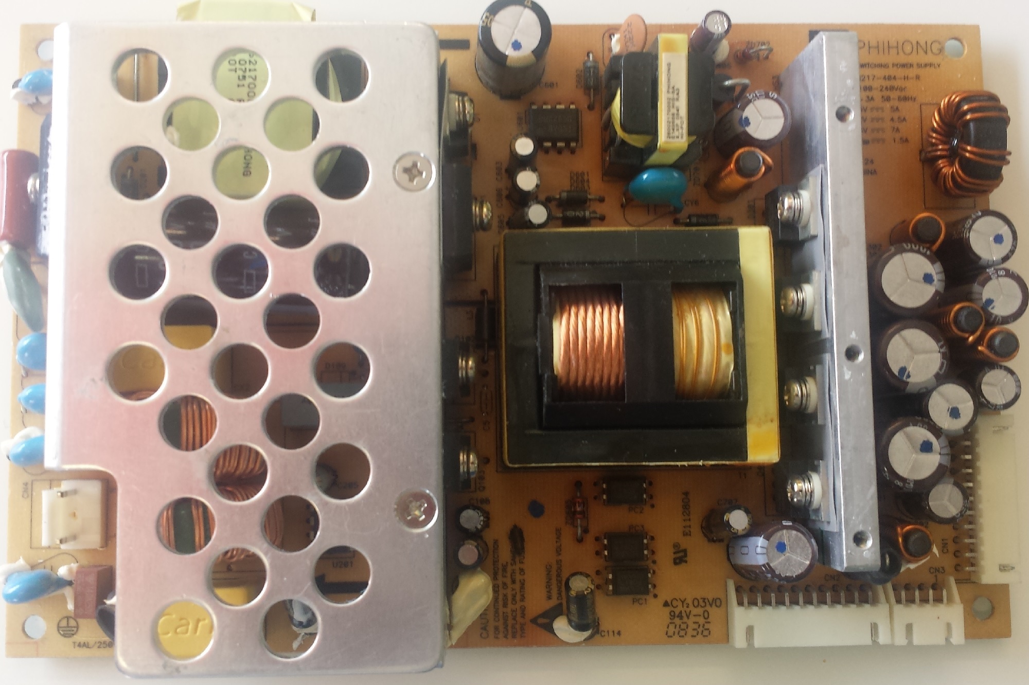

    Does anyone have the accurate pinout diagram & specs for the PSM217-404-H-R ?? I have two of these 281D and both ps are toast ... recap on one didnt resolve the issue. I am trying to find enough info to see if a PC ATX (20 or 24 pin) 400watt would have the ability to drive both of them through a breadboarded adapter.

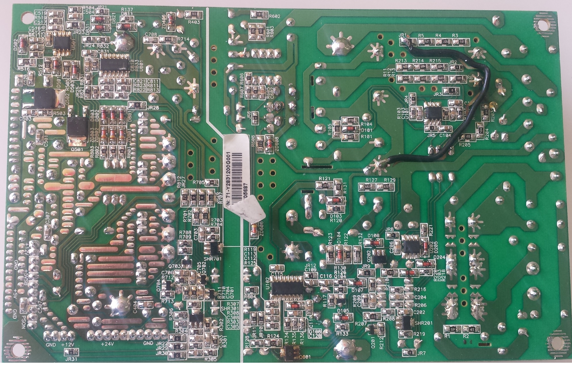

            show the original psu's and full part numbers.
            and upload the foto's here - dont use photofuckit or any other hosts.
            • JonnyDee
              • Dec 2013
              • 8
              Re: computer PS to power two HansG 281D ?? HELP PLEASE
              Thanks for suggestions: I guess repair is really the only option.

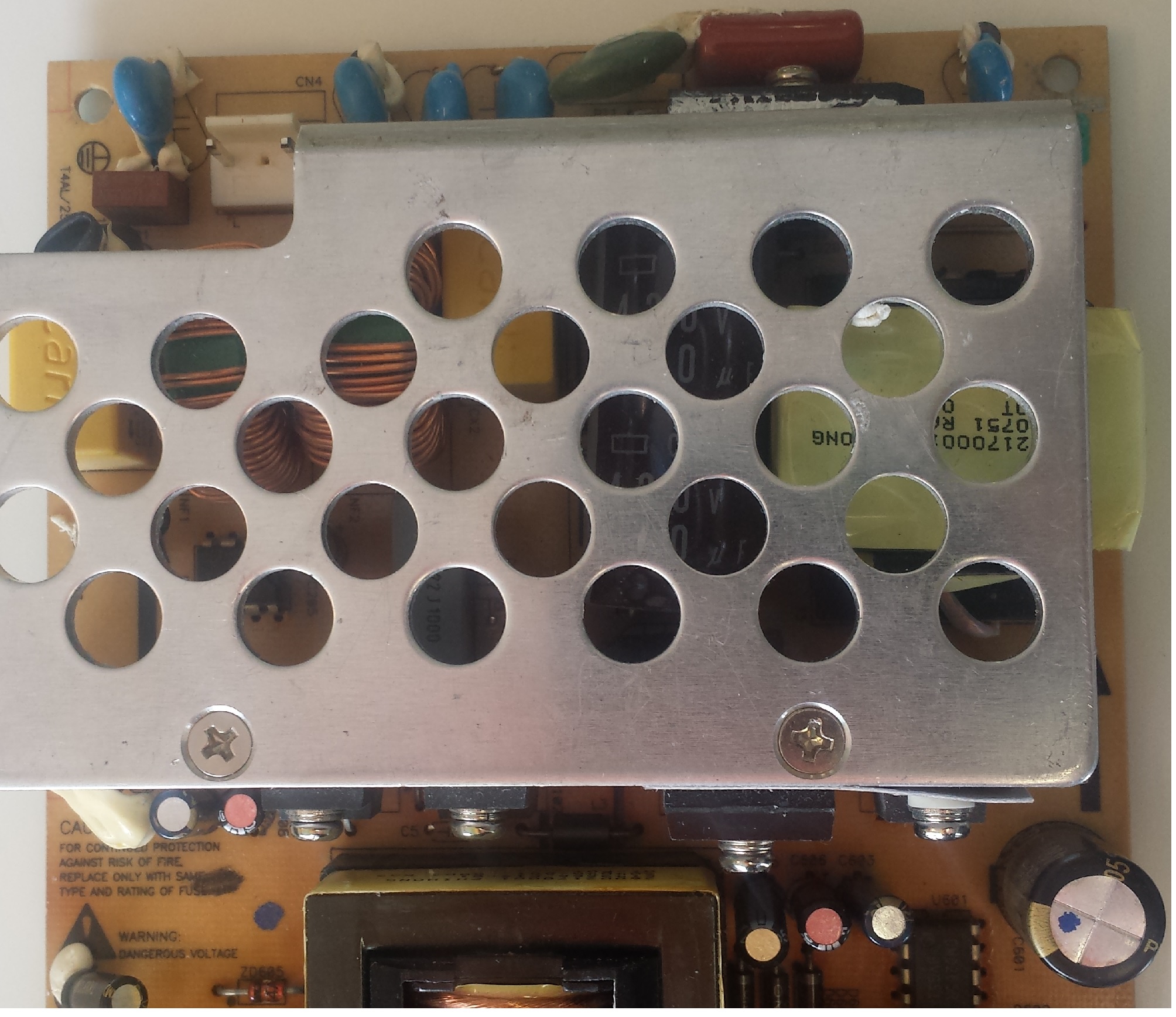

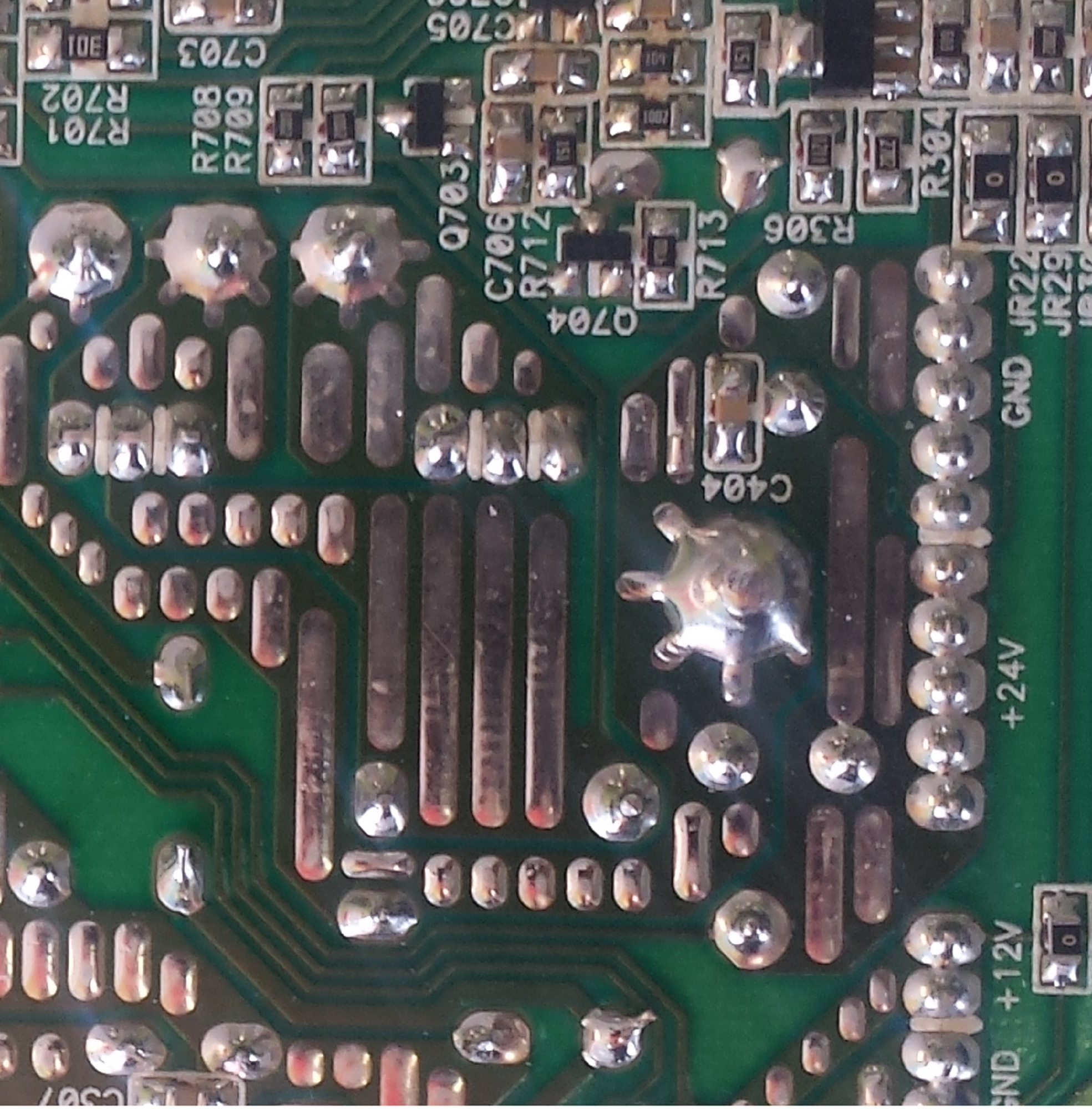

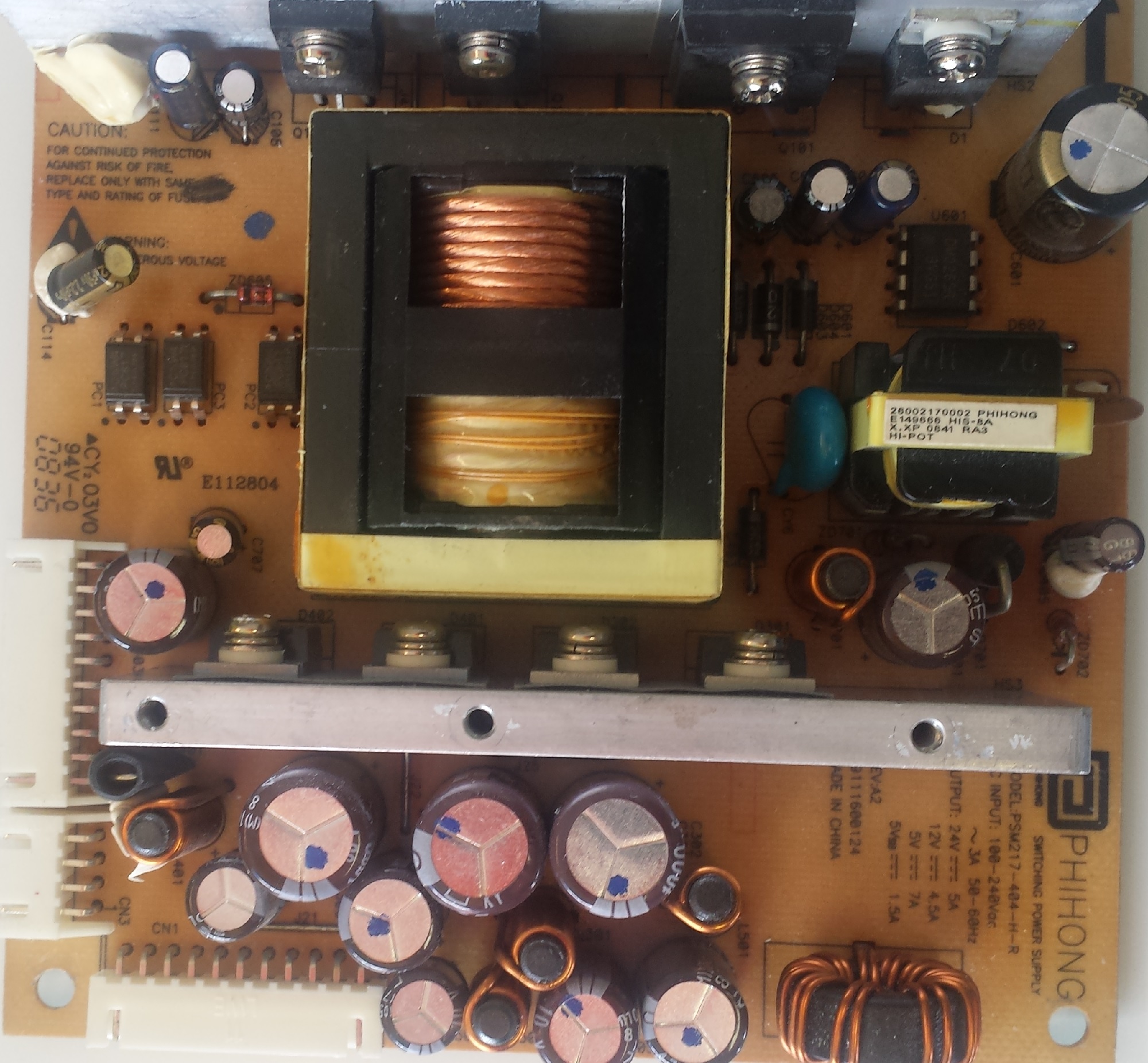

              I resized as per FAQ ... hope they stick correctly.
              This is the ps that had some cap replaced ... those caps are without the black dot markings on the top ... I can get the exact specs on the replacements installed if needed: basically same values but with higher temp ratings (all based on previous recommendations I have seen here on the forum) but as available as far as make
              pink on the images is (I think) thanks to lighting in the location they were taken .. if they arent clear enough I will try to get outdoor pix taken.

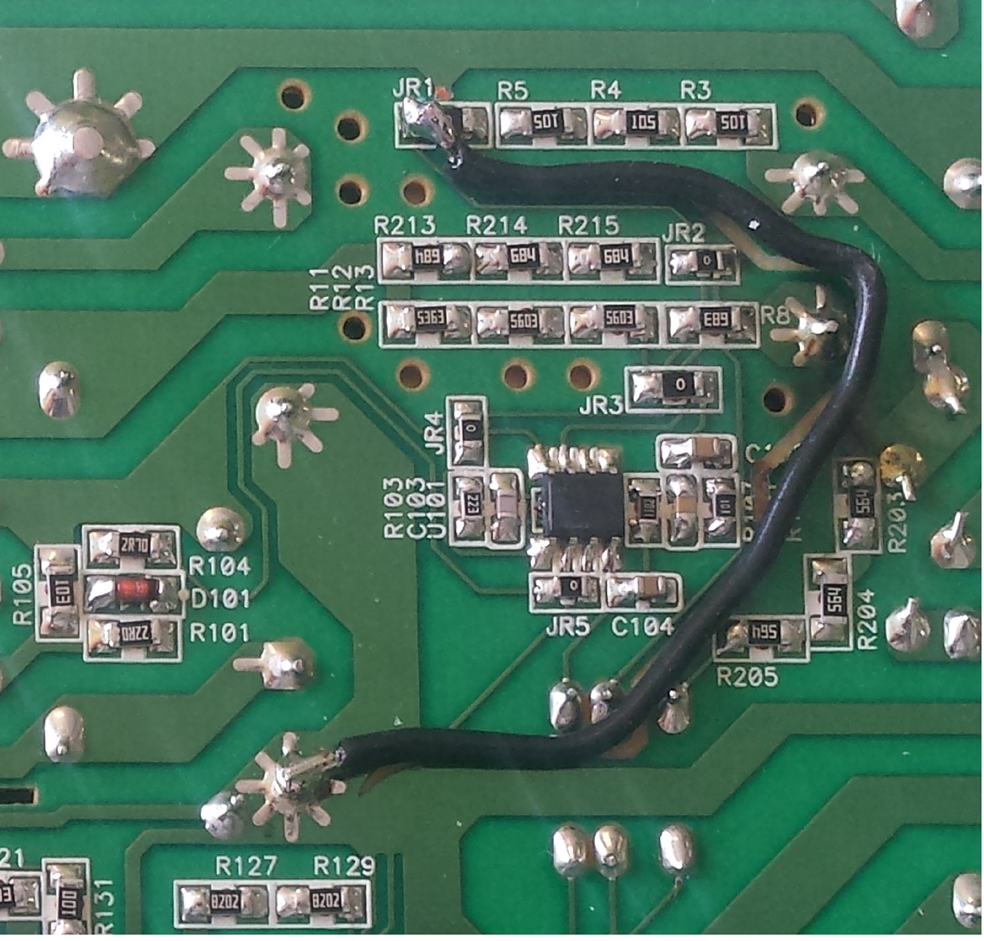

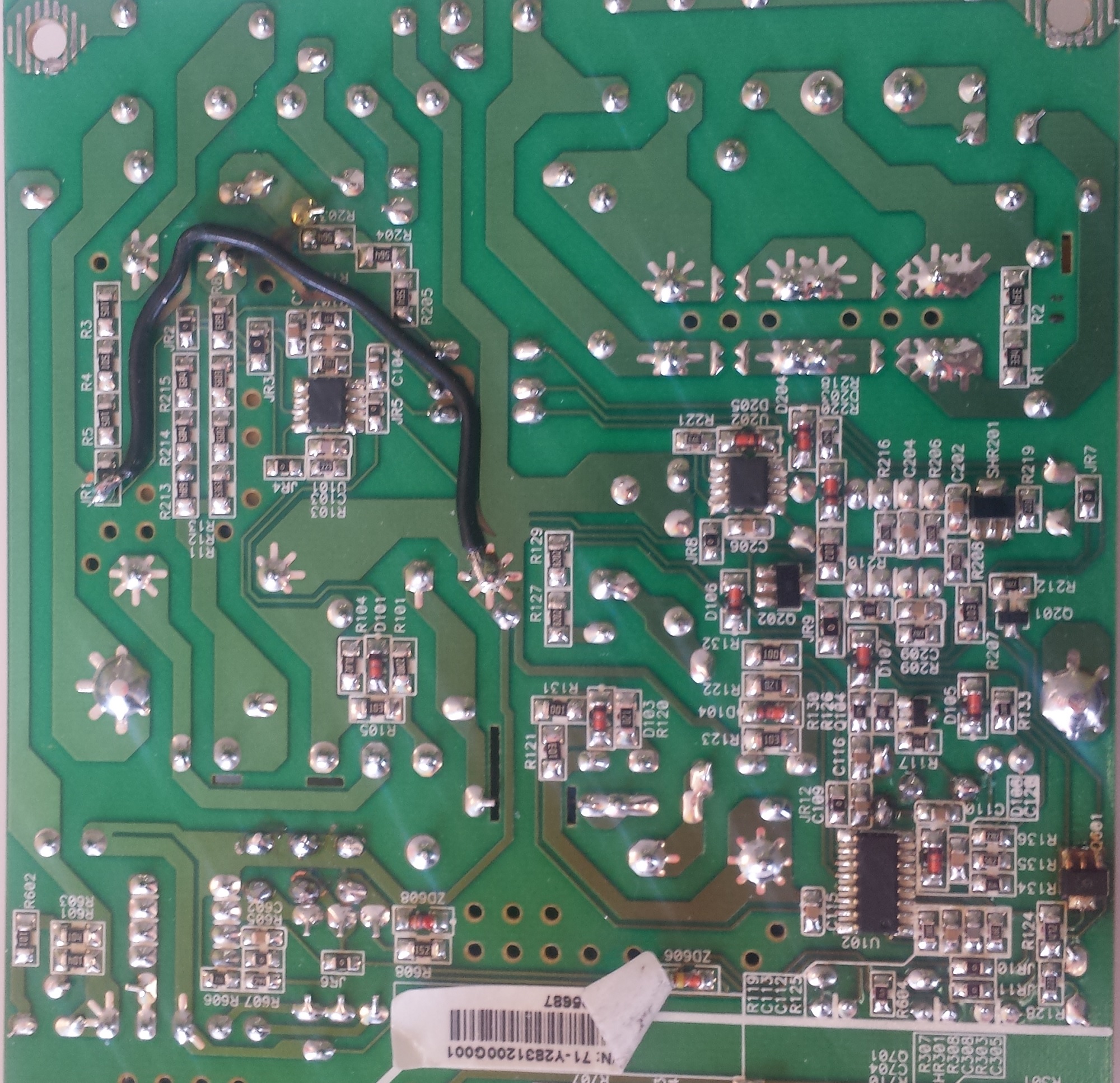

              There was a trace lifted on the bottom .. this was after I retrieved ps from first store that tried to fix it (they lost the heat sink removeable plate as well), but I didnt have a pix to show that they had damaged it so I had no recourse.
              The tech that replaced the caps insisted that it was better to wire a connection following the same path rather than try to replace the trace itself.
              this is a rev A2
              Looking forward to recommendations
                • 31159
                there is more there than meets the eye.
                thre is a thin track going under that jump wire - i wonder if it's also ripped.
                what kind of a bastard rips a track and calles themselves a "profesional" anyway!
                not to mention, it looks like some of those caps may be panasonic NHG series (silver on black)
                those arent suitable for a psu, only low esr like FC or FR series.
