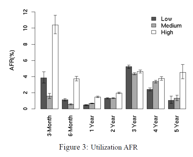

                                  My first advice would be to invest some money in a quality hard drive.
                                  Buy a new NAS or Enterprise hard drive, put it in a machine and leave it running 24/7. After about 3 months, you can start using it and trust that the chances of the drive failing are minimal.
                                  My current preference is HGST Deskstar NAS
                                  You mentioned a 320 GB drive, which I guess would be rather old - studies like the Google one show that a drive is more susceptible to die in the first few months or after about 3 years of continuous operation :

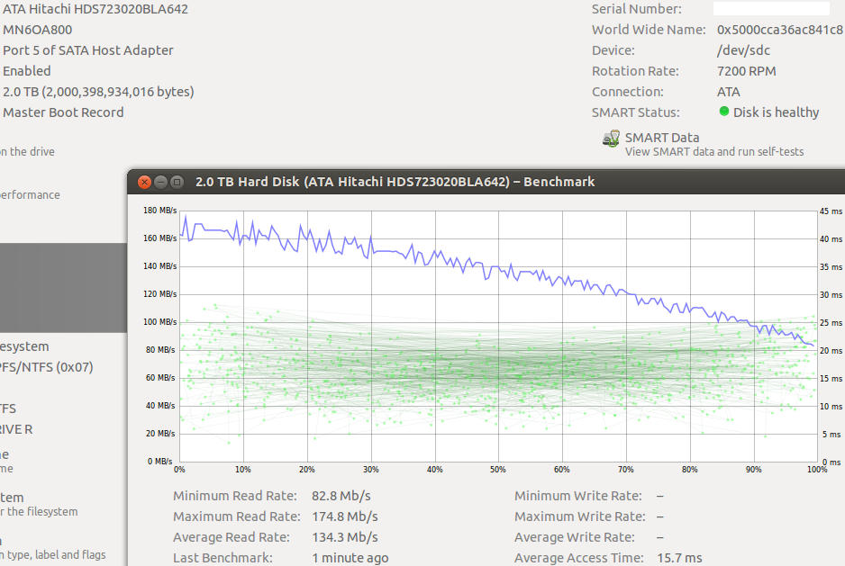

                                      yupp, the best 2tb legacy format (512 byte sector) hitachi drive u can get is the 7k3000 2tb hds723020bla642 drive. take a look at the sustained transfer rate benchmark from mine. faster than even the wd caviar black 2tb or re4 2tb.
