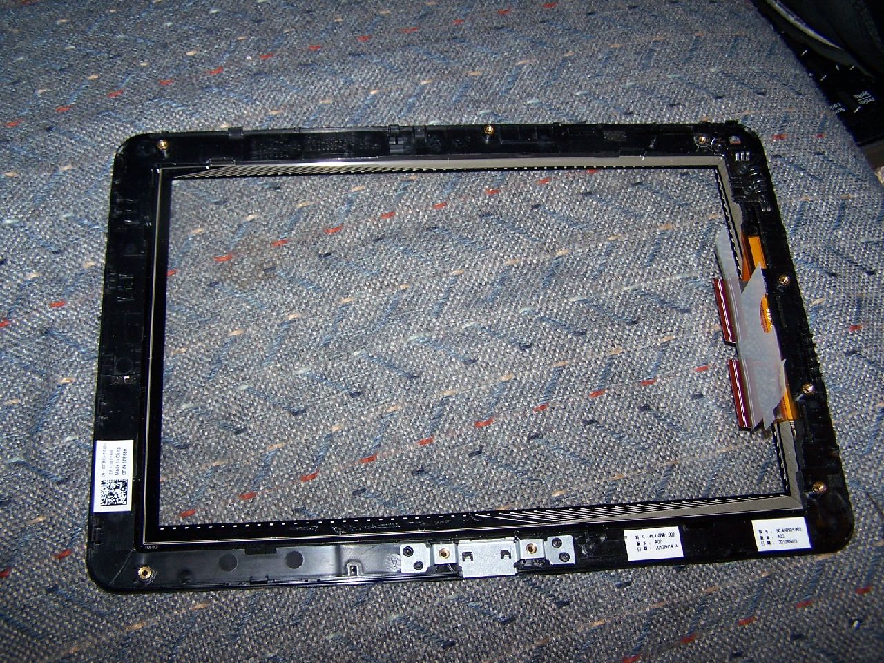

                  Yay, all that was holding the screen was a little digitizer tape.
                  I'll order a screen then... $45 later ($10 shipping) and it's on order.
                  Some pics:
                  The bare naked digitizer + frame:

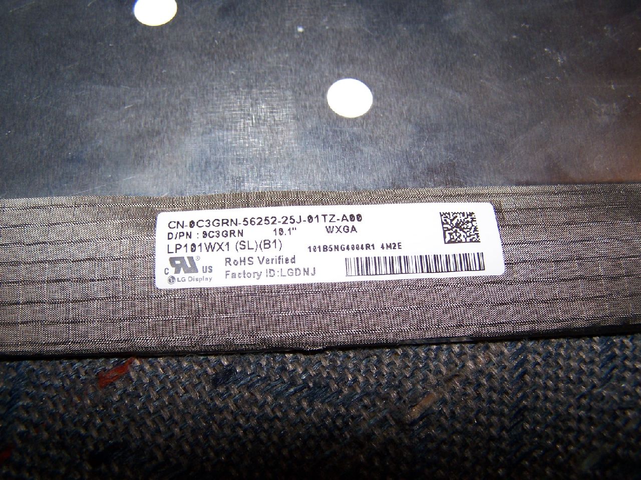

                  It's made from gorilla glass IIRC... I flexed it a bit while levering out the screen (without a hair dryer, I'm brave, lazy, and/or dumb) and it didn't crack. Also, the digitizer traces are intact... if anything does show in the picture, that's tape residue.
                  LED panel info:
                  IIRC this panel is model-specific, as the LVDS also carries the data lines for the digitizer. I did pop off the digitizer control board/cable just in case the new panel doesn't include them. Shame, LG IIRC makes good panels (although this may have been a freak failure).

                        Well... the screen came in, and it's a turd. What they did was they took a similar panel, and hacked in an adapter cable. Ok, sure... but guess what? No place to hook the digitizer controller!
                        I'm sure it's compatible video wise... but since the digitizer board attaches to the panel and connects to a special connector, I'd have no touchscreen.
                        I'll re-check the listing, but IIRC it says 100% compatible. I'll be asking for a refund, as this isn't. Edit- between a 20% restocking fee, the fact I had to cut the foil tape looking for the connector, and the return shipping, I'm fucked.
