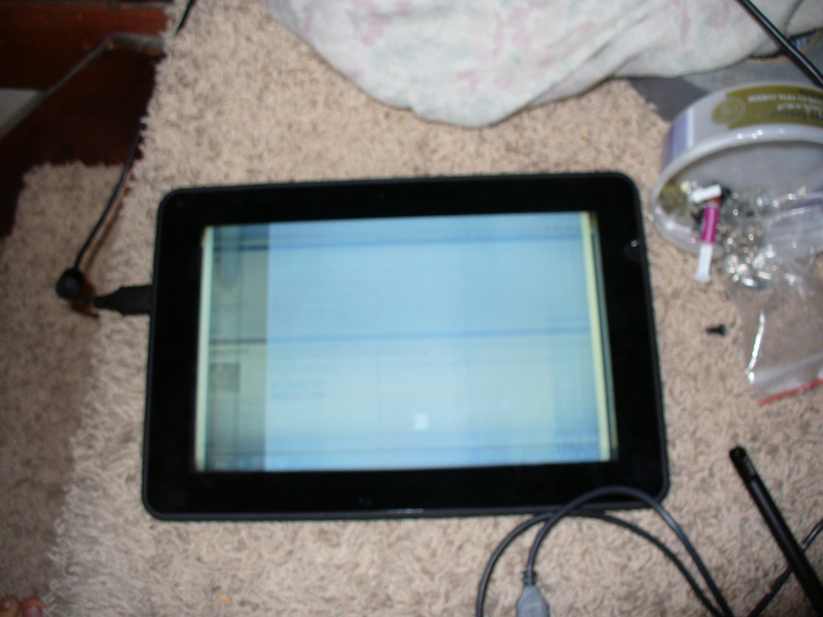

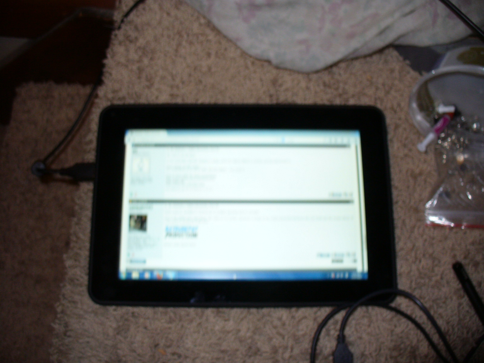

                    Got pics. Gotta run, so I'll just attach them and explain them later. It will "work" or "not work" depending on how I tilt the tablet, which does seem like a physical connection issue. Suggestions?

                      Made a Diagnosis... LVDS cable. I took a look at the hot bar connections to the LCD driver, which looked fine. ... then, while messing with it, find that it's contact with a particular part of the back cover causes the glitch to happen and stop. Hmm... pull the "logo cover" and sure enough, the mobo side of the LVDS cable is in the vincinty. I power it up w/o the cover, and I can make it fail/work just by pressing said connection. Since it's done this on two different motherboards, I say it's safe to call it a cable fault.
                      Whew... beats having to get a new panel edit- $15 for a used cable... sorta pricey but still not bad.

                          Ok, I've messed with it some more and now I'm only 60% sure it's the LVDS cable. It also seems like messing with the driver board's edge has an effect, which would point to bad LCD tabs, which in turn would mean bad LCD.
                          All I can do here is try the cable and pray that fixes it... if not, then IDK. An new LED screen (not sure if my stock screen is LED as well?) is $45; a used screen+digitizer is $40+
                          Insert "the cheese is never free" joke here... it's otherwise a nice (but somewhat anemic) tablet.
                          edit- I'm a noob. Since it's mostly all-over the screen, it's safe to say it's a TCON issue of some sort... still hope it's the cable.
