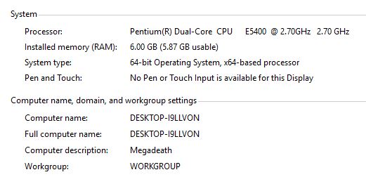

          Just did. Working. Don't know if it is worth spending more on this old system. It is used for browsing only.

                Nice to know. I bought a hynix 4 GB ddr3. Now this will be good for few more years
