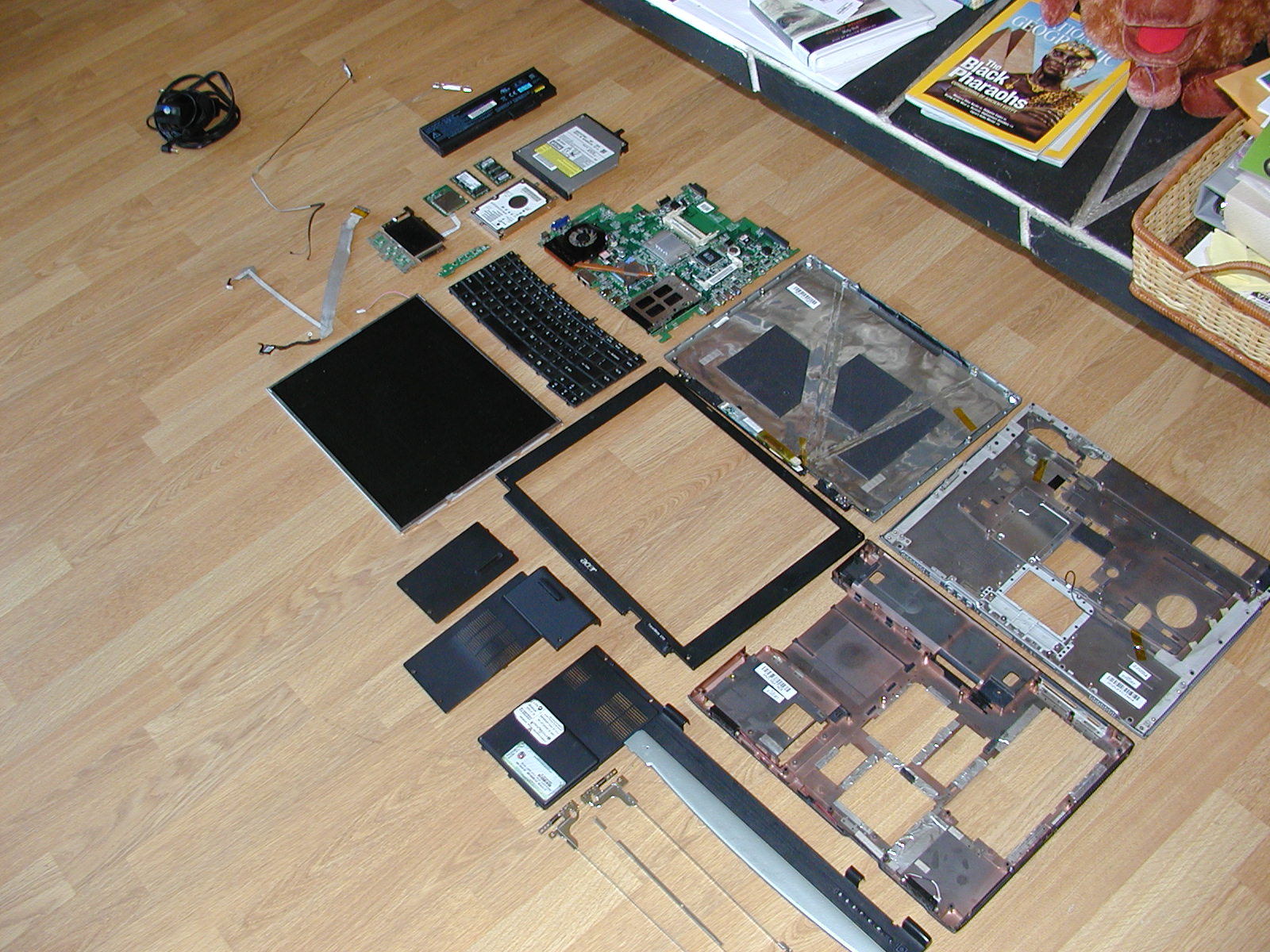

    The build your own laptop kit.
    It finally arrived!
    I got an ACER laptop with bluetooth, wi-fi, maxed ram and a bunch of goodies and no warranty (for reasons you will see below).
    Now comes the fun part. Putting it all together!
    Gee, I wonder where that bag of screws went? I hope they made it into the shipping box.
    Find Nedry!
    Check the Vending machines!!
    <----Computer says I need more beer.

      looks nice, good luck with that
      how come its all in bits

        Probably because someone took it apart and couldnt figure out how it goes back together.... I had to change a motherboard in a Dell Inspiron 5100 I had, and that was a pain in the ass..... It took over an hour just to put it back together.

            Well my friend had this laptop suddenly act up on him and since he didn't know how to fix it he decided to take it apart.
            I don't know what he is up to but he somehow wants to hook the LCD screen and the trackpad up to a spare t-shirt and make some crazy shirt and he insists it will work when I know that it obviously won't.
            So all it cost me was a spare DVD drive and a USB to IDE adapter.
            Also, it turns out he left the screws at his house.
              symptoms?

                His linux kernel was always panicking as soon as the system warmed up.
                Something is loose.

                  or the heatsink is packed up with crap like a dryer's lint trap.
                  had 5 toshiba's i bought cheap.
                  all from the same family and likely the same longhaired cat clogged all of them.
                  the way they are built you have to tear it down completely to clean it.

                      This is an Acer Travelmate based on so-called Folio platform: it was first Acer attempt in doing less thick notebooks, it lasted form early 2005 to late 2007 until Gemstone arrived. It's worth saying most Folio-based NBs suffer from overheat; moreover your seems emploing a Sis chipset and no discrete graphic chip, so it's a budget one: just tell me its cpu is a Turion, so I can tell you it is doomed ...
                      Anyway, you can find its service manual somewhere with a bit of googling; if you can't find it, then look for the Aspire 5670 one: this one is [unfortunately] my portable, a "relative" of yours, and I'm quite experienced because I opened it three times following instructions in its manual.
                      Before reassembling it, check the termal compound between cpu and heatsink: if it's a low quality one or (worse) a pad, clean it and put some silver oxide paste; then check its ram with memtest86+. If both cpu and ram aren't defective, then chances are the board is defective or [more likely] an onboard integrate is going mad due to overheating: you can try colding a component for a few minutes unless you find the culprit. You can cold with an instant ice medical package or a reusable one (usually filled with a blue gel): put a plastic bag on the chip to avoid condensation or short circuits.

                        Too late.
                        I had the thing reassembled within half an hour of getting the screws.
                        I'm planning on loading Windows 2000 onto a 10GB partition and leave the other 30GB on the drive for Ubuntu. I tried Solaris 10 this morning and it didn't like the trackpad and I was forced to use a USB mouse.
