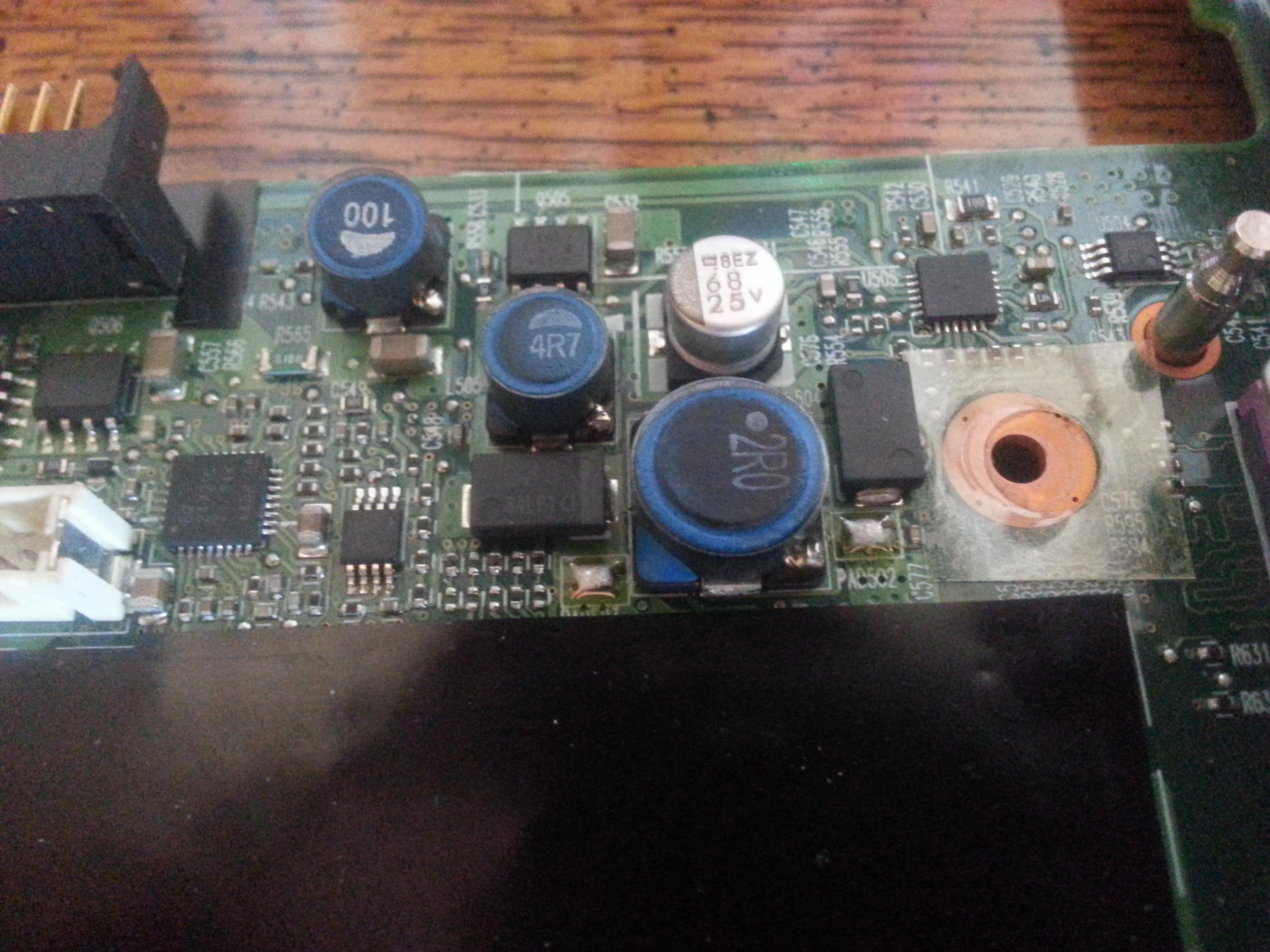

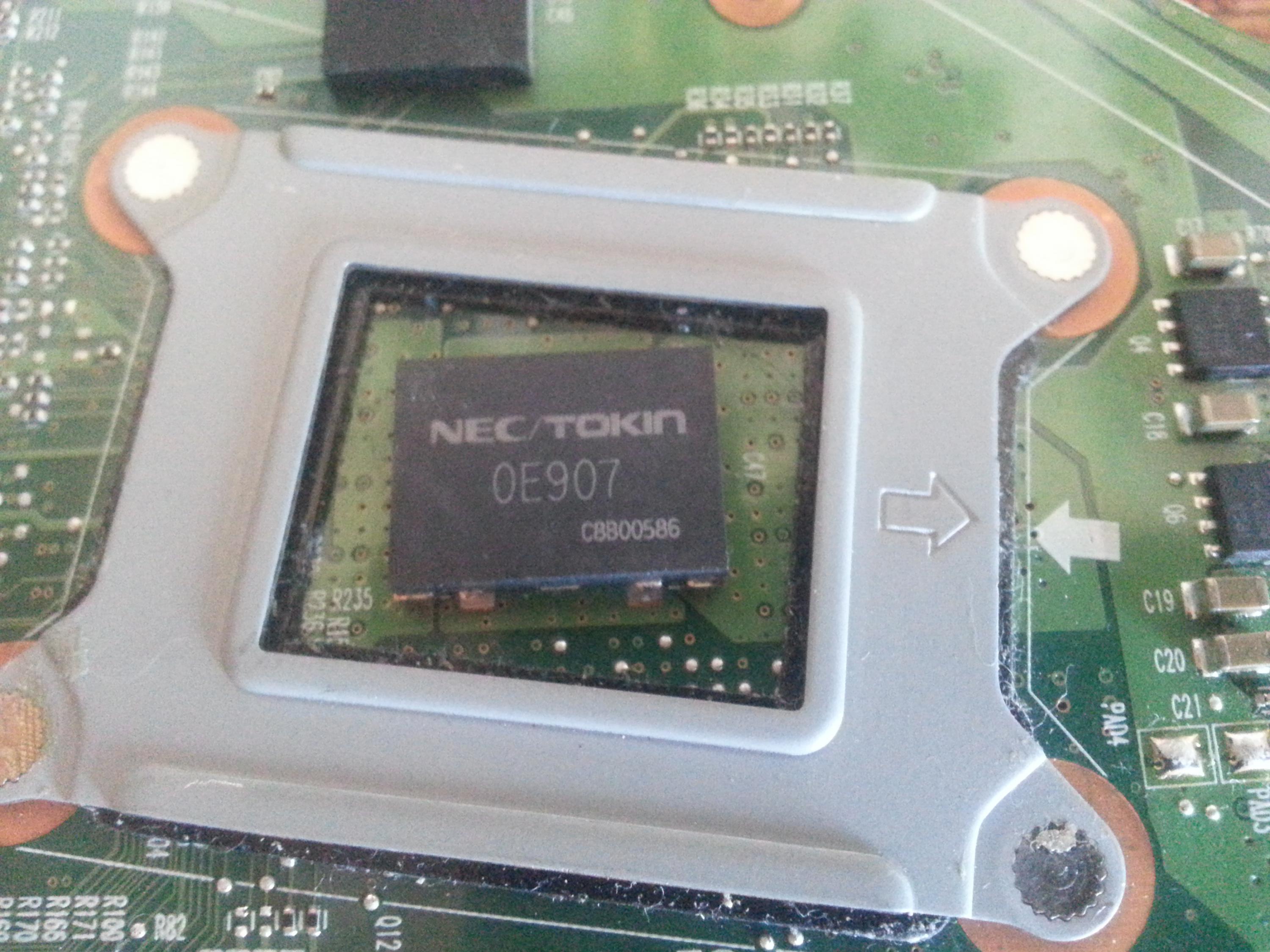

            Sorry for the delay getting back....had the time to tear it down yesterday.
            Un1qu3's crystal ball seems to be correct! Thanks for that.
            It is an Acer 6920. It has the 0E907 under the CPU.
            I attached some photos.
            I have never done any type of repair like this, but I have a friend who thinks he can help.
            I have read through some posts, and seen some videos....
            Some say use a heat gun to remove the 0E907...some say use pliers to yank it off.
            If the heat gun is used, do I have to protect components around it? Will other things be melted?
            We only have a heat gun and soldering iron...no IR or BGA station or anything like that.
            If someone has a link to correct instructions, and what replacement caps I should be buying considering our equipment, that would be fantastic.
            I saw several SMD 330uf 2.5v tantalum on ebay...will any work? or specific brand/size/design?
            Thanks!

              Re: HELP! Strangest HW problem I have seen since the 8-Bit days.
              Ahh, a 6920. Done a couple of those as well. That one will require six 330uF capacitors so you have to be clever with placement. Or you can use four 470uF.
              Do not use the heat gun on it, you may damage the CPU socket. You will just need a wide chisel tip for your iron, to be able to heat a large area at once so you can successfully solder the new caps in.
              To get the Tokin off, use a pair of pliers to crack it, then take a sharp blade and peel it off the board in layers. It is fairly easy to do, just take your time and do it carefully, you don't want the blade slipping and taking other parts off the board. After you get all the remains of the Tokin off, scrape away some more of the solder mask to make room for the new caps. Just make sure you check the polarity before you start soldering.
              If you need any more assistance please let me know.
                  Thanks for the great info....I just love this laptop and want to keep it in service...beautiful 1080p screen, blu-ray, fingerprint, great sound...
                  I am curious as to why the Acer needs 6 caps instead of 4? I saw many "kits" on ebay to replace NEC/Tokin and they all had 4x330uf. I am not questioning your accuracy....this is all new to me and a learning process.
                  example: http://www.ebay.com/itm/4x-SMD-Tanta...-/330953629462
                  Also, are there any other criteria for the 470uf? I just did a search on eBay for "470uf" and there are a bunch...most are the round variant with 2 leads sticking out.
                  Thanks!
                          So far so good. Just waiting for the SMD's to arrive.
                          I successfully removed the old Tokin chip from the 6920 with pliers and blade.
                          There are 4 sliver colored strips remaining where it used to be. I have noticed that in some strips, it has dullish grey color, and other places it is shiny silver. Did I dig too far with the blade to produce the shiny silver or should it all be like that?
                          Also, when I solder the new caps, do I have to ensure that the solder does not touch between the 2 caps on each side or it does not matter?
                          Thanks again for everyones help! I thought I was never going to be able to fix this thing.

                              Search for "proadlizer" to understand its structure. The two + strips and the - rectangular belly plate can be removed by lifting an edge with a sharp tool then peeling it off.
                              Do not use a soldering iron or do any messy scratching at this stage.
                              Look at these threads to get a better idea.
                              https://www.badcaps.net/forum/showthread.php?t=46821
                              https://www.badcaps.net/forum/showth...highlight=a200
                              You must not cause any short circuits when fitting the new capacitors.
