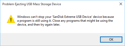

            Re: Change old low HDD to a CF card?
            Originally posted by trodas
            However, now to bad news. The CF card is completely useless, unless someone tell me how to change the removable bit to fixed. Period. You cannot use the CF card for anything w/o that.
            I'm quite mad at SanDisk - they should rename themselves as ScamDisk, because they are selling not CF cards, but CF compatible *) cards, with the *) exception for the possibility to change removable to fixed bit. I believe, that there is open possibility to lawsuit against SanDisk and any other CF card producing company, that produces products, that does not meet the CF card specifications. Because this is false advertising and misleading labeling of product. This is not a CF card, period.

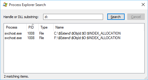

            This is quite interesting because I realized something about a Sandisk Extreme USB 3.0 16GB stick I have.
            I bought it two years ago I think when Sandisk had the interesting idea of selling their USB sticks not as removable devices but as fixed disk devices.
            The problem with this is that even with the device set to "quick removal" in device manager in 9/10 cases you will get a Windows warning when trying to do a safe removal:
            And I have even enabled "Do not allow locations on removable drives to be added to libraries" in the local group policy under Computer Configuration -> Administrative Templates -> Windows Components -> Search
            But of course that only applies to removable devices and not fixed devices!
            So of course Windows manages to make the safe removal impossible:
