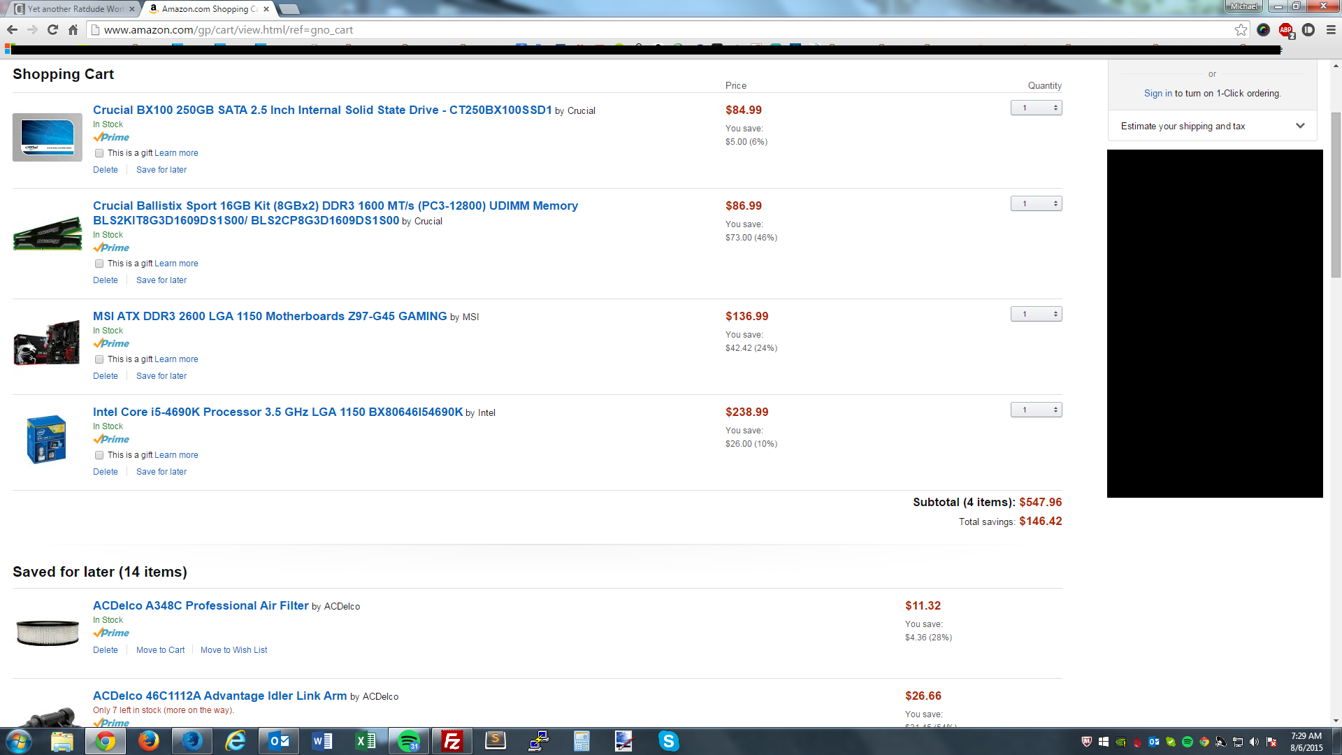

                                    • shovenose
                                      Send Doge Memes
                                      • Aug 2010
                                      • 6575
                                      Re: Yet another Ratdude Workstation Build?
                                      So an SSD is okay (hey, they are modern consumable throwaway society junk, right?) but a Core i5 is not?
                                      Check Amazon screenshot. You don't need to spend the big bucks to have a nice system. Pick a nice case (plenty under $100 that are very good, or reuse one of those massive things you have), use some power supply and dvd drive you already, problem solved...
                                      You wouldn't need a computer in the next few years, would save a lot in power, reclaim many square feet of space, and not have to "tinker" to make your computer work. Oh, and it would be faster. No RAID arrays, no bizarre incompatibilities, no BS.
