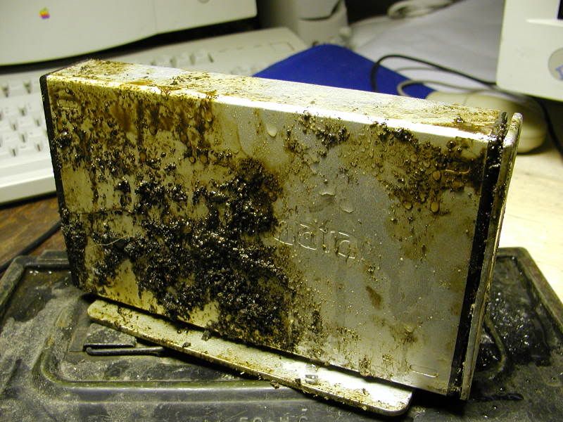

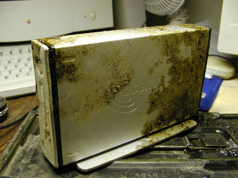

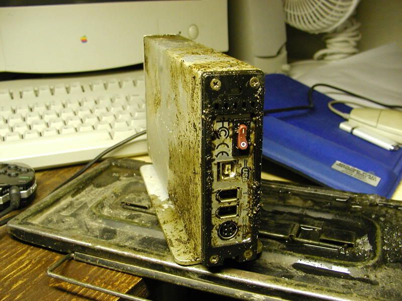

    I have this 160Gb external hard drive and I take it with me when I go gaming at a friends house.
    The other day I was at my friends house and when I had to leave I must of dropped the thing and I didn't hear it. His property is mostly a massive farmyard and the ground is a nasty mess of mud, piss and crap.
    This afternoon he calls me and says that I left my drive at his house. I go over there and when he gives me a plastic bag I see this:
    I was about to blow chunks right there in his face.
    He said it was found when his dad was ploughing the driveway and by then it had been tumbled a few times and dragged through...I don't even want to know.

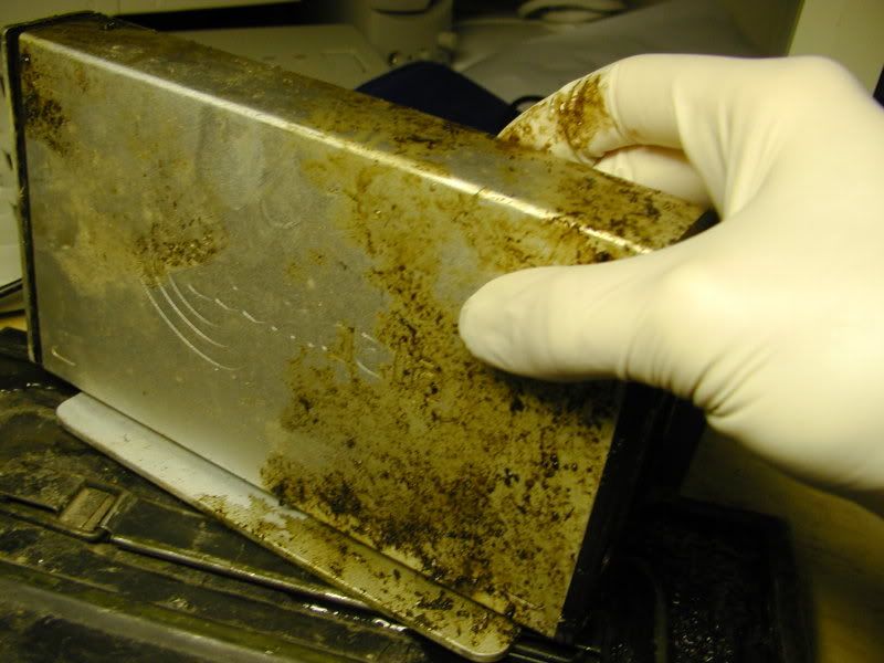

    I got the thing home and after putting on a latex glove I proceeded to put it in the toilet and clean it off.
    It took a while but a few flushes and a hot rinse later it was relatively clean and to my luck the drive had only a skidmark on it.
    I'm going to wait a few days and put it in the dehydrator so I can get any water out of it before I even try to test it and see if I lost anything.
    I don't think anyone can top this one.

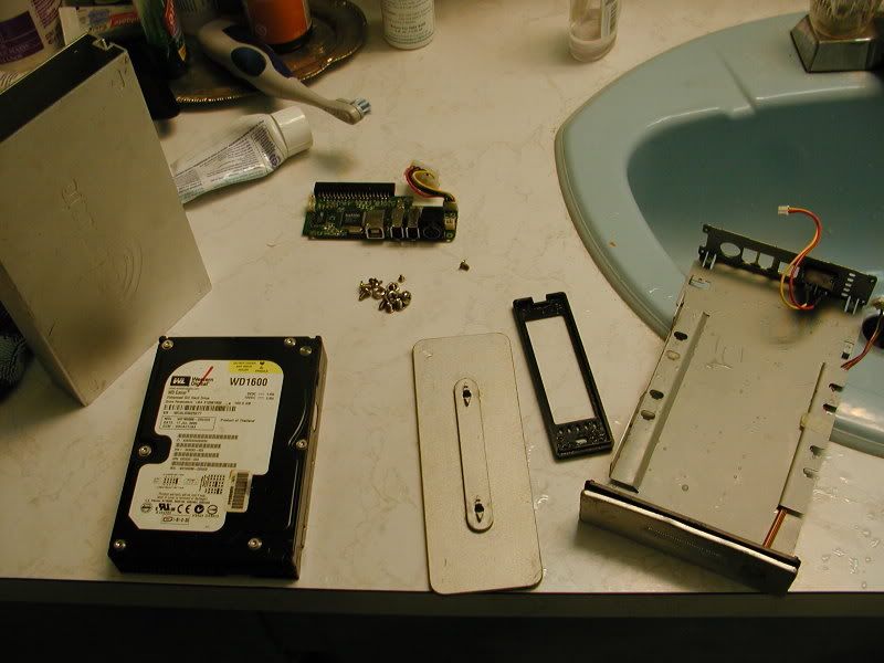

    Disassemble the whole thing and clean it with isoproply alcohol.
    Flush the pcb on the drive with it. (Pcb in the box too.)
    Don't get any in the vent hole on top of the drive.
    Isopropyl absorbs water carries it away when it evaporates.
    Leaves no residue.

      Make sure you get between the drive's PCB and the drive's body when you flush it.

              A bit of TLC really cleaned it up.
              I'm going to let the drive dry out before I test it again.

                Leave it apart to dry.
                You're gonna trap moisture in the case.
