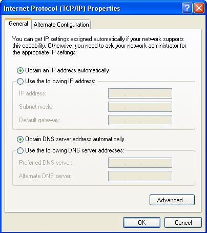

      if you use a fixed IP you would need to set the Internet gateway address as "default gateway"
      (as in the modem or computer with the modem. IP address)
      Graphic as an example ,from Win XP
