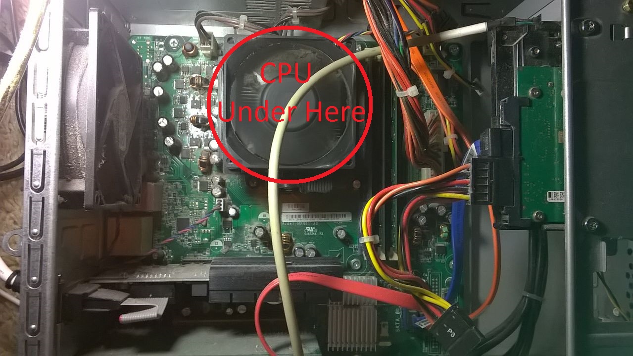

Dell inspiron 531 fans constantly blowing hard

    Well, after, (thinking) that the previous problem with this computer may have been fixed. something new occurred today. As soon as I powered on the computer, the fan i inside began running and blowing very loudly, constantly. Though, when I sign into account, it doesn't take as long as before. I still have SMART enabled in BIOS. but the fan, even right now, is constantly blowing loudly.
    Please help.

    The heatsink/fan hasn't been knocked has it ?
    Download speedfan from here http://www.almico.com/speedfan.php run it and see what temperature the cpu is.

      Re: Dell inspiron 531 fans constantly blowing hard
      heatsink clogged by dust? it might be blowing loudly but is the air coming out fast or slow, and how hot is it?
        Its very hot, I keep smelling something like something's burning.
          if this is the one running slow in the other thread, then we already pointed out that the cpu heatsink is clogged wih dust and the whole machine really needs to be cleaned out.
            My master already cleaned out the computer yesterday, and this happens.
              • 31044
              post a fresh foto of the cpu area.
              either he missed it, or he messed up the fitting of the heatsink somehow.
                      So its the fan that is broken now? Is it safe to keep running it? Even though I see no problem so far.
                        • 31044
                        we didnt say that, we are speculating.
                        open the case and with the power off, make sure the cpu fan looks normal,
                        then power it up and make sure it spins o.k.
                        and take some more foto's
                        it could just be something stupid like it not being put back properly after cleaning.
                          I have the case opened, but I have no idea what the cpu looks like. I don't see anything spinning, but I could be looking in the wrong place, or not hard enough.
                            You are looking for the CPU fan. The CPU itself is hidden by the fan and heatsink (or radiator).
                            If it spins normally and isn't clogged with dust, then it should be OK.
                            As has been suggested earlier, though, you really should install SpeedFan and check the temperatures. That will tell us if it is a problem with the fan or if it is overheating
