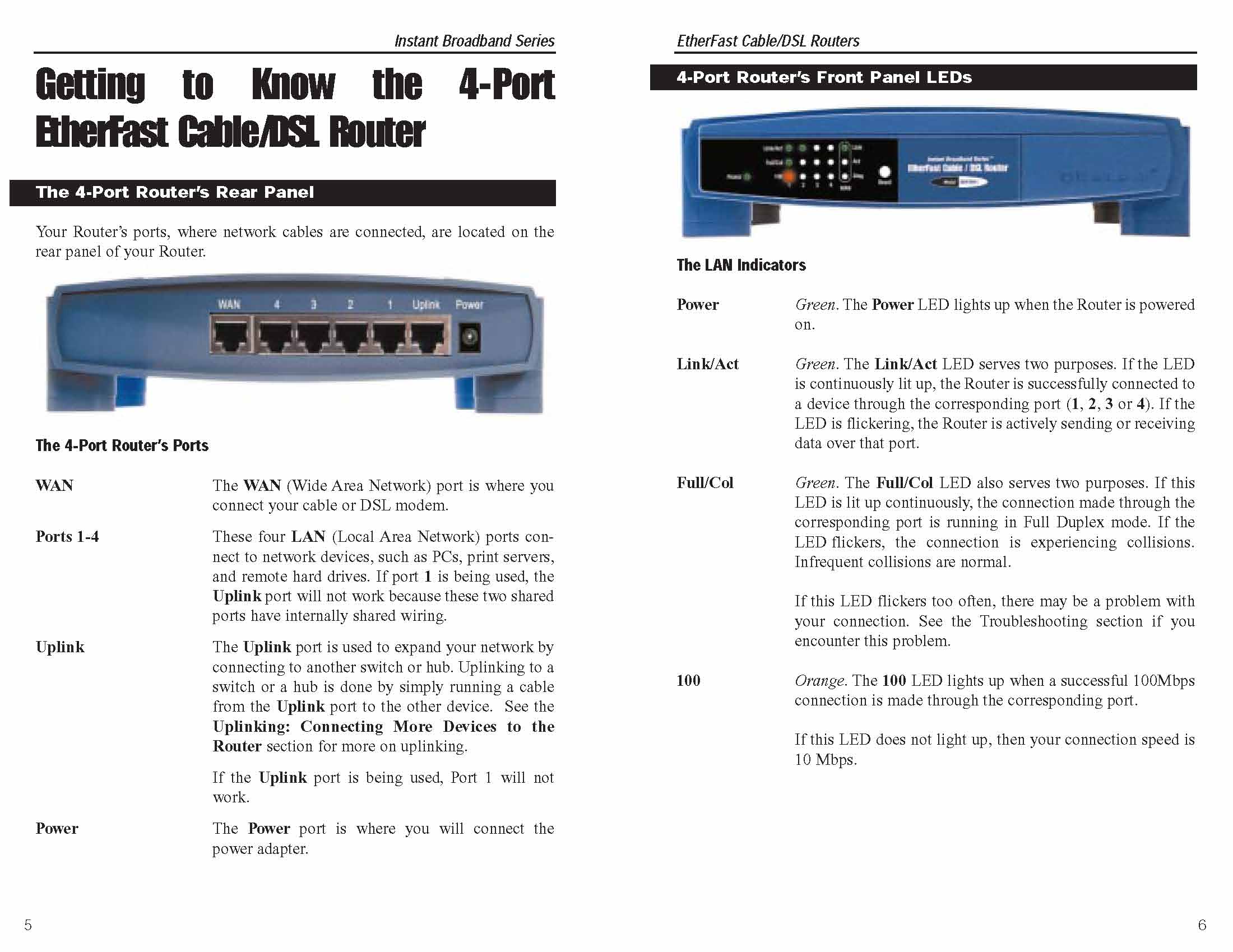

    I have a Linksys BESFR41 v.2 router that is apparently throttling my hardwire broadband. What is the fastest throughput I can expect from this router? I have read where it will throughput 6 Mps. I looked at the settings by putting the IP address in the browser. The settings look ancient, and I didn't see anything I could tweak. Okay, alternatively, I could use a Linksys WRT54GS or WRT54GS v2.1, or ubee DDW3610 dual stream n. I have a stupid question. I only use a wired connection, and the latter three routers are wireless. Will these routers broadcast a wired connection? How do I make sure they are not broadcasting a wired connection? As long as these wireless routers are powered, are they not broadcasting, and therefore do I need to encrypt the signal, even if I am using only the wired connection?

          Lynksys says the BESFR41 is a Cable/DSL router with 4 port switch.

              Re: Help with basic router config
              @Steve:
              read the manual - it has 5 10/100 ports and needs an external modem.
                    You said:
                    "the BEFSR41 is just a hub"
                    It is not a hub. It is a wired router and switch with a WAN port and 4 LAN ports.
                    Originally posted by stj
                    @Steve:
                    You read it. It is not a modem and it has no wireless. That doesn't make a hub. It is still a router and switch.
                    http://support.linksys.com/en-us/sup...outers/BEFSR41
                      • 31094
                      it's a 5 port hub with a shitty firewall.
                          "the BEFSR41 is just a hub," Really? I must be using it all wrong then.
                          http://kb.linksys.com/Linksys/ukp.as...a1b_20875.xml&
                          I have one myself.
                          From Linksys:
                          " What is the BEFSR41?
                          The BEFSR41 is a Linksys EtherFast Cable/DSL Router with 4-Port Switch. The Router lets you access the Internet through its four switched ports. The device also contains security features including, a Stateful Packet Inspection (SPI) firewall and NAT technology."
                          This is reminding me of the Greek.
                            • 31094
                            sales hype aside,
                            if it does not have an ADSL/VDSL or DOCSIS port then it's just a relativly intelligent hub.
                            anyway, getting back to the topic, if binsonic knows his modem settings or has access to them in his modem, then he should just be using the Ubee DDW3610.
                            if he cant get the settings and must use the isp modem then the wrt54gs with DD installed will be a much better option than shitty linksys firmware.
