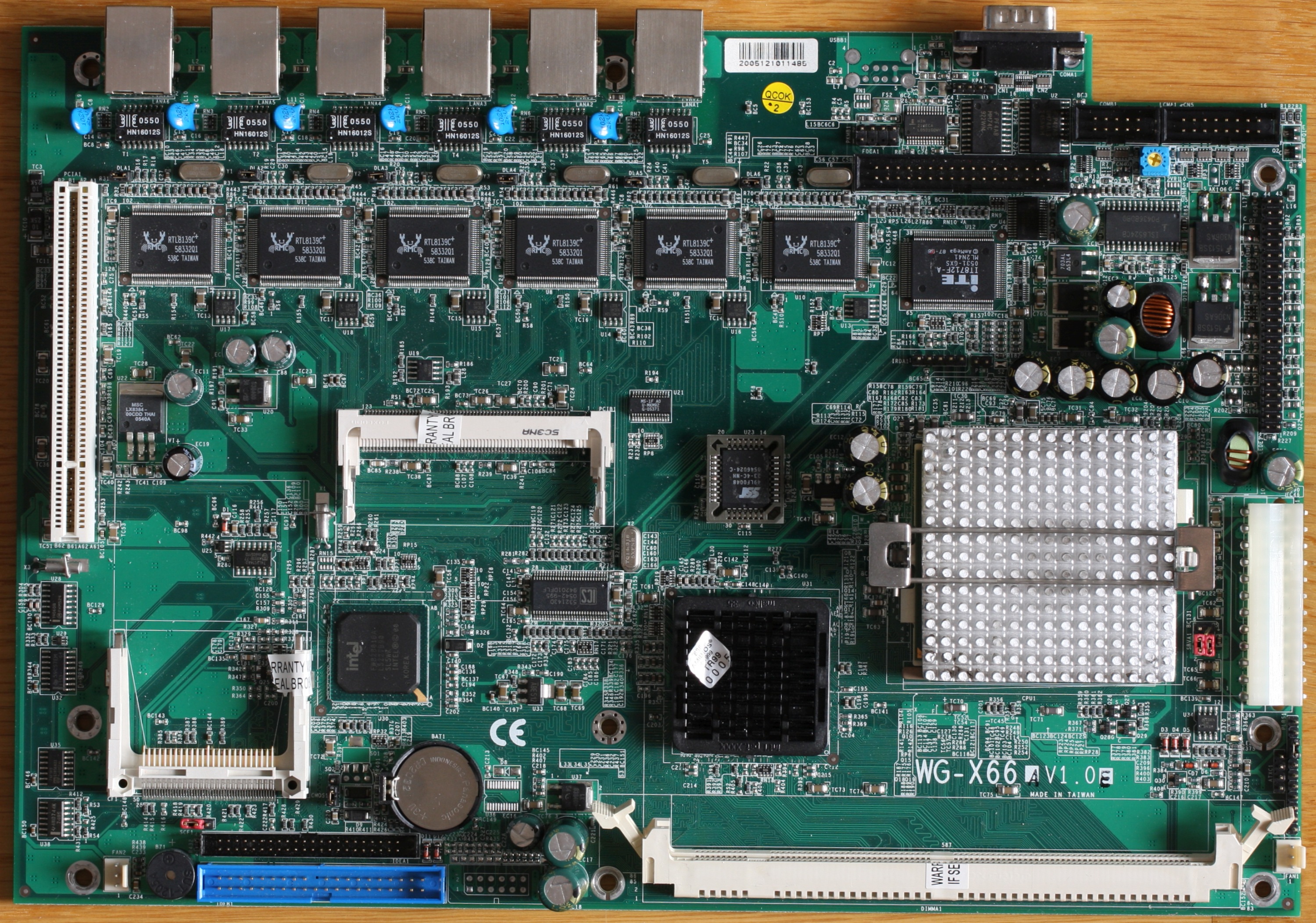

    I got this machine from my friend digge some years ago.
    It's been in my closet since I gave up about fixing it a long time ago.
    But yesterday I dragged it out again to see if I could get any further...
    I have confirmed that the BIOS is healthy, because a nice eBay seller named ceama sent me a known working copy a year or two ago.
    And it's a perfect match with the one that was already in this system.
    I can also read the BIOS dump with AMIBCP76.exe without any problems...
    I originally recapped the system for digge, but it did not bring it back to life, the UCC KZG 2200uF 6.3v CPU V_Core caps was what had gone bad...
    I tested the Fairchild N306AS MOSFET's yesterday with the diode check on my multimeter and they appear healthy.
    I also measure 1.73v V_Core on the capacitors for the CPU with a 1Ghz Celeron CPU installed. (Correct for this CPU).
    The mainboard is a WG-X66A v1.0E and while I have not found a manual for that I did find one for a very similar board.
    It's a Norco MB-X67 and it just has Intel NIC's instead of Realtek and some other minor differences:

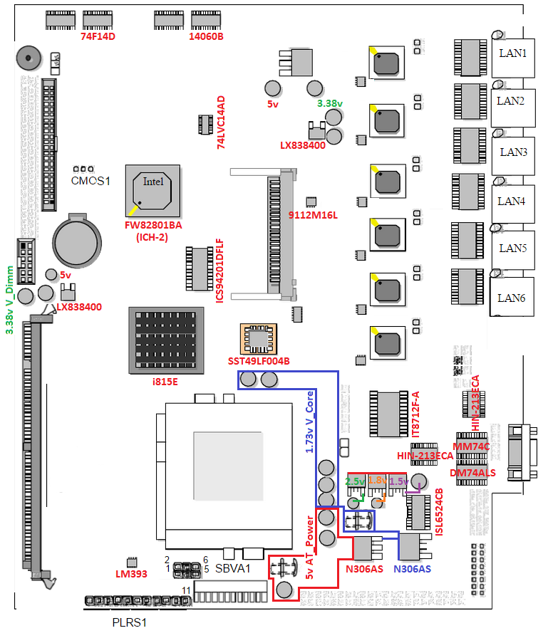

    I used that manual to create the attached diagram with some voltages I have measured on different caps.
    I also made a PS/2 keyboard cable for it, when I start it up the LED's on the keyboard do flash once, but they do not respond to any keypresses.
    Before I was using a small PCI Port80H test device and it did not show much, but I tried a MiniPCI version instead and that did show something.
    If I have a CMOS battery installed the system never leaves the "reset" state.
    But if I power up without a battery the system "almost" leaves reset state.
    I could barely see that the LED on my Port80H device was still lit so I measured it, in reset I see 1.85v and when the system tries to leave it is at 1.40v.
    At the same time the Port80H debug LED shows a number, but it's different every time I try...
    There is actually someone here with a similar problem, though his system does boot: https://forum.pfsense.org/index.php?topic=72450
    What could have been damaged to cause this weird behavior, where should I start to look?

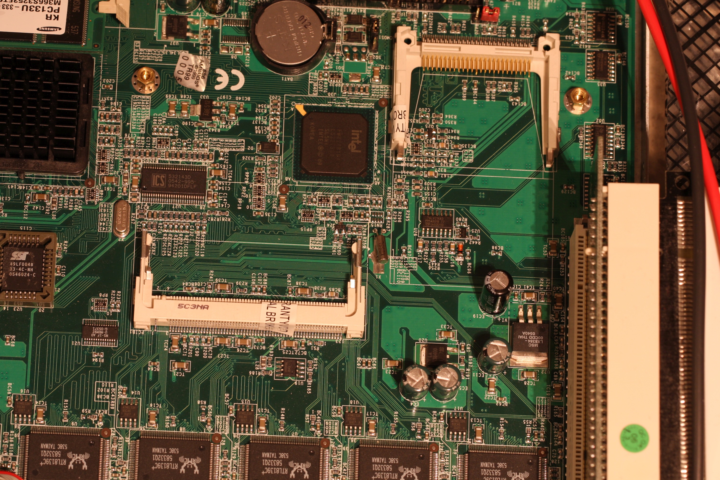

      I did some further testing yesterday and found a battery it was able to POST with, I was using a 2.99v battery and a 3.12v made it POST.
      I figured then that the CMOS SRAM in the southbridge might be damaged and just likes a bit more voltage.
      So I read the specs for the ICH-2 southbridge and it supports from 2.0v up to 3.6v.
      Therefore I tried some more batteries:
      2.88v, 2.91v, 2.99v, 3.04v, 3.12v, 3.26v & 3.60v
      But it was ONLY able to POST with the 3.12v one, and intermittent at that.
      But before going to bed I realized one thing, the clock was not working, even without a battery.
      So today I scavenged what I believed was a 32.768kHz crystal from another board, and then I replaced the "X1" crystal on the board with this one.
      I first booted up without a battery; now the clock was working!
      Next I tried a battery which did not work before; it booted up again!
      Final test I turned off the PSU, waited for 5 minutes and turned it on again: it successfully POST:ed and still kept the time!
      It's now able to soft reboot without hanging.
      And I was able to complete a test installation of Win2K which had only come until the step before the graphical bootup phase;
      Before it just hardlocked there with a blinking cursor, now it finished the installation
