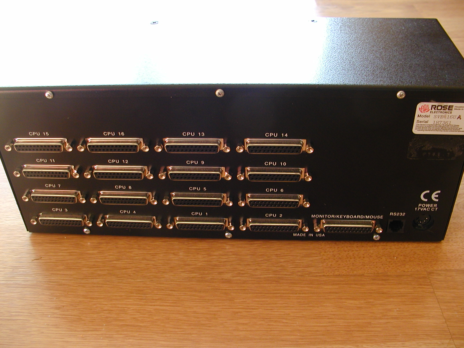

    Well my massive ServeView KVM switch arrived today and to my dismay it came without a power cord and making it worse it was not a regular connection. It's a 5-pin DIN connection and above it it's printed "17VAC CT".
    I own the SVE-16U version and according to Rose electronics it has either never been documented or never existed. I can make cables but the thing is a big bleack brick without power.

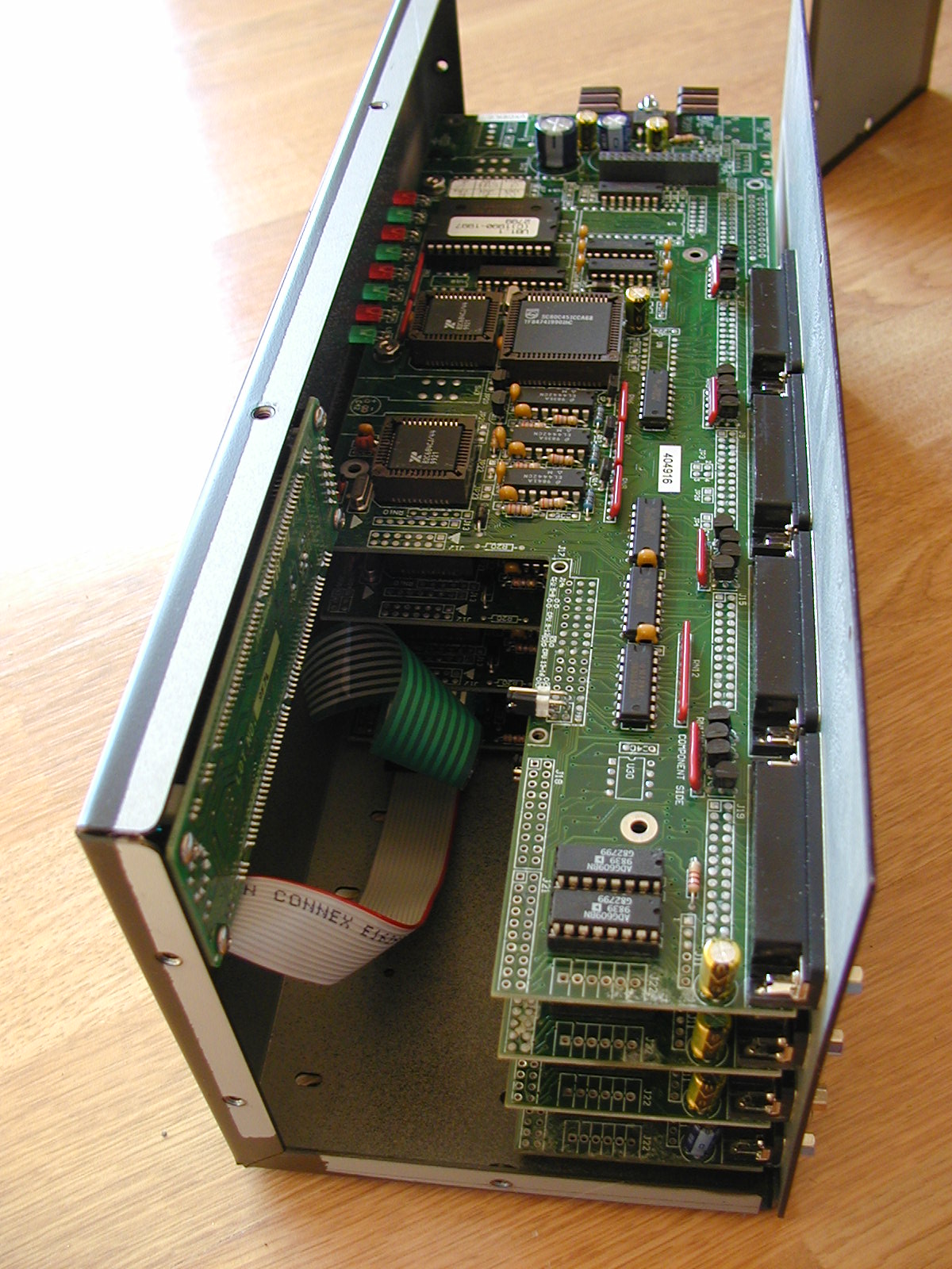

    Rats, this thing is a bitch (language) to take apart.
    There's four layers of PCB bolted together and the front panel uses that horrible flexible plastic ribon cable that is soldered to the board. Flexing it too many times causes problems.
    I'll try again.

      Well by the looks of it there was really nothing to worry about.
      Disassembly and inspection showed that there was nothing special behind the power supply and out of the five pins on the connector only two are used.
      Now to find a 17V ac power supply.

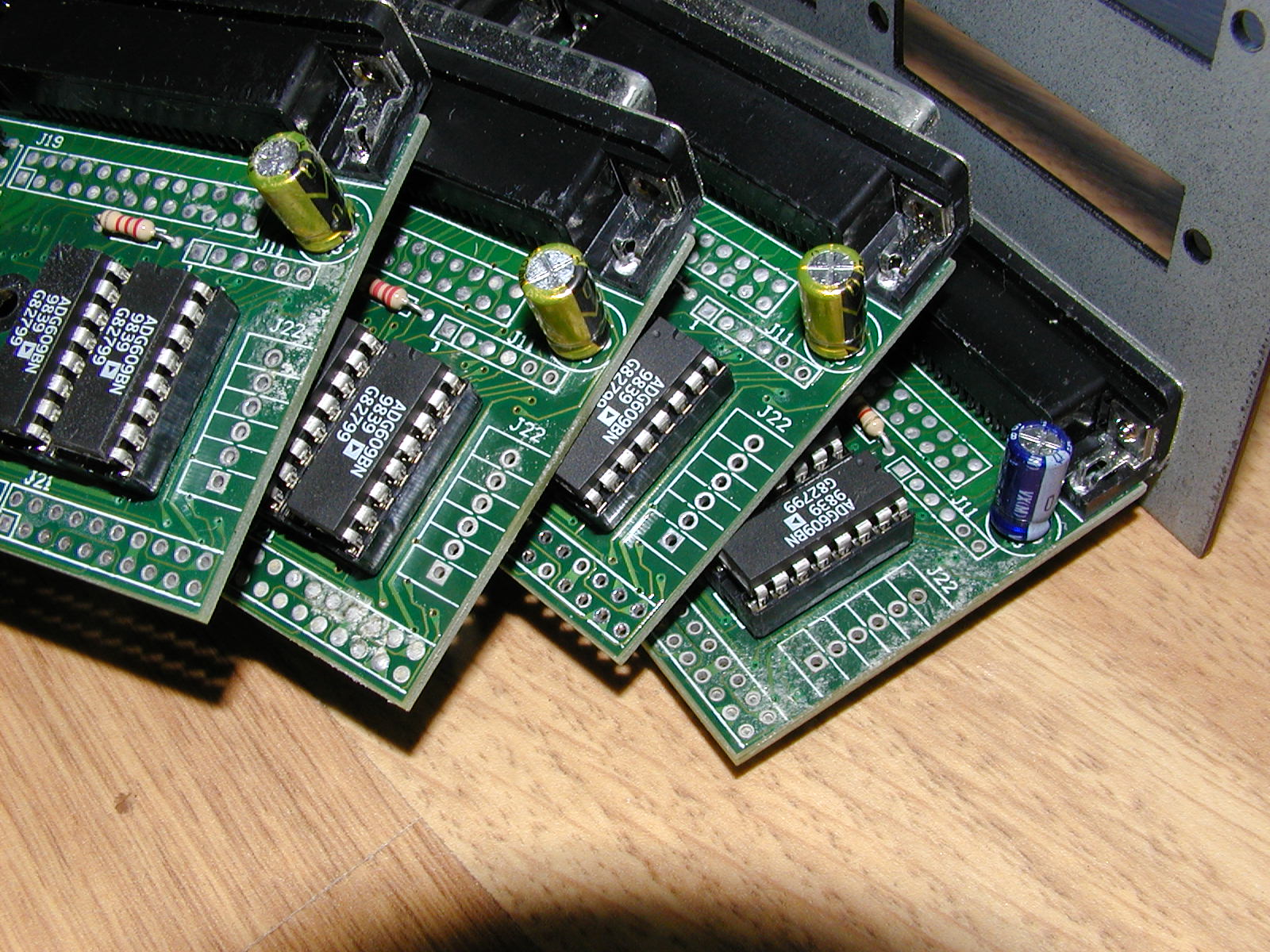

      One thing I did notice was that it looks like someone was sleeping in the inspection department. All the boards in the unit have flux residue that did not get washed off.
