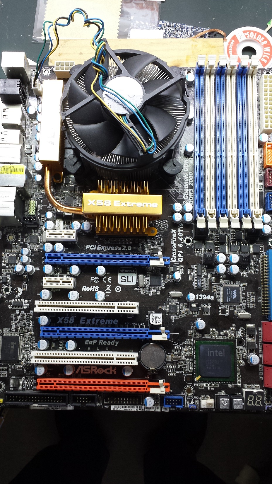

    I need help from you guys to troubleshoot my Asrock S58 Extreme motherboard. Motherboard turns on, fan spins but no display. The post card show nothing only FF. Problem was intermittent before and after turning it on and off few times it used to work but now won't show anything. I have tested CPU voltage .9v, Ram voltage 1.5V. Cpu heats up a bit. There is no clock running at 32.768 khz crystal. Where should I start, should I suspect the bios or it will be some thing else.
    Is there any testing points to find out what has gone bad?
    Many thanks in advance.

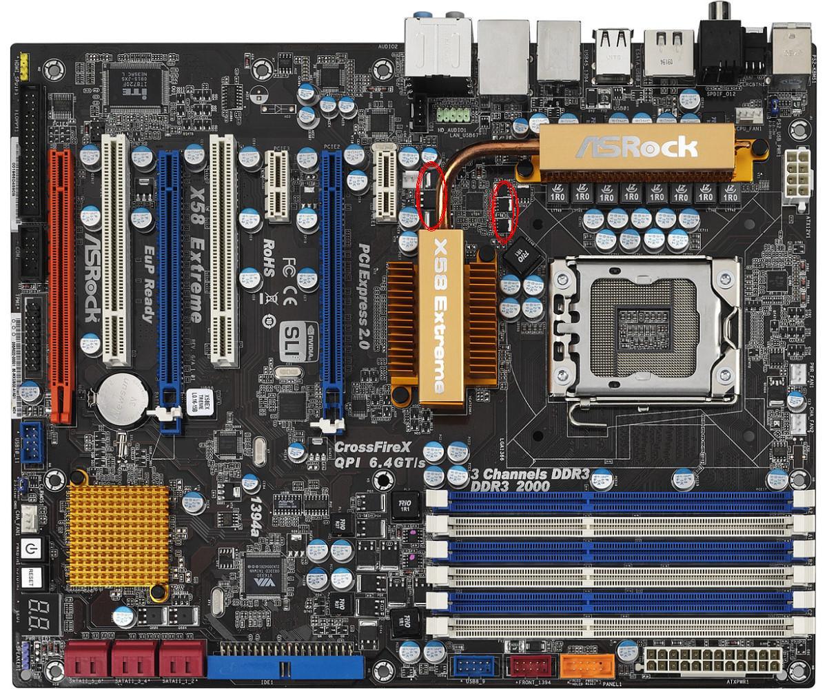

                  Re: Desktop motherboard fan spining no display
                  does it show anything else before ffff?
                  check voltage on every coil, check mosfets for shorts
                  also, asrock mostly have pour power design of power rails so they often fails if high power consumption cpu is used (high clock speed)
                  often i find bad transistor on chipset power (C5706 on some boards) shot, and similar symptoms displayed...
                  here is bios from website (MSI, GIGABYTE, ASROCK often suffer bios fail) but backup your bios first
                  edit, check red place for shorts on image

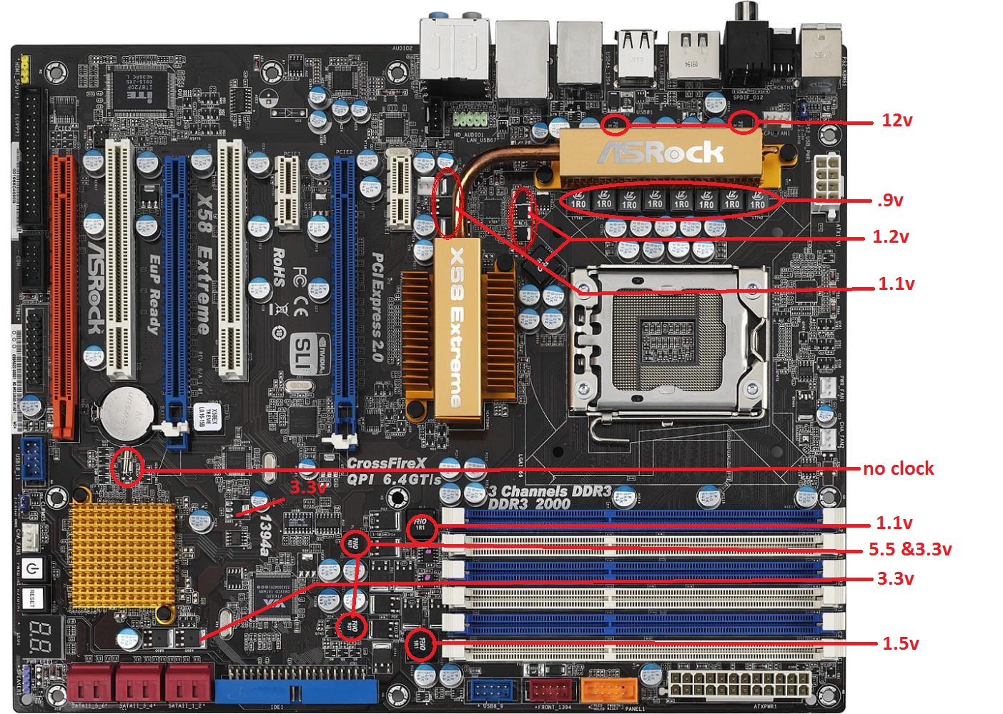

                  • imgaurav86
                    • May 2008
                    • 35
                    Hi ala_borbe,
                    Thanks for your help. FF is the first thing it shows as soon as I turn it on
                    I have checked the voltage on every coil and they seems fine as far as I understand. Check picture I marked the voltages on it.
                    I don't have programmer to flash bios but I am looking forward to buy one. Is that cheap 24 25 programmer any good??(link)http://www.ebay.com.au/itm/USB-24CXX...item4d256d5428
                    Can I flash the bios using hot swap method on other motherboard if yes then which program should I use.

                                      Ah, that AsRock is made by ASUS (those backwards cap polarity marks give it away). I don't like to discourage people, but it's not uncommon for ASUS and ASUS-made ASRock motherboards to die out of the blue with no symptoms.
                                      I see you made some voltage measurments. There appear to be two buck regulators under the RAM slots (or perhaps one buck, and a few linear?), so there should be at least two voltages there. One of them should be for the RAM, the other for the NB and/or RAM Vtt (usually 1/2 RAM voltage). There are also some MOSFETs between NB and CPU heatsink slightly towards the left. At least one of them should be for CPU Vtt.
