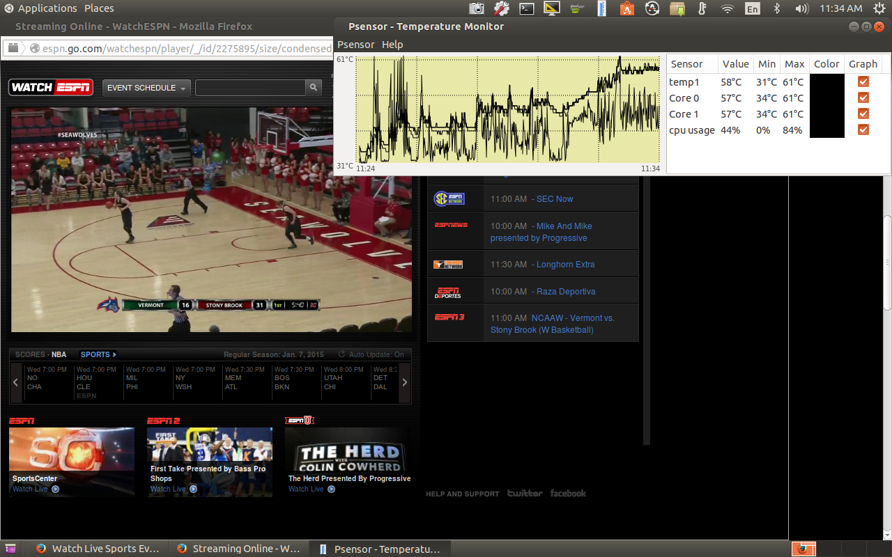

                                Thanks guys here a screenshot on Espn3

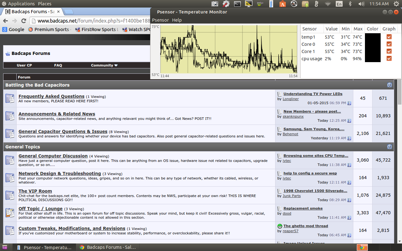

                                  here 2 more screenshots of temp in a IPTV sports and Bad caps forum

                                    Re: Browsing some sites CPU Temp goes higher!
                                    Wow 55-58 average and 61 max, that's great! The phenom II in my DV6 is between 47-53 when watching video, when using the on-board graphics. Mine has a better cooler and a better thermal design and isn't that much cooler than yours. So I would say that those temps are perfect!
