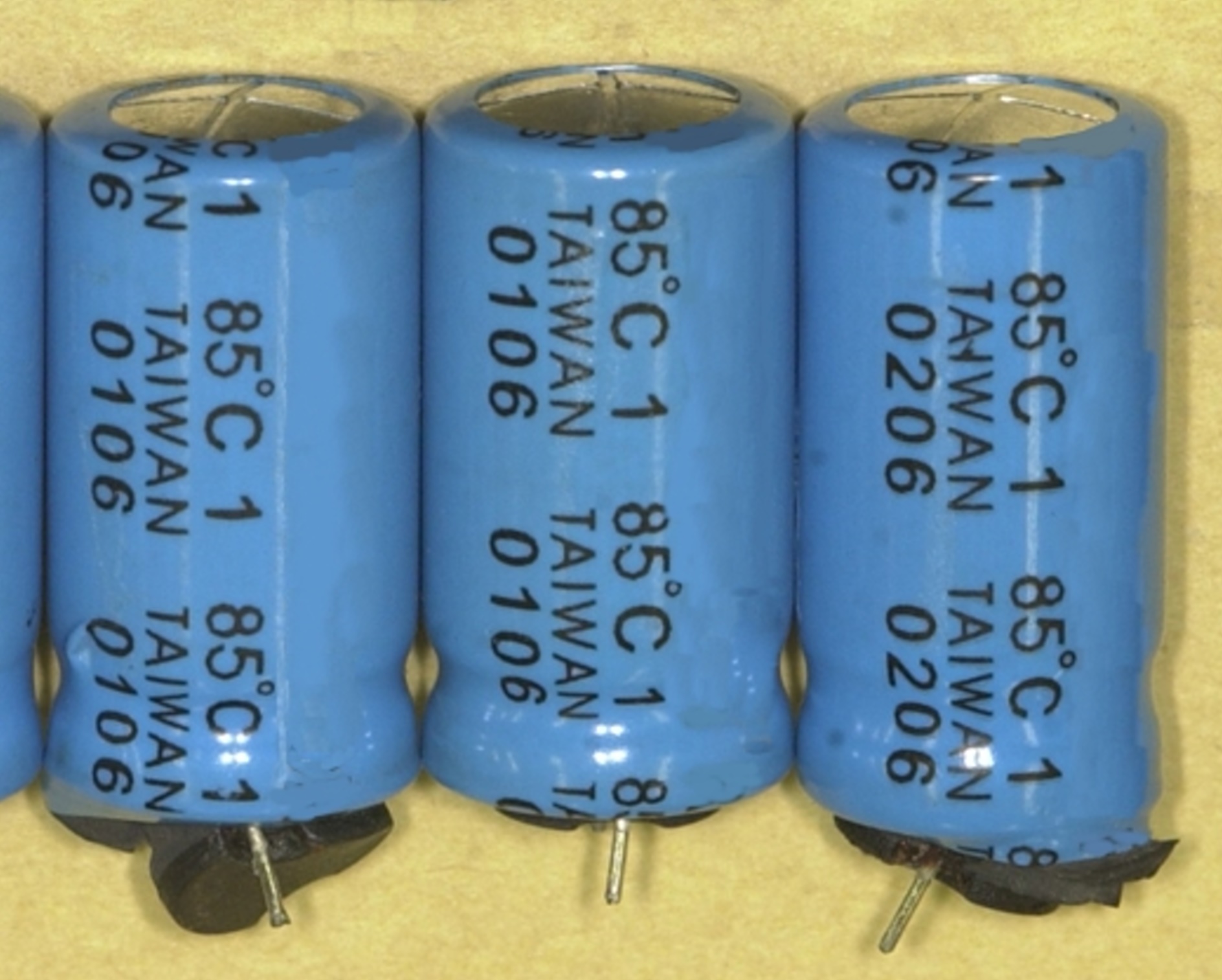

                  I know this might sound kinda obvious, but did you check the electrolytic capacitors on the board to see if any of them looked physically bad? You know, rounded tops instead of flat tops, leaking stuff on the board, etc. I've attached a picture from Wikipedia that shows swollen bad capacitors. I know to truly test for bad caps, you need an ESR meter. If you don't have an ESR meter though, a physical inspection wouldn't really hurt anything...just a thought.

                    How did you fix it? There were bad caps weren't there?
