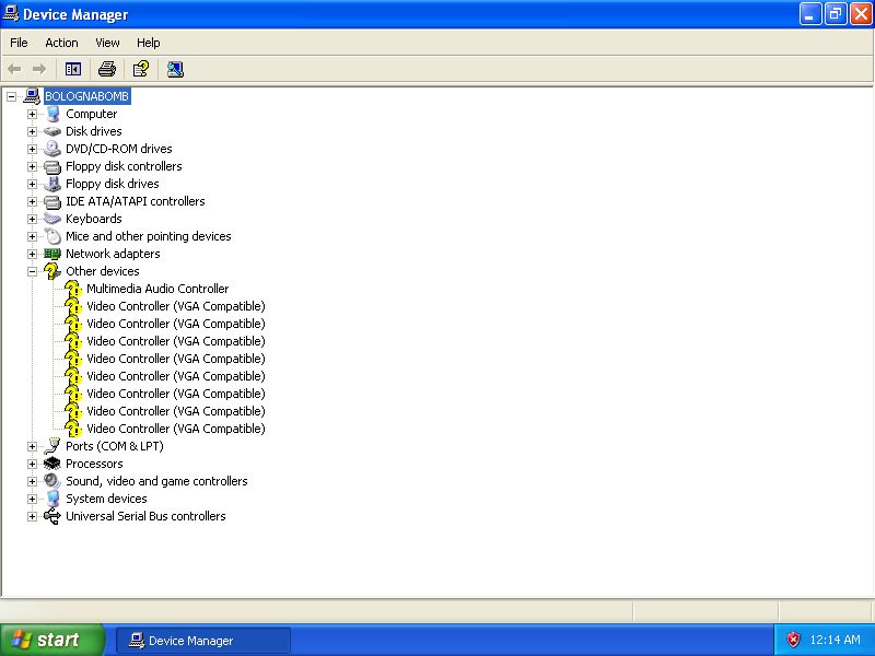

    Ok, here's a new one. I am upgrading a friends system and he didn't want to spend a lot so I got him a Biostar k8m800-m7a socket 754 board and an AMD Athlon 64 3000+ chip. I used his old memory and video card. After installing windows and going into the device manager it lists 8 entries for the video card. It is a Sapphire X800 GTO AGP card. I realize that there should be only two entries. One primary and one secondary. For some reason the motherboard thinks there are 4 video cards installed. If I install the catalyst drivers, I get blue screen of death and have to uninstall them in safe mode. I tried a different video card. This was a BFG FX 5900 and it worked fine. I downgraded the Bios to the newest one from Biostar's website and it does the same thing. Will I have to dump this board and undo my nice wiring job? I can see that this is a hardware incompatibility and may not be resolveable with this hardware combination, but I am hoping not to have to double my work and I don't want to eat the board since I don't need it and the restocking/return shipping wouldn't be worth the effort. The board only cost 30 bucks or so. Just to add I did install the latest chipset drivers.

            Delete all of the entries, reboot. Does the board have a built-in video option?
            Disable it in the BIOS. I assume it does since there's a 'm' before the 800.
            IIRC, you can't run the built-in video and an external video card simultaneously.

              Ugghhh. I tried this card in a different motherboard and it shows the same thing. This time I used an nforce 3 board that had no onboard video. I then tested 2 different cards in both motherboards and Everything worked fine. The cards I tested were a geforce fx 5900 and a radeon 9800xt. It is starting to look like a partial video card fry. My friend smokes and the video card had a lot of dust in the heatsink and He plays Counterstrike constantly. Add that to the fact that we had a lot of days over 90 degrees around here and that is probably it for the card.

                  Windows detects plug and play devices by reading the PCI device ID information, which should be shown to you momentarily at the POST screen. Try hitting pause on your keyboard and writing down the Vendor ID, etc. that it lists for your devices. Then look them up online and find out if any of them are incorrect. This can happen sometimes with a glitchy board or PSU, and I've "fixed" it before by moving the offending card to a different slot. It's possible you have multiple devices which are reporting an ID which Windows would identify as a video card.
                  I've had this problem a couple times before, once with a network card and the other with a sound card. One time it was a power problem (3.0V on 3.3V rail), the other time the card just needed to be reseated.

                    What seems very strange is that The card seems to have failed in a non-standard way. There is no glitching. The card can provide a basic video signal but it reports itself as multiple card. This is not something that I have encountered before. I guess heat can do strange things to video cards.
