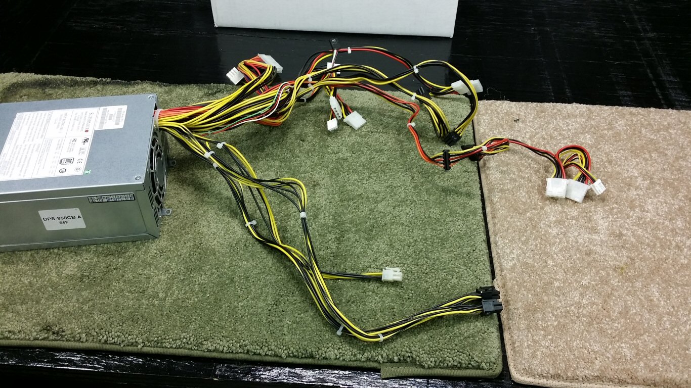

    I stumbled upon this PSU on ebay for $35 with free shipping, knowing its a $150 PSU. Seller said it worked, so yea, worth a gamble. Seller said it was pulled from a workstation they were parting out.
    Well here's what showed up:

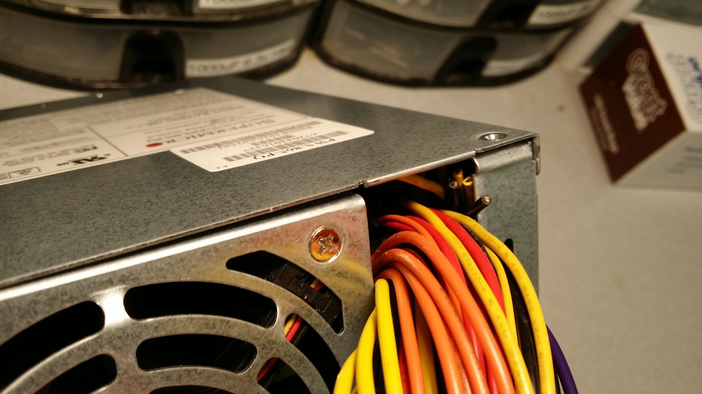

    Note the cut wires........ I took those for the seller and sent an email. Figuring he'd just refund my money and I'd send it back is what I expected, that totally didn't happen. He had Newegg drop-ship me a BRAND NEW replacement, 2nd day air. He also told me to keep that one and said fix it if you can or use it for parts... Since I didn't have to return it, I cracked it open....

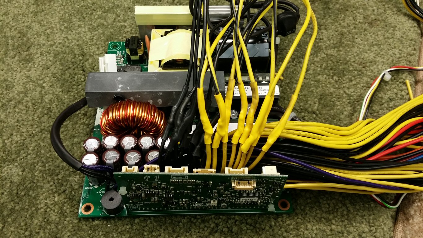

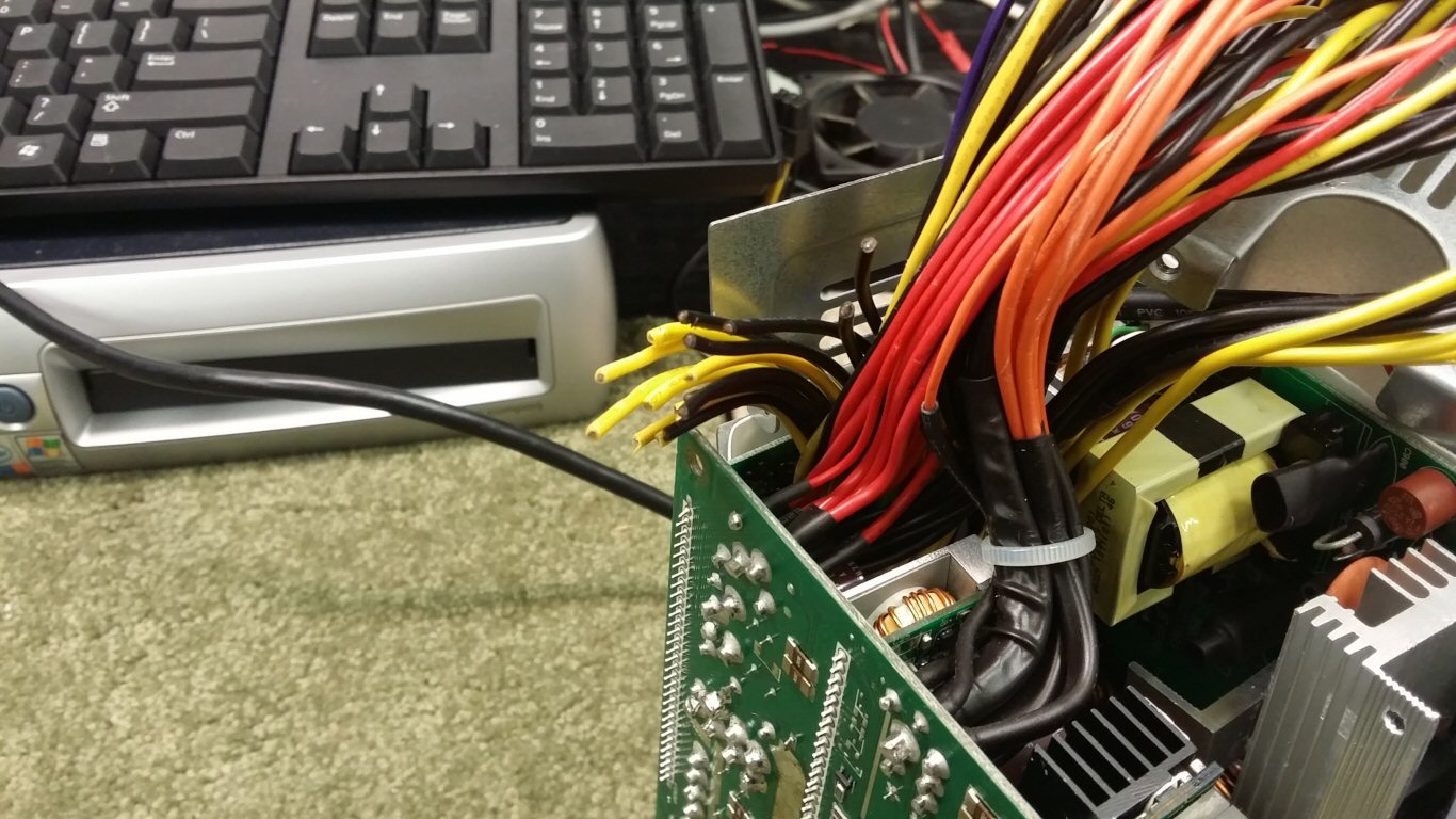

    16 cut wires, all on the 12v rail. The 4-pin ATX+12v plug was missing, as were 2 of the 4 PCI-e GPU power cables. Why some twit decided to cut those off is beyond me.....the PSU does work fine, I tested it before wasting any time repairing it....I had a bunch of PCI-e GPU modular cables from a bunch of HE550's I had. I bilked the 4-pin ATX+12v cable from another dead Antec I had in the junk pile....

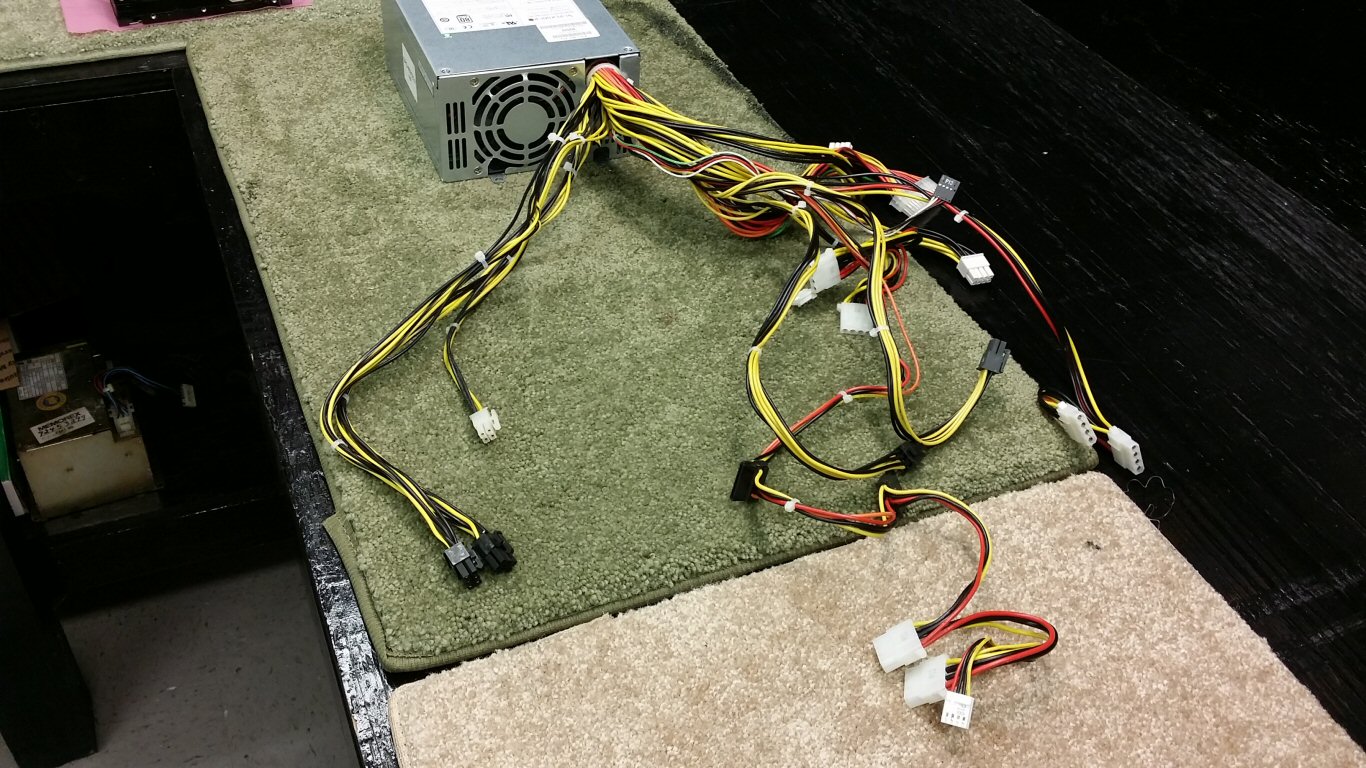

    Then came the fun of splicing it all together. They're all soldered, and then heatshrink tubing to insulate.

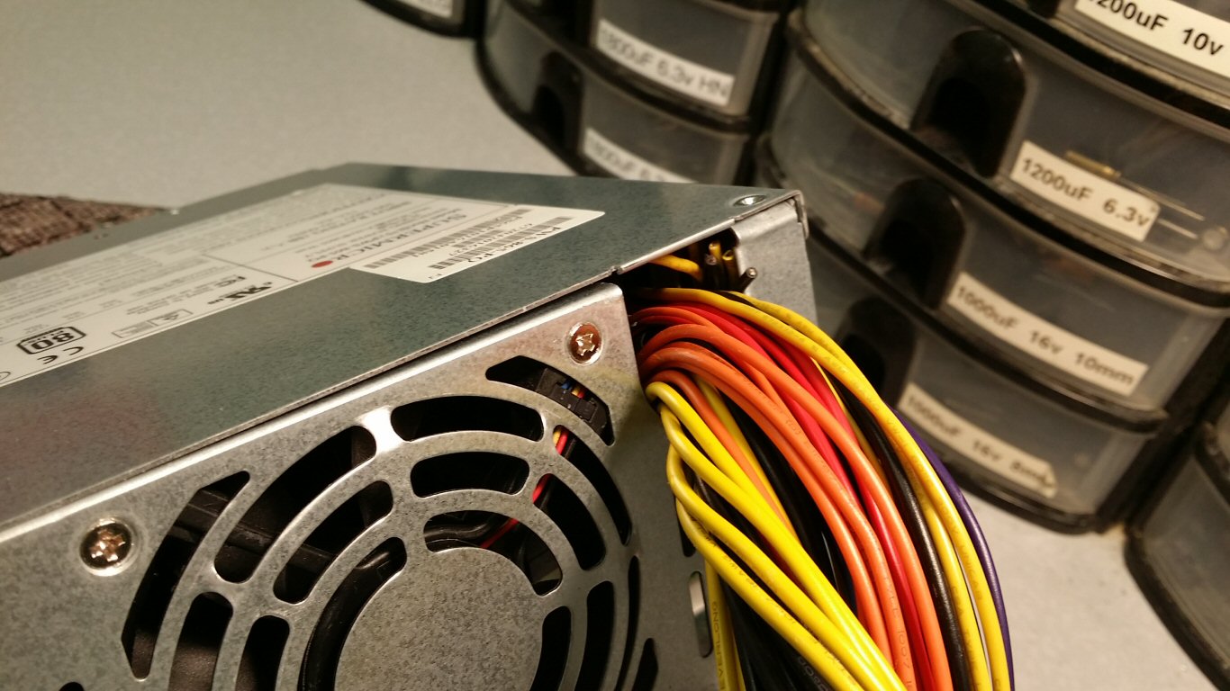

    All back together and good as new!!

            Nice job. Can you elaborate on the two wires you attached to each cut wire on the 12V? Do you have a crimping setup and all? If not, how did you do it?
                Which one? I didn't double any up. Are you looking at one of the factory connection? I soldered all the splices I made.

                Actually, this PSU looks kind of similar to mine, with the dual-PCB design (and 100% Jap caps ).
                Yes, there are 2 large PCB's sandwiched in there with the smaller 'daughter board' on the side, only half of it is shown in the pics above. It is packed VERY tight, and yes, all jap caps. none needed to be replaced, believe me, I checked!!
                  Ah, I thought they were two wires, but upon closer inspection, it's a yellow wire with a black stripe. Good job.
