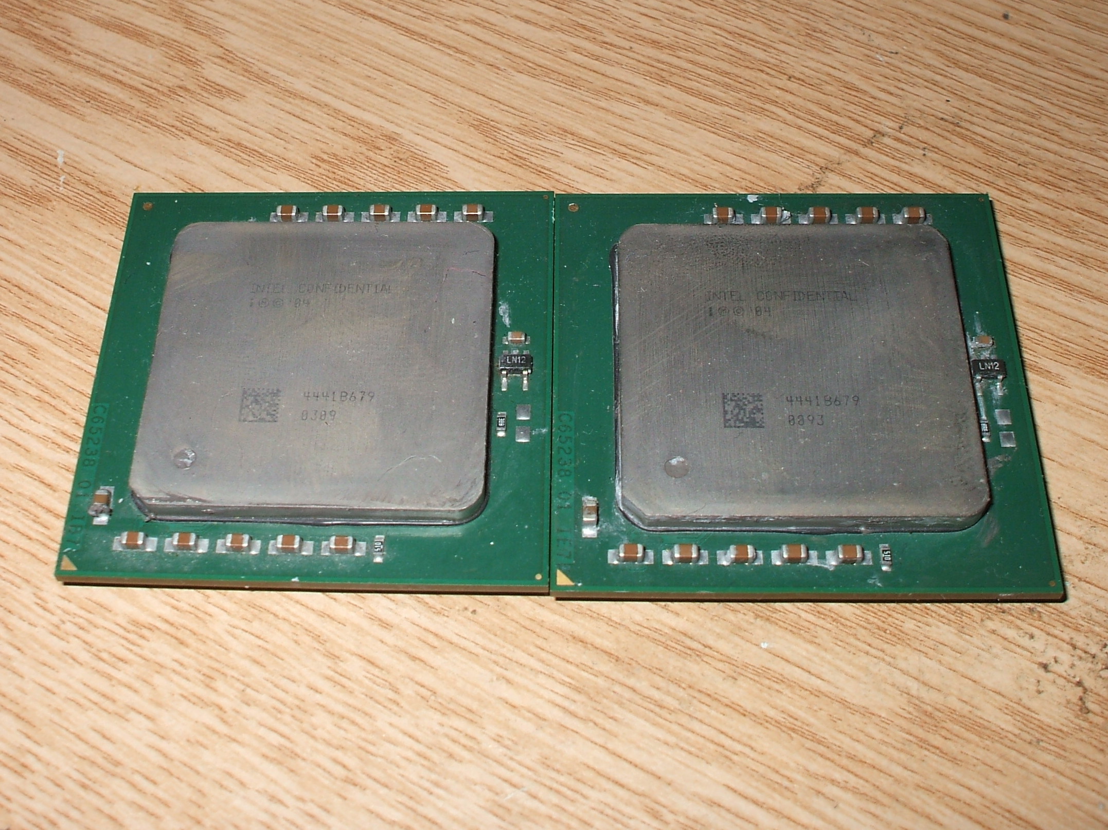

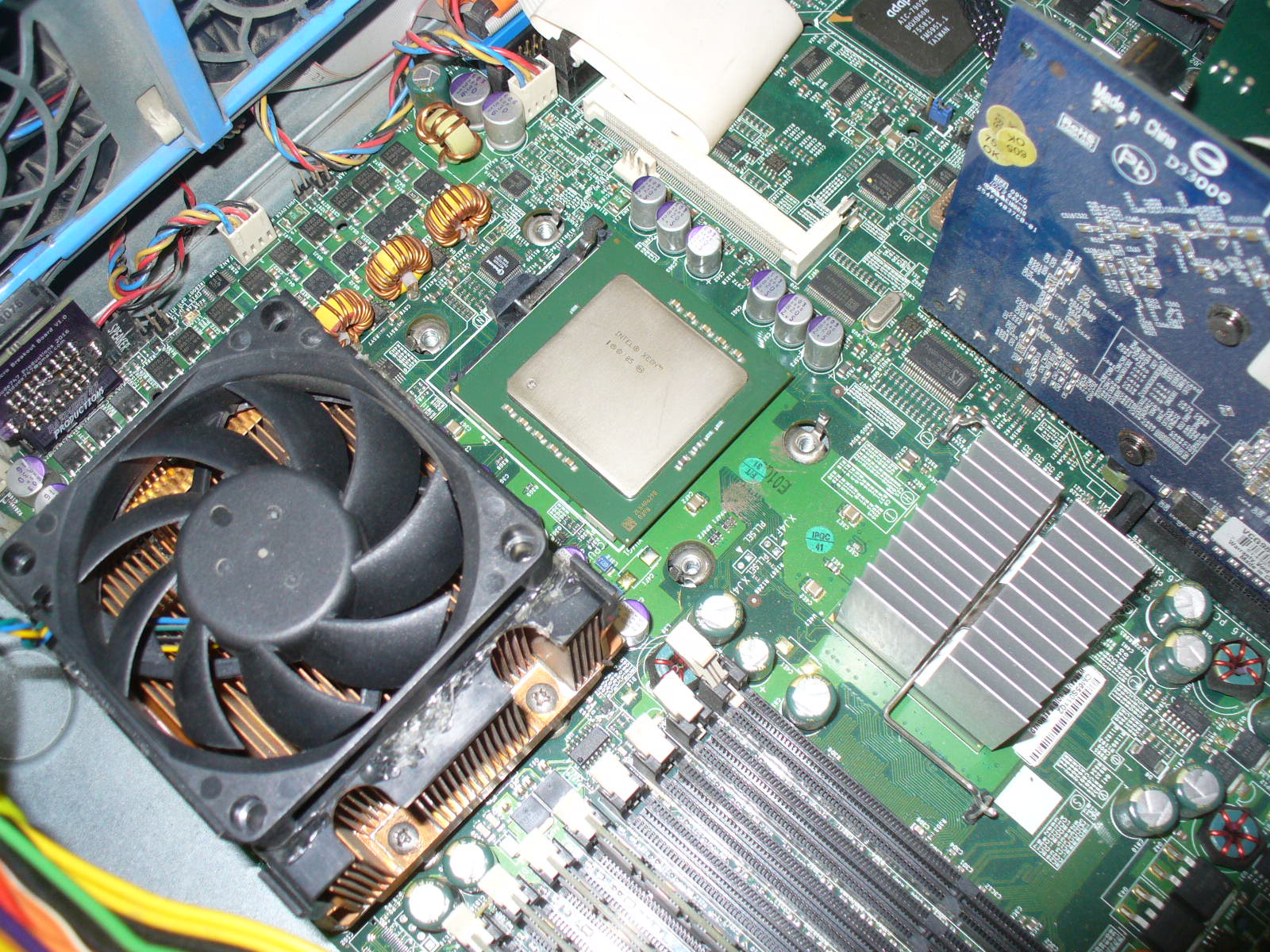

      BTW, here's a pic of the engineering sample CPUs:
      Engineering samples: fun to play with, not so fun to use on a daily basis.

      • brethin
        • Dec 2008
        • 1907
        #103
        Re: Ratdude's Main Rig V4.1
        ES CPU's while not locked are not the cream of the crop. They are stepchild's of what is to come. As you said yourself "Engineering samples: fun to play with, not so fun to use on a daily basis". Bragging because they are not common is ok when it matters. In this case it does not, these are shit and you got suckered into the Engineering Sample Drama. Stop spending your money on shit already now that you have job and no longer are freeloaded on the government you should wake up.

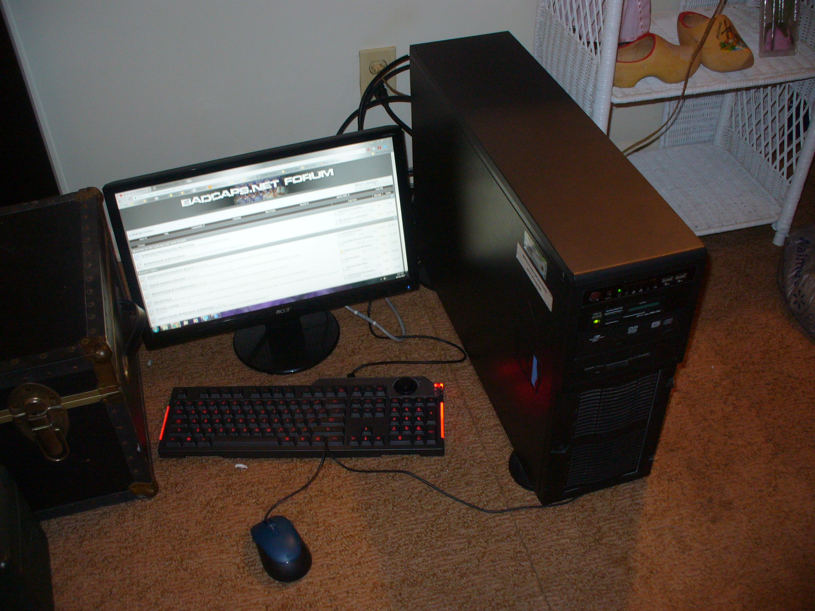

                    ...and a year and a half later, I have a use.
                    I recently bought a house and ended up adding a front entry area LAN connection.
                    I don't have a desk for her yet, but I do have the other goodies:
                    That's a 20" Acer P205H 1600x900 glossy "Gaming" (low latency) monitor. I have a 24" 180p LED-backlit Hanns G unit to upgrade with if I ever get around to recapping it. For now, this will do.

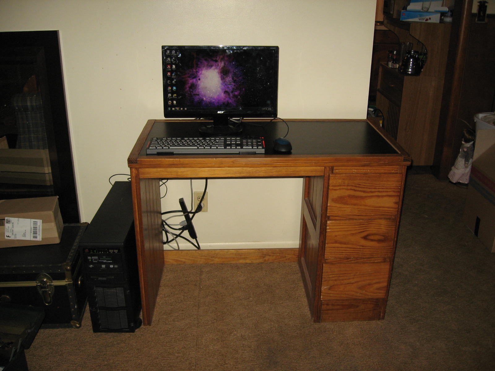

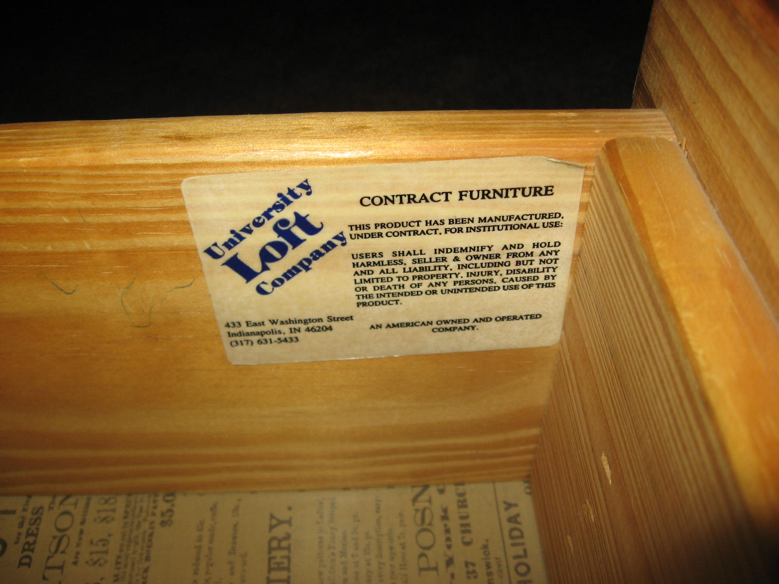

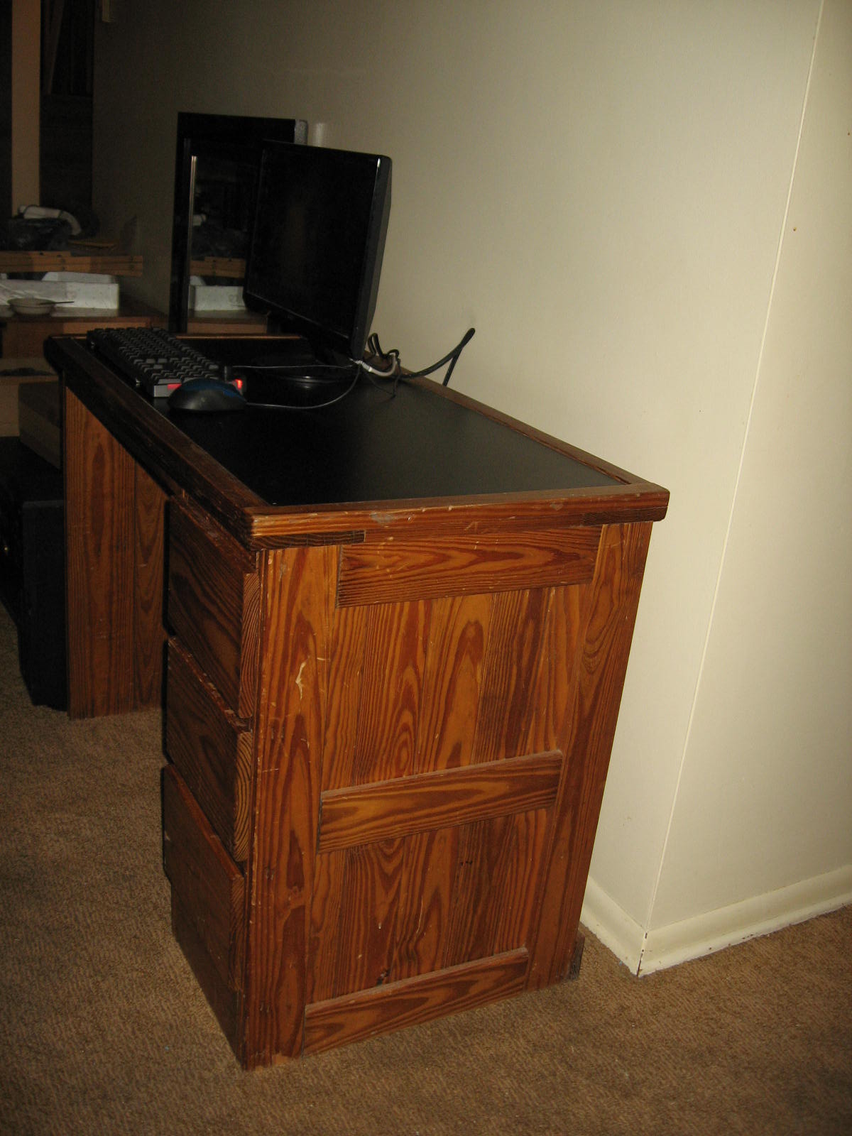

                        Finally found a desk:
                        Nice solid wood. I think this used to be a dorm/school desk, because of this sticker inside:
                        You know things are real when the desk has a legal disclaimer. Also must be old, as nothing good is made on Washington St. in Indy any more (other than skyline chili by 465)... Poor Flick can back me up on this one. Edit- they're still in business, but now in Greenfield, IN (much safer place east of Indy on I-70).
                        Still, for $25, not too shabby?

                        • Topcat
                          The Boss Stooge
                          • Oct 2003
                          • 16956
                          #112
                          Probably made by a 'sheltered workshop' (physically/mentally challenged people) or prison inmates.... You can tell by looking that it's hand-made. Quite classy compared to pressed wood garbage.

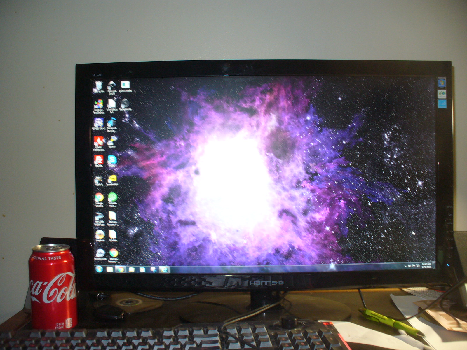

                                Finally got around to recapping the 24" 1080P slim LED Hanns-G LCD... which was a complete success:
                                Coke can for scale. It's not nearly as massive as Topcat's 30" monster, but it's it's the biggest LCD I have currently (Second place: my 2 22" 16:10 LCD's on main rig V6 in the office). Really nice display quality too. Not bad for $10 at Goodwill, a random >3A 12V brick, and < $10 of caps?
                                The Acer Gaming LCD died... won't turn on at all. Recapped it, still no good. No power light or anything... bad power switch? Until I got the above unit fixed, I picked up a HP S2031 unit to get me by (not a bad LCD, minus some weird crosshatch pattern on the screen which I read is probably a misaligned polarization filter (panel defect from the factory?).

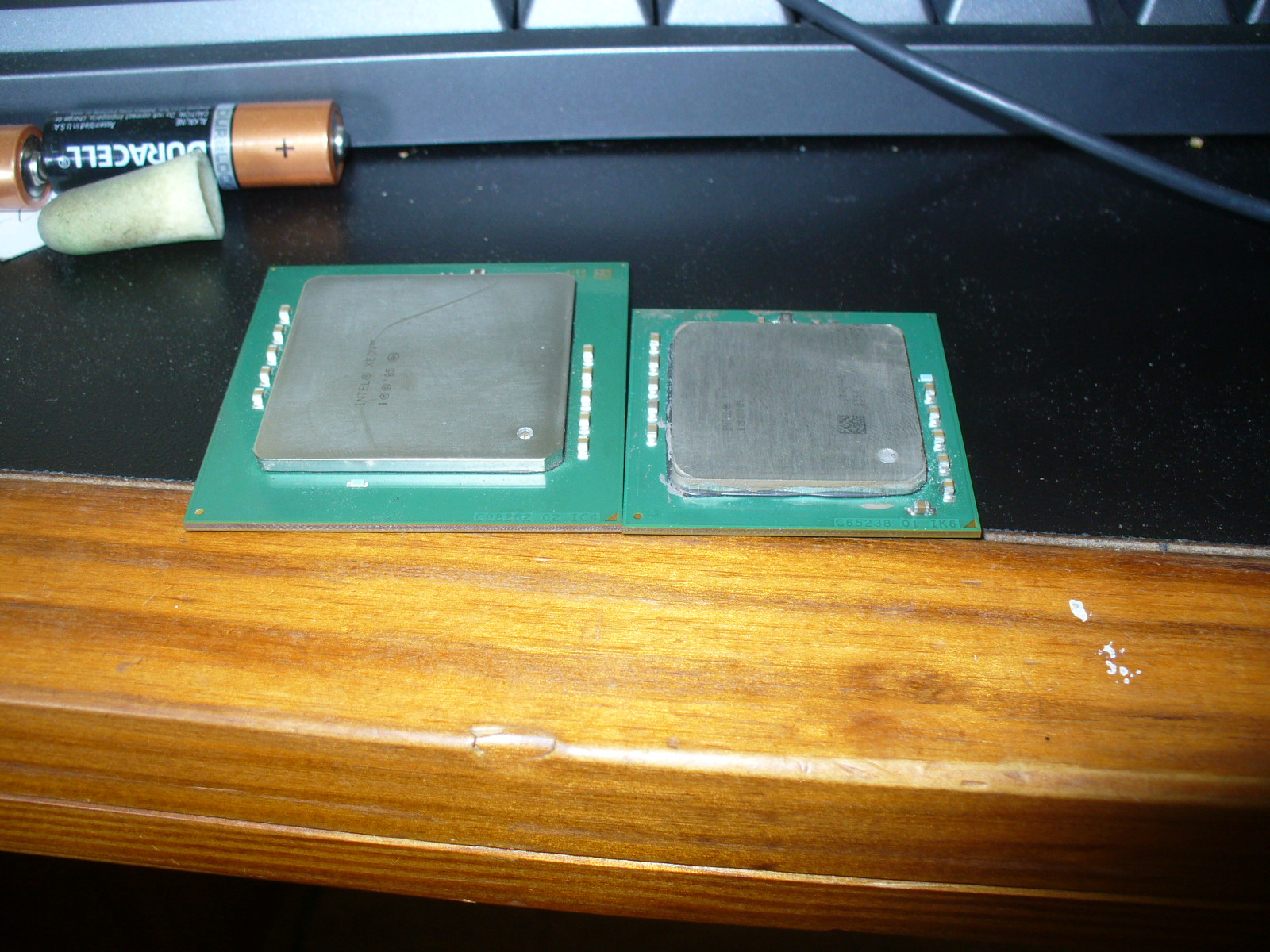

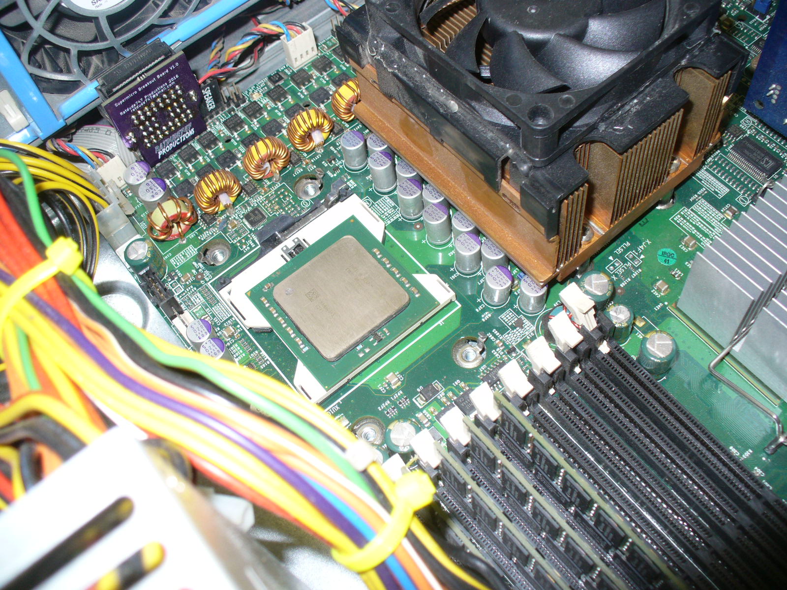

                                  Since Topcat was able to to make Paxvilles run in one of these, and I was able to get a pair for $20 shipped :jaw:, I figured I'd try it myself in this rig.
                                  His benchmarks that I will be referencing: https://www.badcaps.net/forum/showth...947#post825947
                                  First, some interesting pictures:
                                  Thanks to it being dual die, these things are massive compared to irwindales:
                                  It's so big it's bigger than the socket and overhangs a bit on the end:
                                  Compare that to an Irwindale (same size as Nocona and Gallatin):

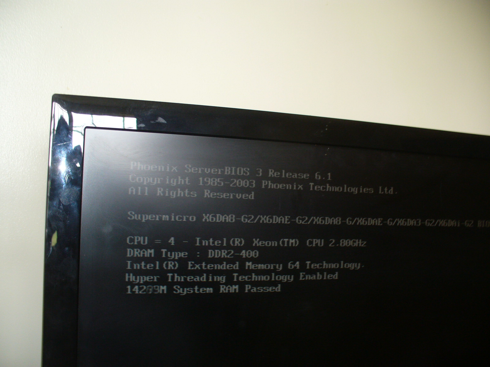

                                  After the install... she posts!
                                  Took a few starts to make it boot to windows... odd. Hopefully this isn't a repeat of the 3.6 ES chips from the start of the thread. So far it's rock solid though.

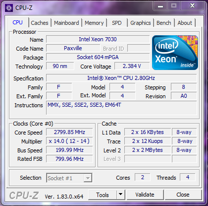

                                  Confirmed in CPU-Z:

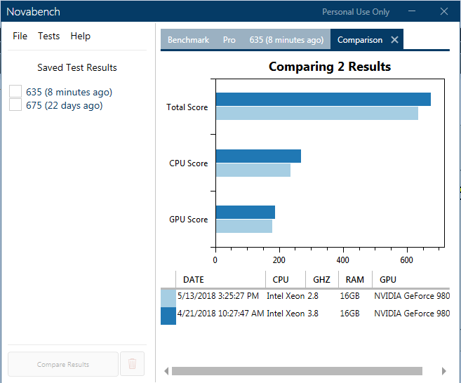

                                  I ran a novabench benchmark on it a few weeks ago, which I can use to compare the 3.8 Iriwindales to these Paxvilles. Lucklily the latest version of Novabench safes old results and allows for convenient comparisons:
                                  Funny, it's showing the Paxvilles as slower, the exact opposite of Topcat's findings. My Windows Experience index also dropped.
                                  All I changed was the CPUs and the AS5 compound (and monitors, as per my last post... it's higher resolution...). Same RAM (16GB DDR2), GPU (Geforce 9800 GT EE), and HDDs (two 7200RPM 160GB's on a RAID 0 9650 w/BBU).
                                  BTW, the 1080p@60 youtube buffering issue didn't go away either.

                                  • Topcat
                                    The Boss Stooge
                                    • Oct 2003
                                    • 16956
                                    #117
                                    Only one CPU is showing up, thats why the results are off.
                                    ^^^^^^ You'll note that the "socket #1" dropdown is grayed out, there should be a live dropdown displaying socket #2.
                                    ^^^^^^ To confirm: If HT is enabled (which it is by default), that should show 8.

                                    • ratdude747
                                      Black Sheep
                                      • Nov 2008
                                      • 17136
                                      #118
                                      ^Son of a ******
                                      Bad CPU? HT is enabled as per that screen. Will reseat and try again.

                                      • ratdude747
                                        Black Sheep
                                        • Nov 2008
                                        • 17136
                                        #119
                                        I think I see what is going on here... and it's not good.
                                        Topcat, your X6DA8 did the same thing:
                                        https://www.badcaps.net/forum/showpo...72&postcount=3
                                        Likewise, with either 1 or 2 CPUs installed I get the same screen. Device manager only shows 4 CPUs in either case. Both of my CPUs are good (ran it on one CPU using each). My CPU2 socket is also good, as I was seeing everything with the irwindales.
                                        What I suspect is there is some board quirk making this thing max out at 4 CPUs, and that is why they're not listed as compatible on SM's site. Yes, sure, it will boot, but if you can't get all 8 threads, what's the point?

                                        • Topcat
                                          The Boss Stooge
                                          • Oct 2003
                                          • 16956
                                          #120
                                          My X6DA8 ran them, both sockets. The pic I posted was only one socket populated for POST testing purposes. I did however run into this with the X6DAL, as I mentioned in the thread, it would only run one CPU.
