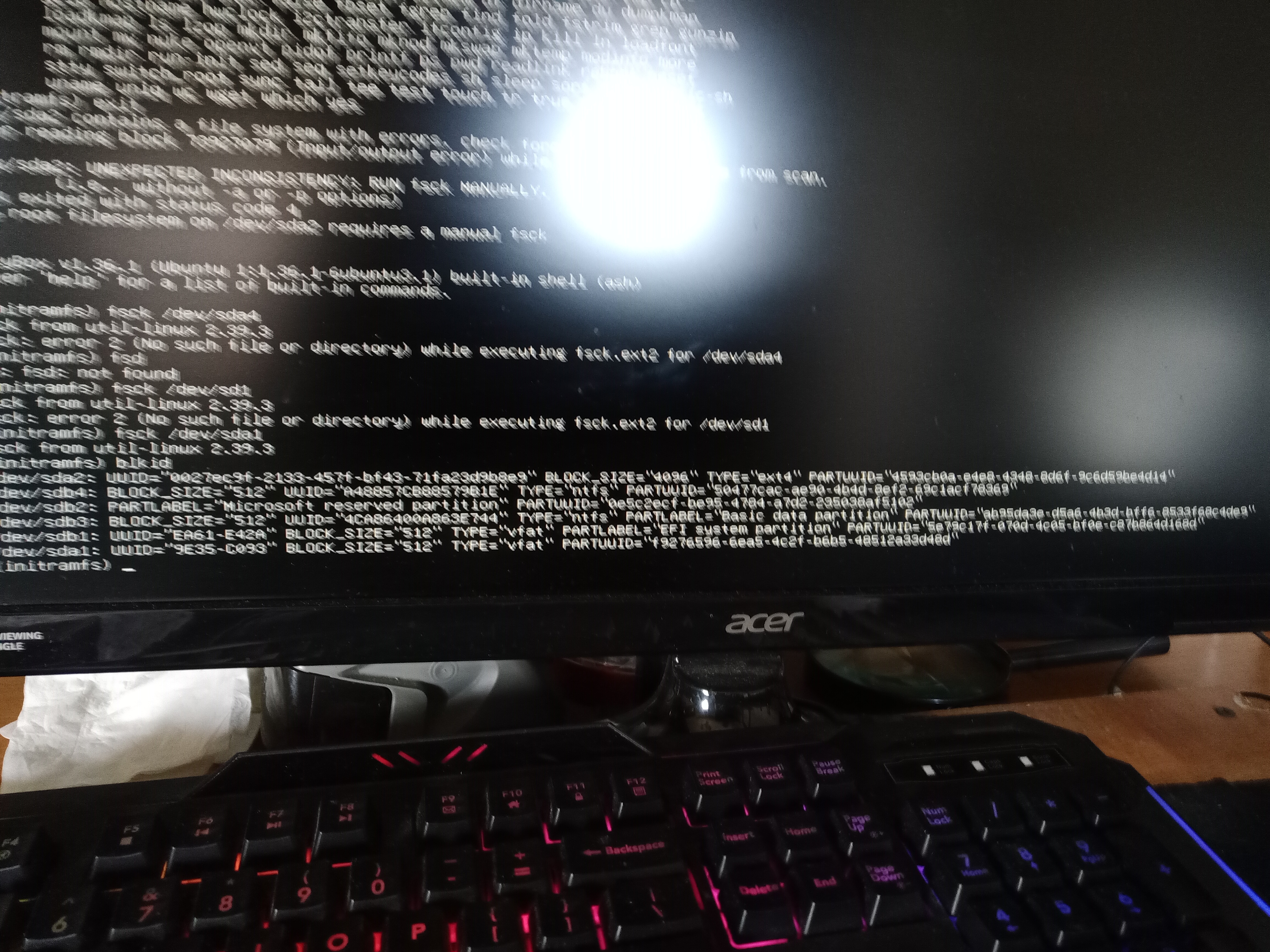

    Hi folks i installed Win10 in 1 HDD and Unbuntu 22.04 in other HDD and installed Grub manager ,it has been working fine till i installed new updates. now it wont boot and doesn't make recovery either and stuck on initramfs ,i type blkid and get this see pic attac. bellow ,althou it boot in Win10 .Any help will be apreciated .
    • 31199
    i cant read that, but the 3D font is impressive!
    so SDA is Linux and SDB is windowz.
    you have a lot of partitions listed, but one thing that stood out was a reference to /DEV/SD1
    what the hell is that? you dont have a card reader with a card in it do you?
      so SDA is Linux and SDB is windows.
      what the hell is that? you don't have a card reader with a card in it do you?
      I had 2 HDD 1 Disq 0 win10 the other Disq 2 Linux and grub manager and DVD drive , i did not know either what was Dev/S/1 , i had no cards readers. What i found out was that i was running in the Bios HDE instead of AHCI which i corrected by reinstalling Win but this time i only kept 1 HDD with win10 for now,that is a keeper till i get issues due no support cause i have some prog that only run in Win.

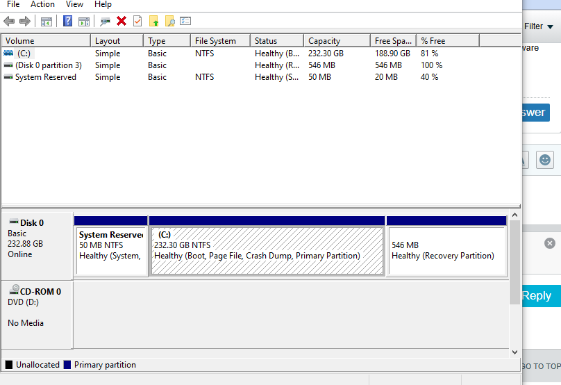

          Now that i have only 1 HDD and DVD see pic .
            • 31199
            recovery partition?
            it wont save you from a head or surface failure!
            thats what a backup drive is for.
              recovery partition?
              That's the recovery partition created by Windows, for "Windows Recovery Environment", along with the 50MB "System Reserved" boot partition for the bootmgr and BCD
