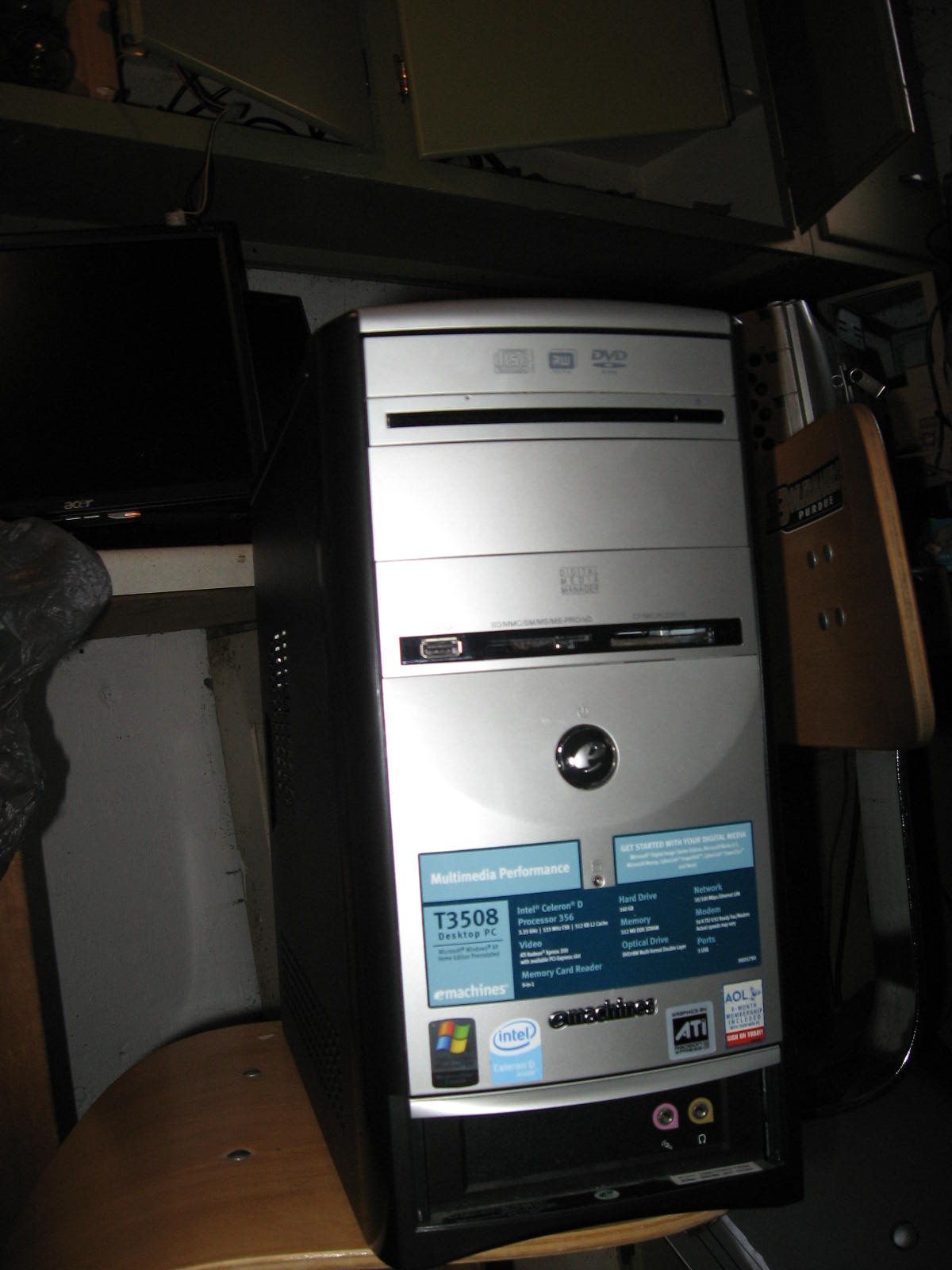

                                        I think I scored a chassis, at least for the mean time:

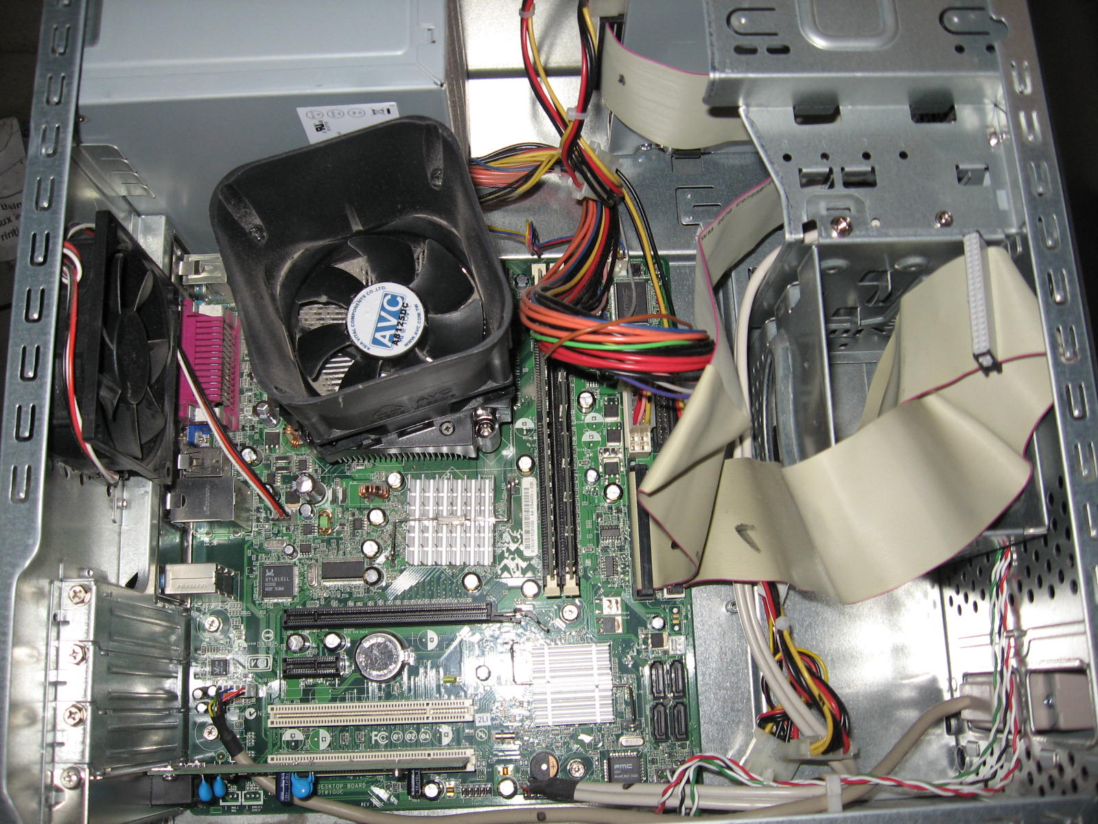

                                        The insides are pretty basic:

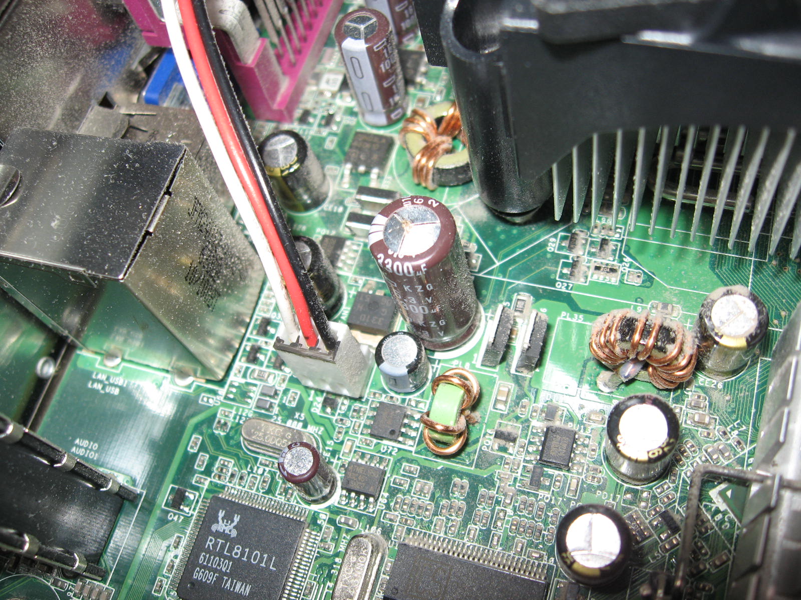

                                        And once again KZG's have bombed it:
                                        (I've since recapped it with a Nichicon HN and some Samxon GD's.. all heatsinks cleaned and AS5'd too)
                                        For an an intel board (rebadged D101GGC), I was kinda disappointed... ATI chipset, realtek everything else (only 10/100 LAN )... but it does have decent expansion slots. And like the nicer (although w/o PCI-e 16X) version I used to own, the front switch/LED lines are separate, which allows easy re-routing of the HDD LED to my RAID card.

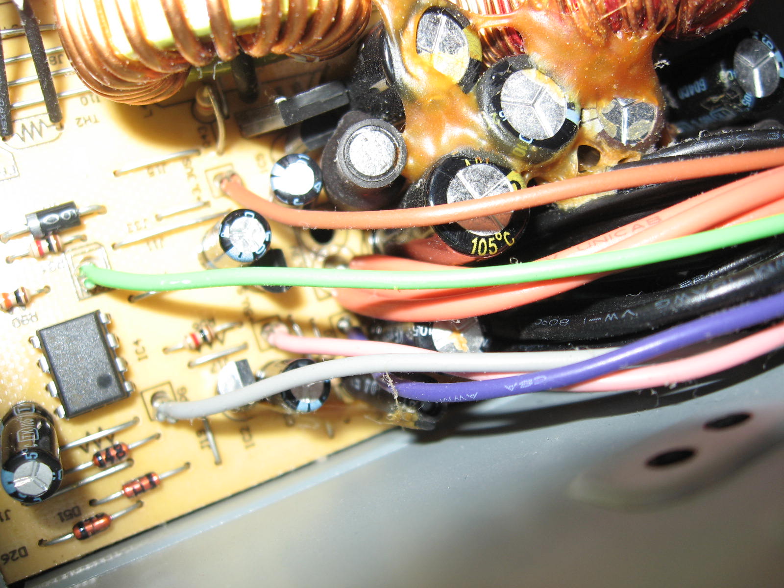

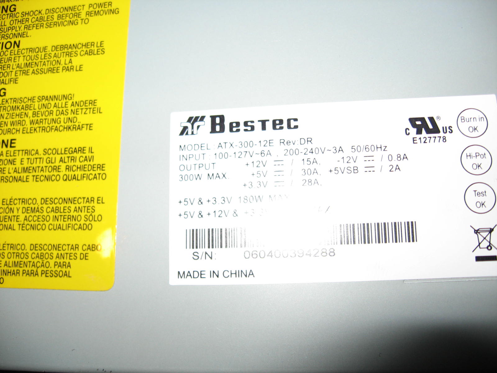

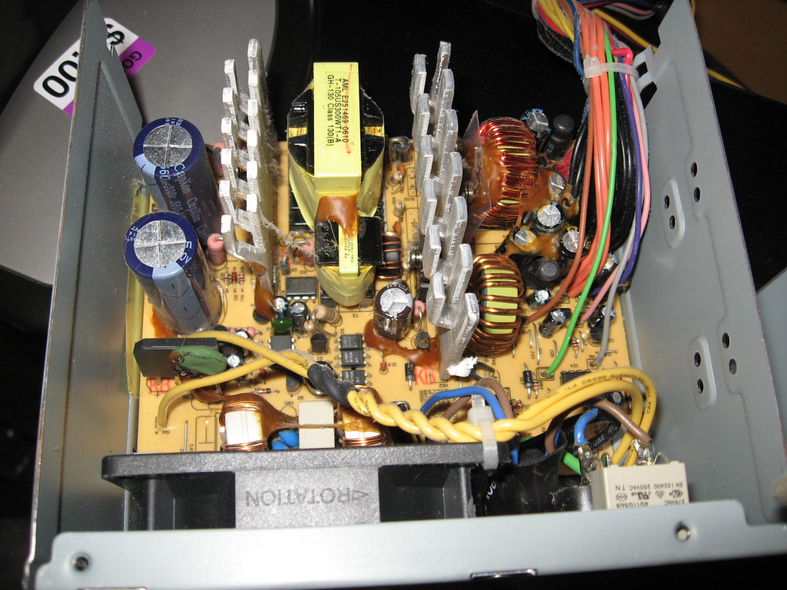

                                        The PSU is a POS IMHO... 300W Bestec (12E)... for 300W it's pretty gutless too. See the attached pics (and Everell, if you read this, the PSU is yours as I don't want it).

                                        Once sever usage is down for the night I'll move the stuff over. I like that it has some room to grow... if I scored a pair of SATA drives and a 3ware 9650 or the like (to use the 16X slot) and found a gigabit LAN for the 1x, it could work well... hell, I could almost go totally nutty and turn it into a router too with the extra old 10/100 (but I'm not quite that insane).

                                          Recap and keep the PSU. It's not that gutless at all. 300W well in spec would be no problem.
