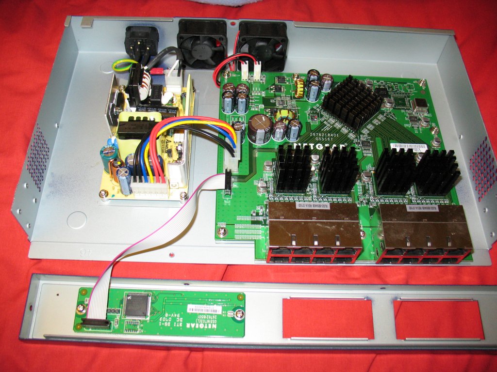

    Peek inside a Netgear GS516T
    You know it's bad when you take apart a brand new $300 switch before you even power it up for the first time

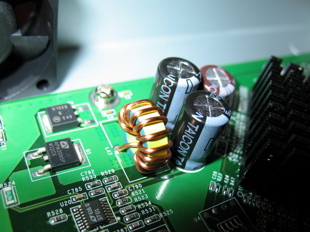

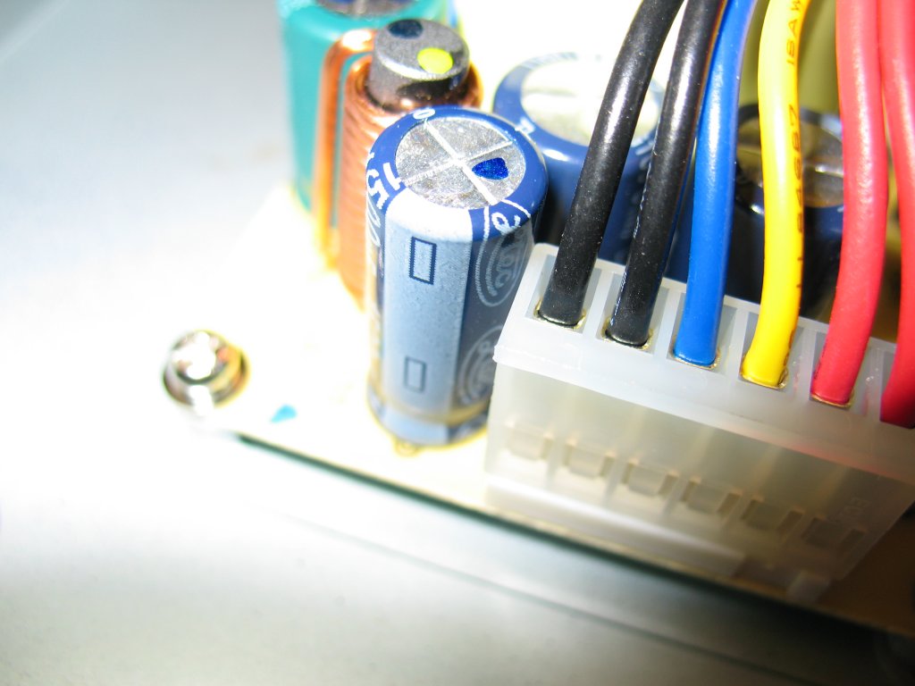

    Taicon, Nichicon, and some other cap I can't make out the logo on.
    Delta power supply with cheap caps...
    Looks like they didn't mess around with the fans though, so it should run cool.
          That cap with the logo looks to be an Ltec cap. Ltec are sometimes used In Delta PSUs for desktop PCs.
          They can be bad caps sometimes though. Personally I haven't had a bad Ltec cap in my PSUs so far.... I don't know for how long though.

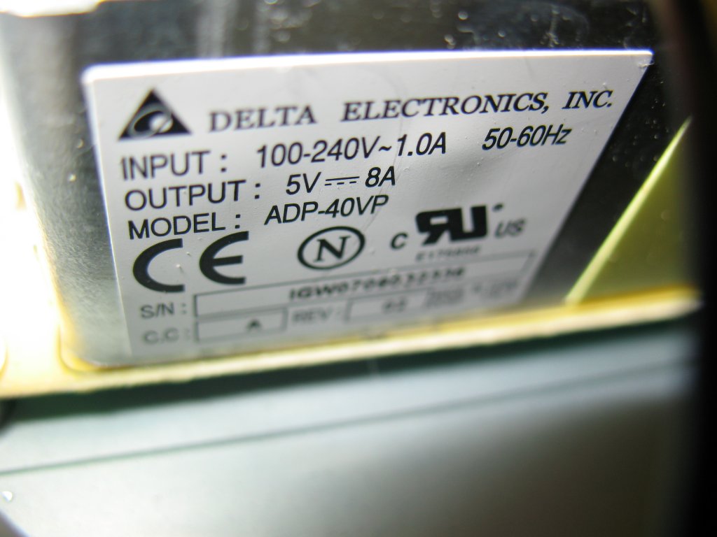

            Interesting. The Delta P/N, "ADP40", means that it is a 40W adapter, i.e. normally an external P/S in a black plastic case. The lack of an O/P inductor (ignoring the ferrite rod inductor, which is for filtering high-frequency spikes) indicates that this probably is a flyback or "ring-choke" (Delta's terminology) design, where the the transformer primary is the "O/P inductor". The topology saves space - no big O/P inductor - and also can handle a wide-range input voltage (no voltage selector switch). It looks like the Ltec cap is after the ferrite rod inductor and thus probably isn't handling that much ripple current. My guess is that the ripple current is handled by the two blue lytics near the O/P connector. Looks like a fairly beefy bridge rectifier on the primary side next to the switch device.
