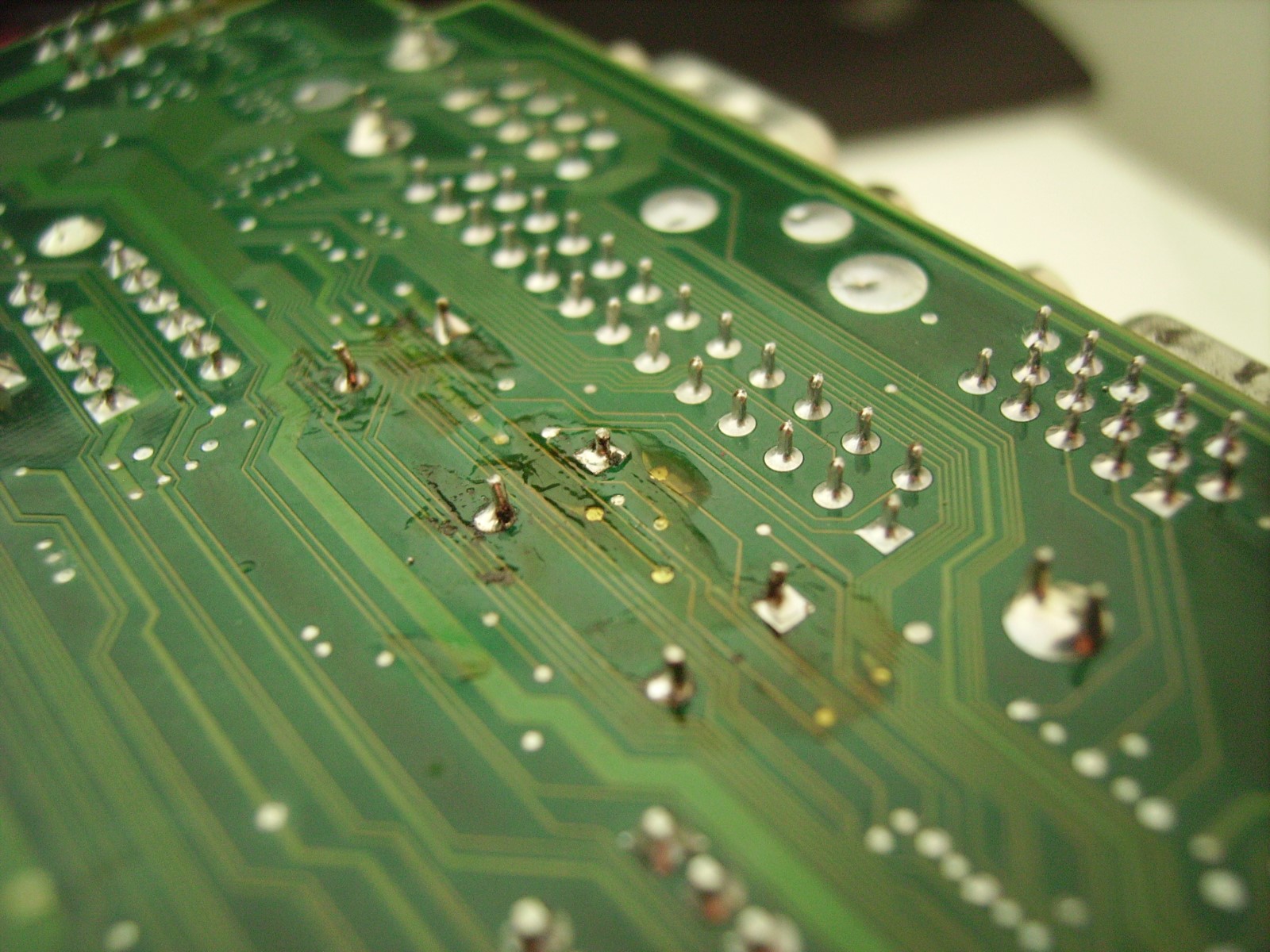

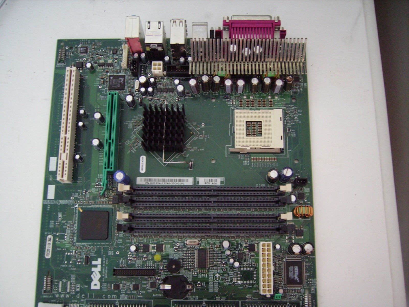

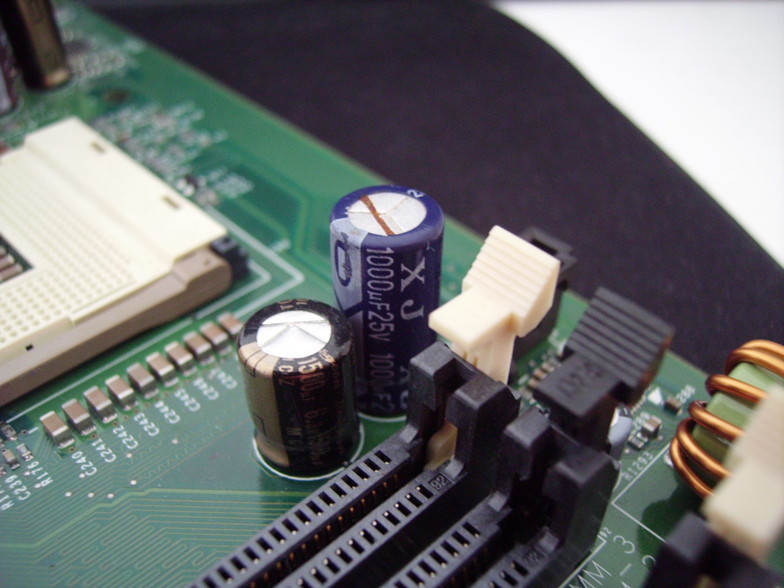

    Another poorly done recap job
    This time, it's a GX270. It's not as bad as some of the others I've seen on this forum, but there's plenty of room for improvement. This PC is from a business client of ours, who needs it to drive some older equipment...

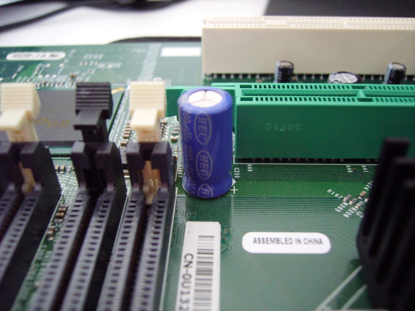

    The board. Note the mis-matched caps all over the VRM low. The originals were Ruby MCZ (one of which is still leaking), but guess what the guy who recapped it used as replacements...
    Yup. KZG.

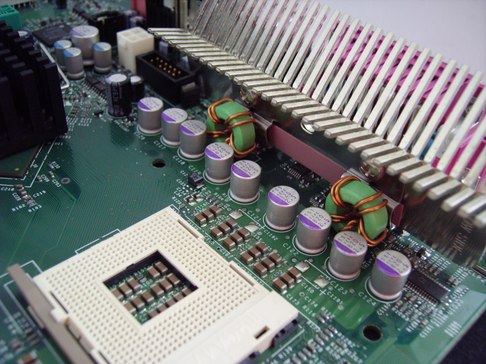

    And it's no better elsewhere. not only do we have cheap generic Chinese caps, but GP caps at that.

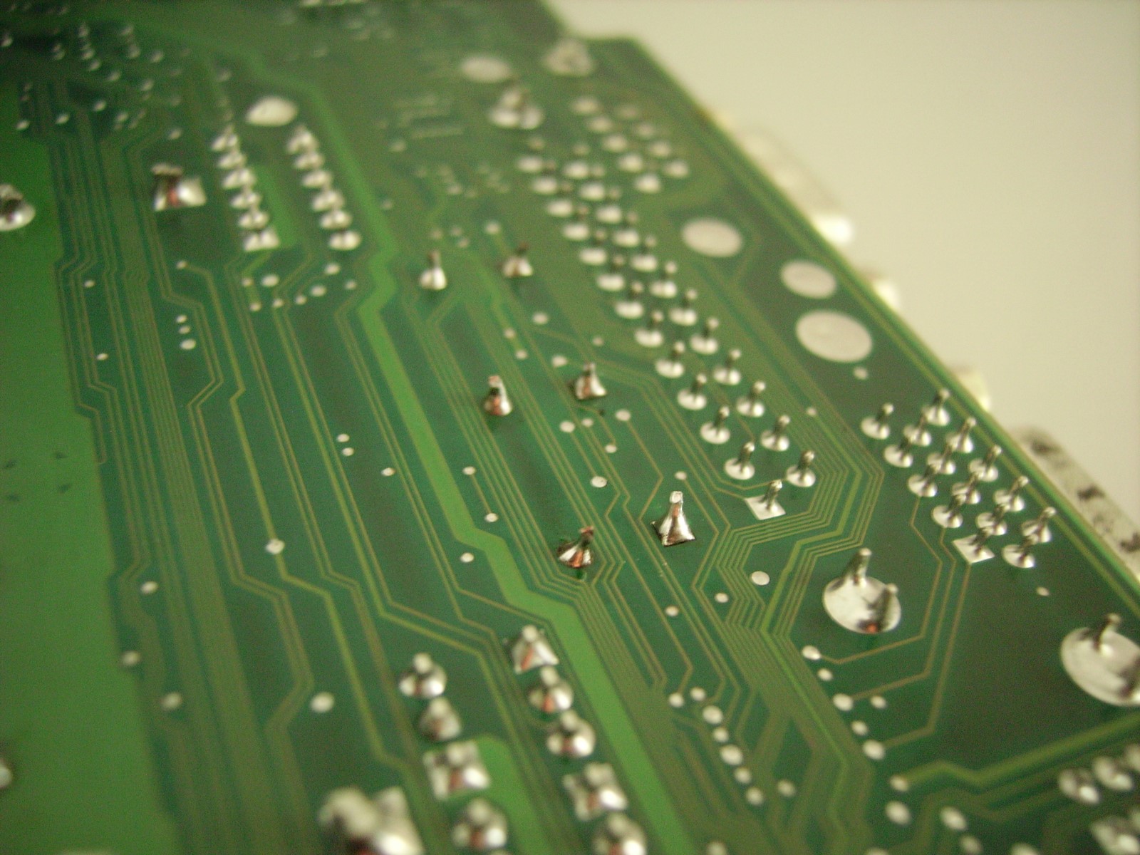

    I've seen worse soldering than that, but at least clean your flux of, guys...
    I'm thinking I might give this one a partial polymod. These PCs often cook Rubycon caps, so I think it's about the only way I won't have to re-do it eventually.

      Re: Another poorly done recap job
      Yeah, the soldering isn't too bad. It was more the fact that they used such low quality replacements (and possibly even left two caps bulging). It looks a lot better now that I've polymodded it.

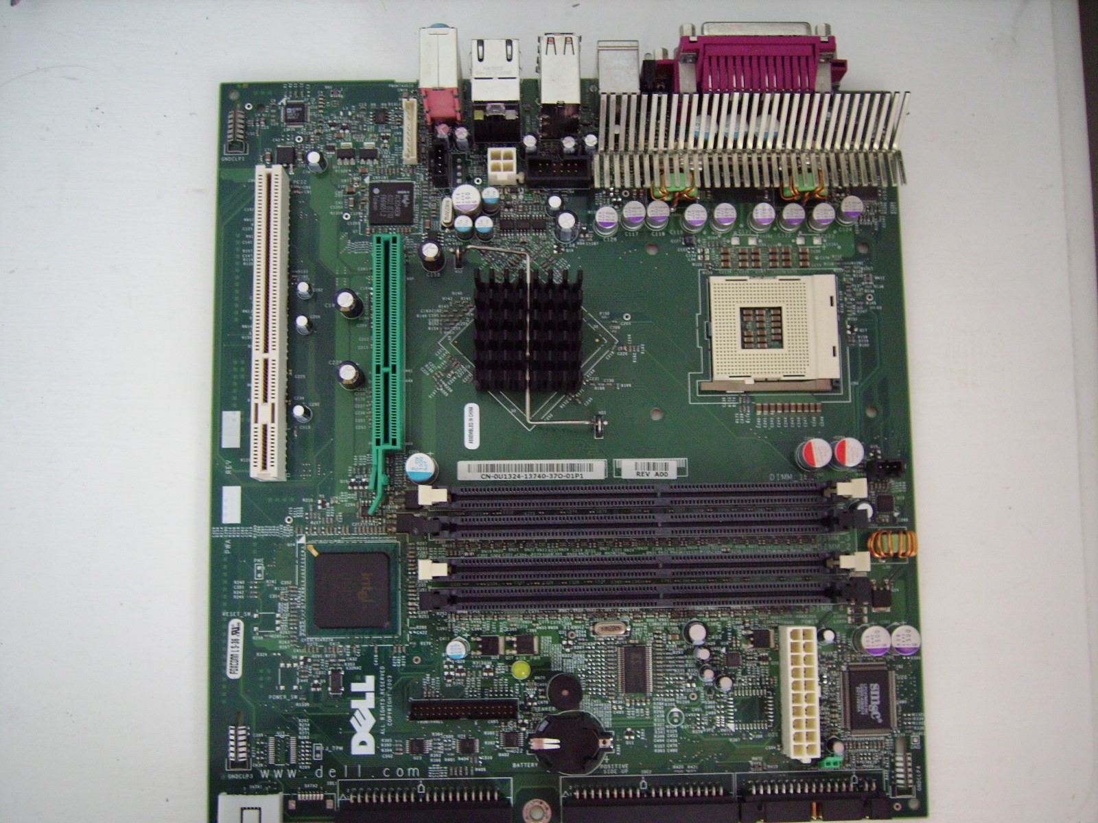

          That's pretty much what I've found. They seem to last darn near forever, as long as they don't cook the caps.
          EDIT: I just realised in that 3rd last photo that I missed an 820uF nichicon HM. It wasn't bulged but was from the defective era (2003 dated). The replacement was a Ruby MBZ.

                Originally posted by BigTroll
                i have never once seen a 270 have bloated cpu caps if they are panasonic
                I've seen a lot of them, as well as many of the Dell toasters (SX270, SX280, GX620/520/745/755 USFF) roast pannies..... Pannies are tough, but not indestructible!

                  This. Panny FJs do seem to hold up better than ruby MCZs in these PCs, but they can still fail. The first one to go is usually the one in between the DIMM slots and AGP slot (probably because the two MOSFETs next to it get hot enough to discolour the PCB under it. The UCC PSC Poly I put there should handle it, though.

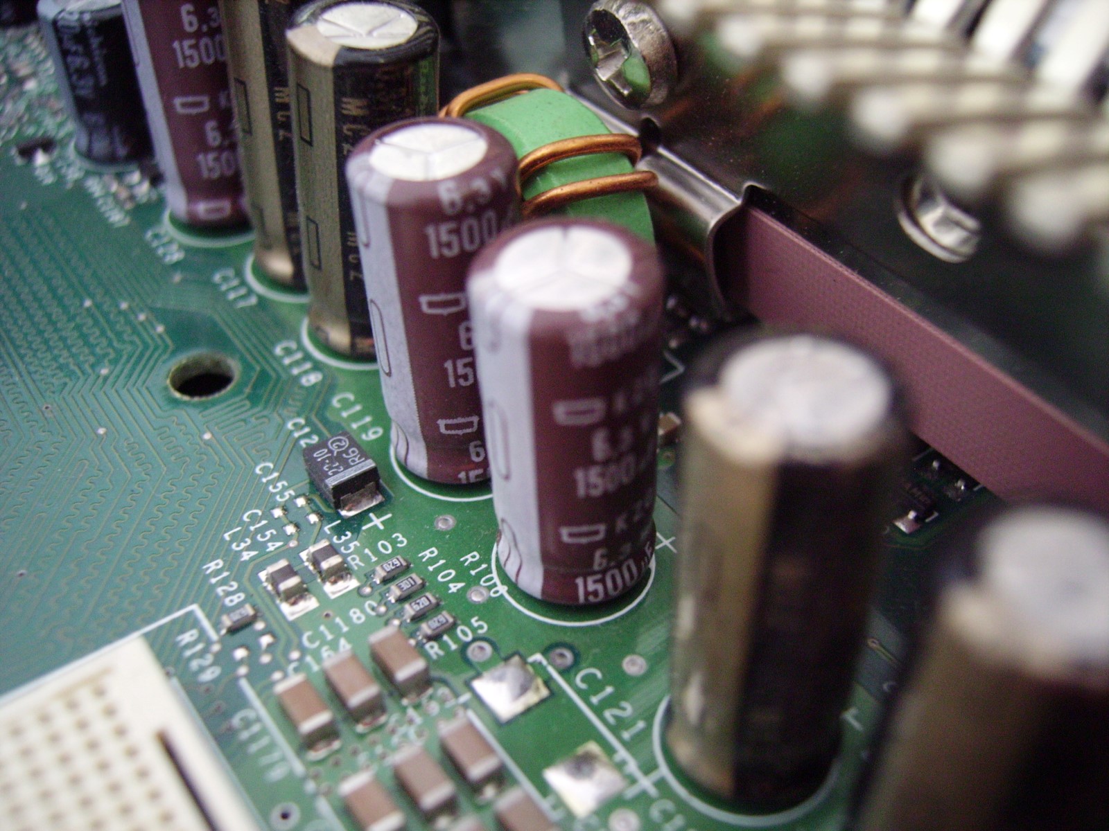

                    Has something been pulled off C121 in pic 2, or is that just where the soldering iron has disrupted the solder on an empty pad?
                    Dell E7450 | i5-5300U | 16GB DDR3 | 256GB SSD
                    • c_hegge
                      • Sep 2009
                      • 5219
                      C121 was never installed in the first place

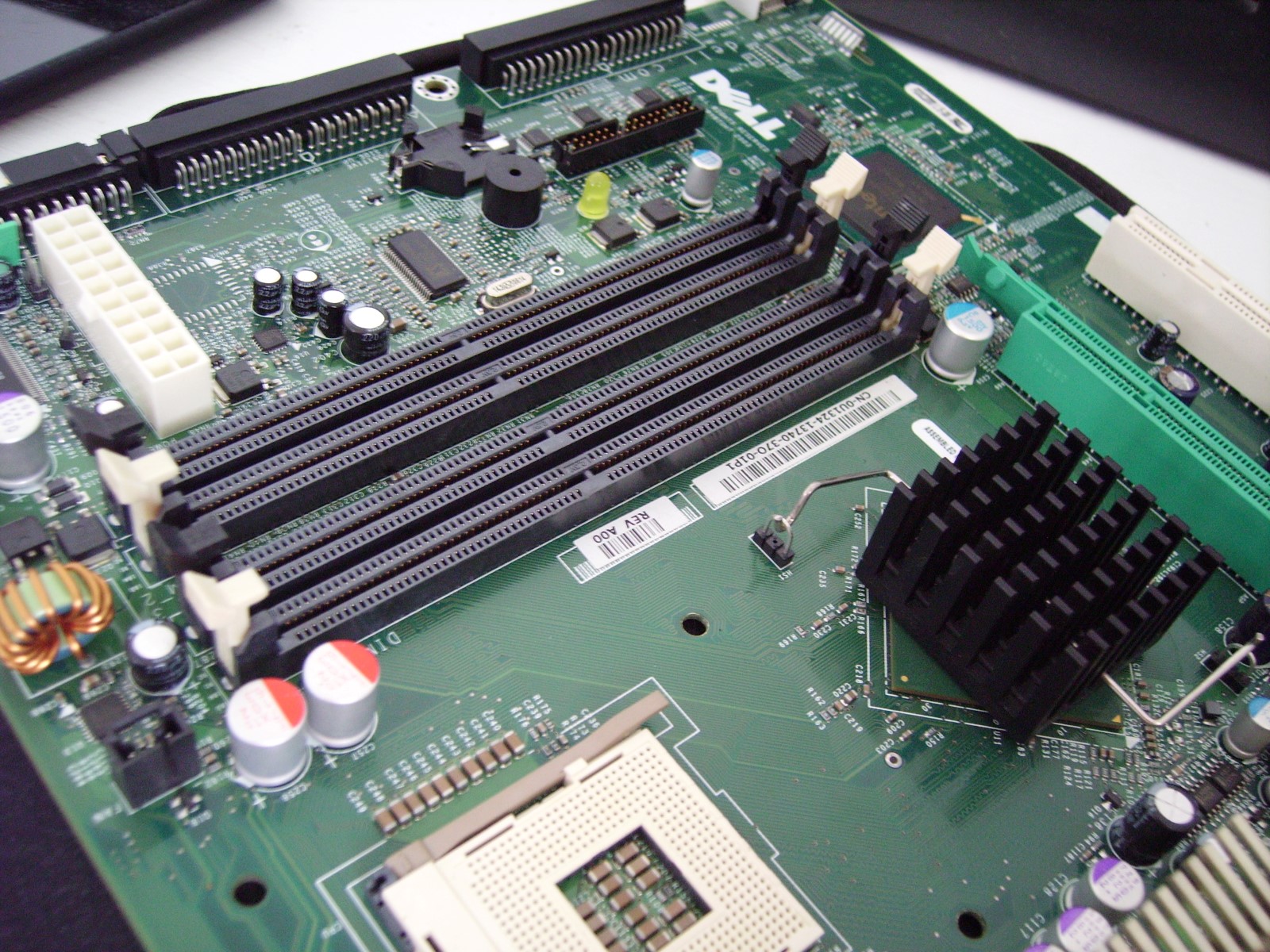

                          • cheapie
                            null
                            • Jul 2010
                            • 849
                            What's the green slot? Doesn't look like PCI-E, and I thought AGP was always brown?
                            • shovenose
                              Send Doge Memes
                              • Aug 2010
                              • 6575
                              Seen green, orange, red, blue...
                              • Topcat
                                The Boss Stooge
                                • Oct 2003
                                • 16958
                                AGP.....Dell has to be different....but I've seen them all kinds of rainbow-like colors...
