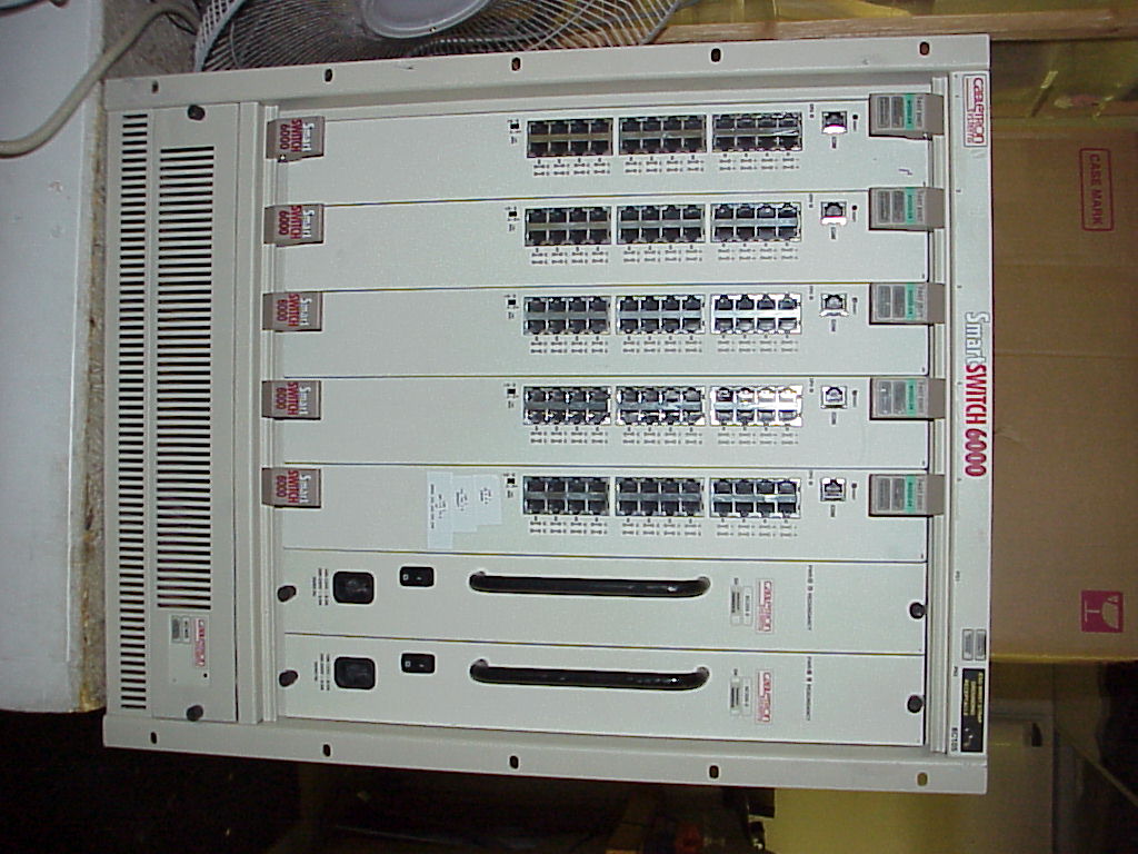

                            or if you really want to go overboard i have a cabletron/enterasys 6000 with 3 24 port cards and dual redundant psu's.
                            it would have to go ups hundredweight!

                                Re: LAN cables
                                i lied
                                it has 5 24 port cards!
