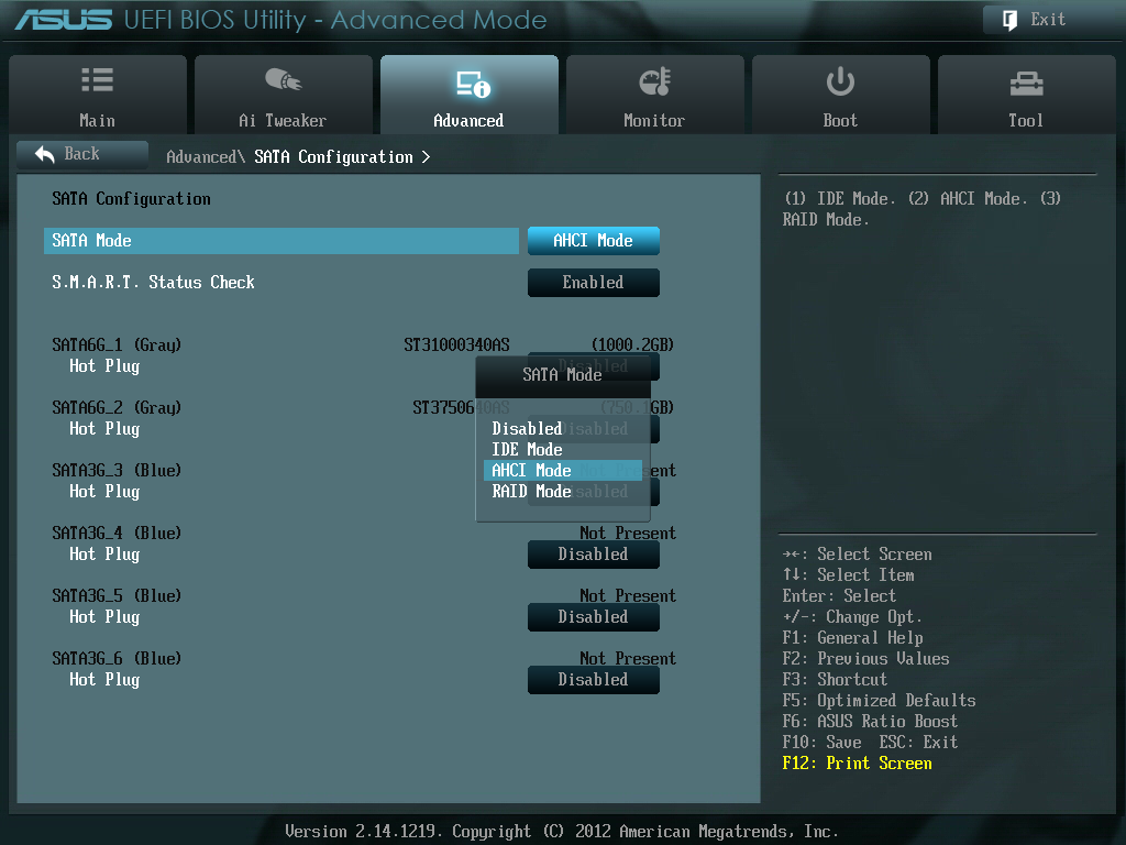

                                    Re: The Boss Stooge and a new HTPC
                                    Originally posted by Topcat
                                    ... It will only need one small HDD for the OS, so a SSD would be my desire, all media files are stored on a server.
                                    SSDs are so cheap now that anything smaller than 120~128GB ain't cost-effective. For just HTPC OS I'd get something unexpensive like a Crucial M500 120GB. Create a partition of just 64GB for Se7en, so that there is a ton of unpartitioned space for overprovisioning and the IOPS remain always high (you can always extend volume from Se7en disk management in the future if you ever ran out of space).
                                    Or if you need the current best, Samsung 840 Pro 128GB.
                                    Don't forget to set SATA mode to AHCI in BIOS prior to installing Se7en.
                                      ...and also install the intel RST driver, even if you're not using RAID. Other lise, at least for me (with an SSD), you'll have a crash-o-holic upon wake form standby.
