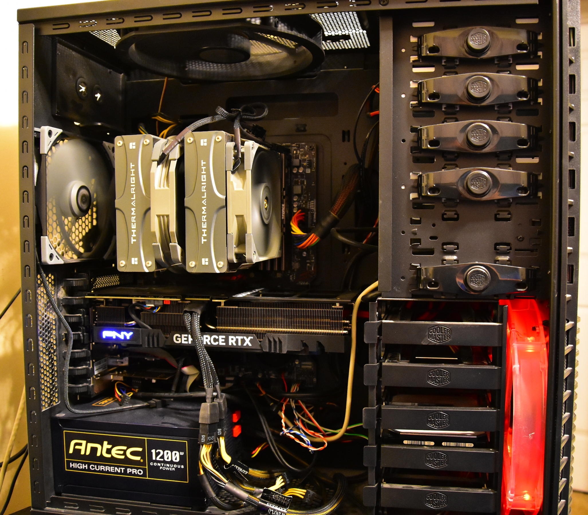

          The only wraith cooler worth a damn is the Prism but even it isn't really sufficient for the higher end CPUs it is bundled with, the wraith stealth and spire coolers are utter garbage (fall into the "better than nothing" category, but just barely), and can't even keep up with the 65W TDP CPUs without throttling. You certainly can effectively cool a 5900x/5950x with air, but it takes a pretty big cooler to do it.
          I'm currently running a ThermalRight Frost Commander 140 on my 5900x and it has no trouble keeping up (stays at 75C or below even after hours of running at full load, and below 50C under most "normal" loads) but this thing is a beast and while that isn't an issue in my Cooler Master HAF 932 case (also a beast), it could certainly pose fitment issues in many cases.
          Click image for larger version  Name:	DSC_0776.jpg Views:	0 Size:	2.35 MB ID:	3221108
          Click image for larger version  Name:	DSC_0778.jpg Views:	0 Size:	2.33 MB ID:	3221106
            • 31009
            i have a similar cooler but dont like them,
            no science to back it up, but i'm sure all that mass puts a lot of stress on the board and may bend it eventually
