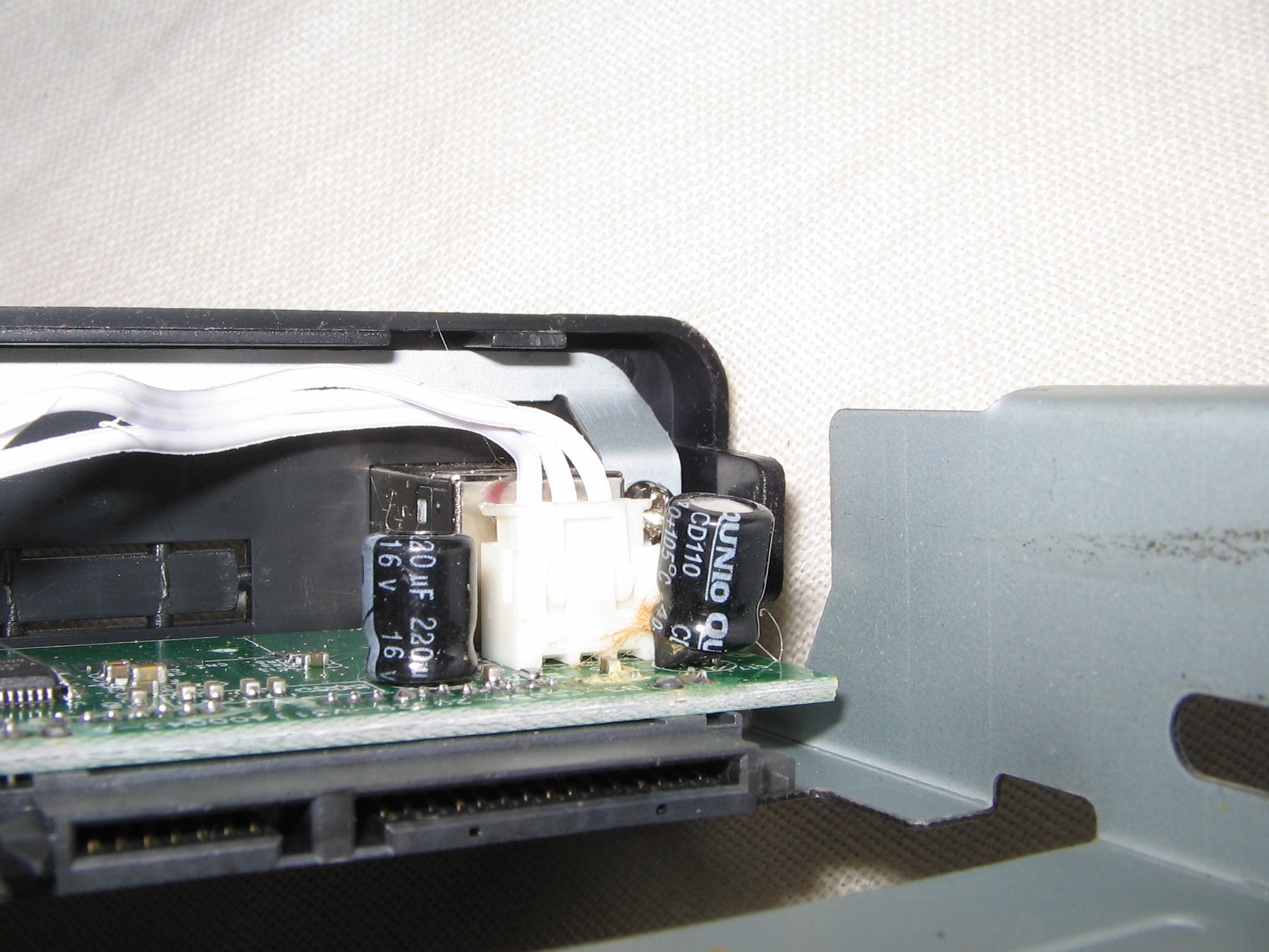

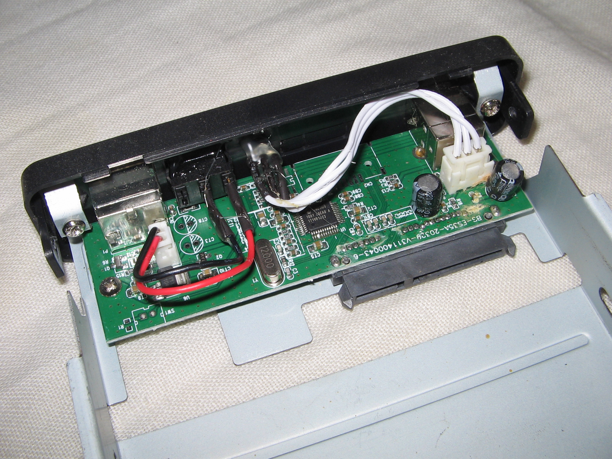

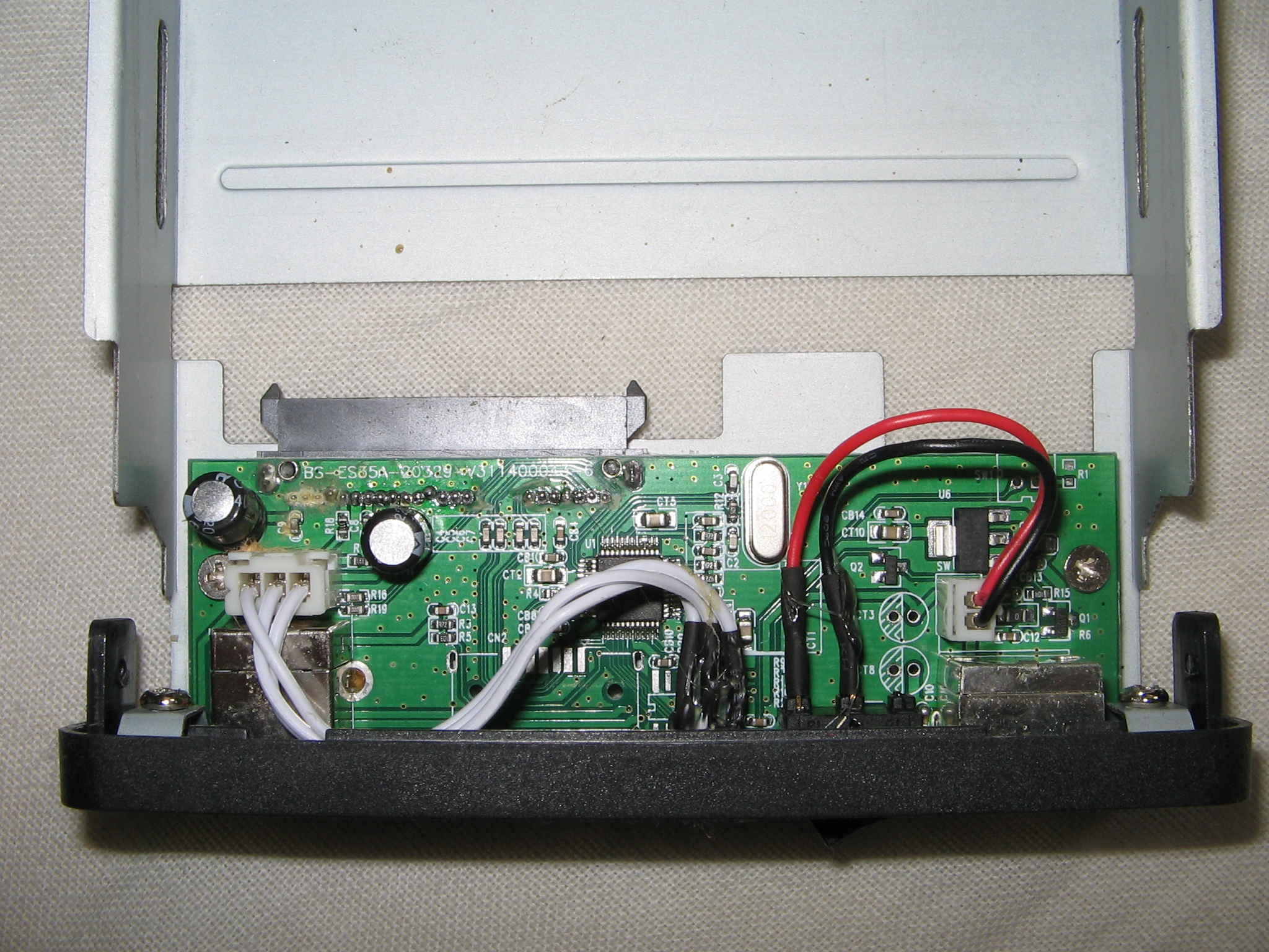

    What caps were installed ?
    Sorry! Here you go...
    Capacitors are "Qunio" series CD110 - Never heard of them.
    The one near the USB connector vented out the bottom on both cases.
    (Not sure where it connects electrically)

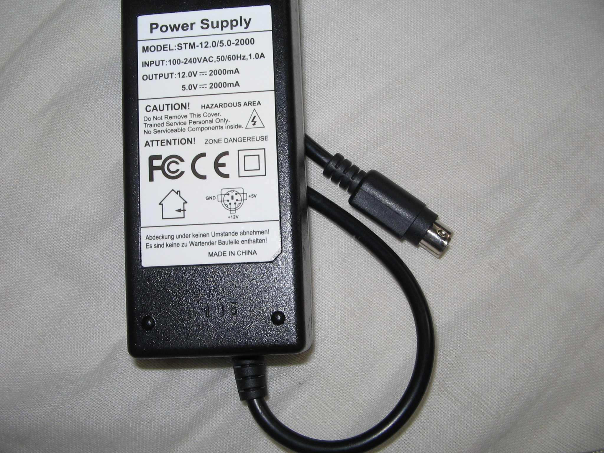

    Unsure what caused the failure. May have been PSU, although voltage tests OK on bench without load.
