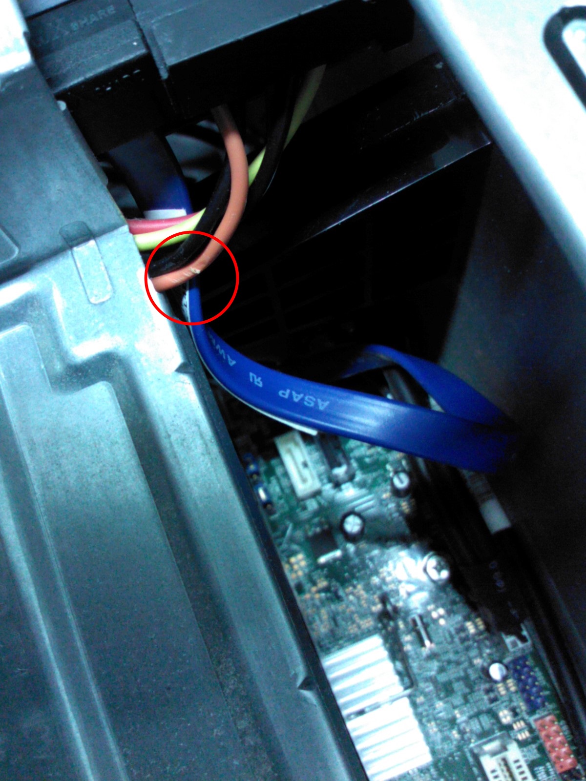

    So, I had to fix up a Dell Studio XPS 8100 desktop PC the other day. Among other things I had to clean out the dust and after pulling off the side panel, a somewhat disturbing design flaw caught my eye. The PC uses a Radeon 5770 Gaphics card, and has a steel bracket which screws to the case near the HDD bay to hold it in position. The wires for the HDD's SATA power connector run right under it, but unfortunately, the bracket doesn't have folded edges, and had chafed the wires . I covered the edges of the bracket in tape before putting it back together.

    Yeah, the edges should have been folded or the like. Whoops.
    I personally would have filed the edge smooth with a needle file but tape works too *comes from the guy who used to own a shuttle XPC with a drive caddy covered in tape, due to it shorting a large TV tuner card*

      ...and these sharp edges are even cuting people hands! Many times it happend for me, that the computer I building took some more of my blood as sample...

        While at Delta I removed and installed a P/S in an Apple drop-side case quite a few times, and got sliced more than once.
        BTW, I would not recommend using a file to deburr edges in a computer case. Metal particles being circulated around the computer case by the fan might not be a good thing.

          Foam weatherstripping tape makes nice padding, doesn't look too shabby either. I remember the 1st time I bought a quality case (Antec) back in the day. I did not even have to wear gloves.
              That's why you clean up your mess when you're done.. Handi-vacs and magnets are good for this. I've metalworked cases before, never had an issue.

                An easy way around that would also be to remove the bracket from the case before filing it. In this case, however (pun intended) I didn't have a file available, so duct tape had to do.
