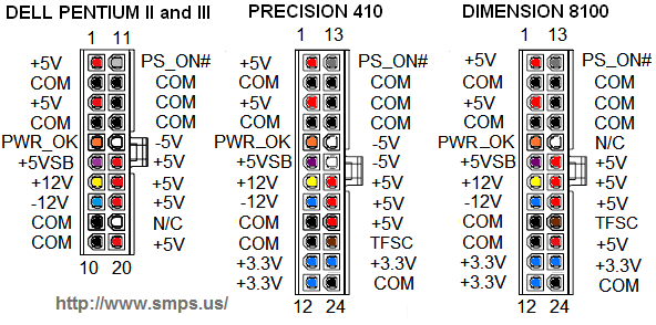

      • larrymoencurly
        • Oct 2004
        • 960
        Re: Busted Pentium 2 Power Supply?
        Here's a couple of diagrams of nonstandard Dell power supply motherboard connectors and industry standard ATX connectors. Notice that nonstandard Dell PSUs have blue-white wires for the +3.3V, not the usual orange wires, and on those nonstandard Dell PSUs the orange wire is for Power_Good status. I don't know when Dell switched to industry standard ATX PSUs, but their Optiplex GX260 uses standard PSUs, and it goes back to around 2002-2003 (Pentium 4, separate 4-pin 12V plug for CPU power, no SATA ports)

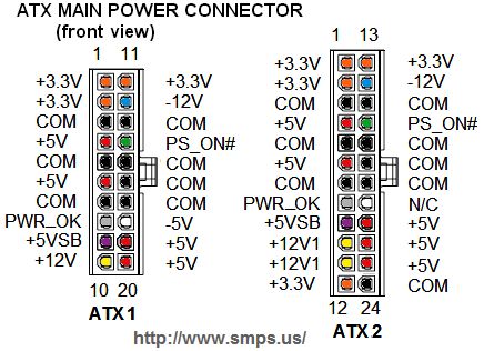

        • LDSisHere
          • May 2012
          • 727
          • U.S.A.
          If the attached PDF matches your motherboard it looks like it uses a standard (older) ATX connector / power. Your motherboard may have been damaged when the original power supply went bad. Some good quality pictures of the board would help in the troubleshooting if you want to try to get it working again.
            All of the wire colors matched on both ps's I tried so I don't know.

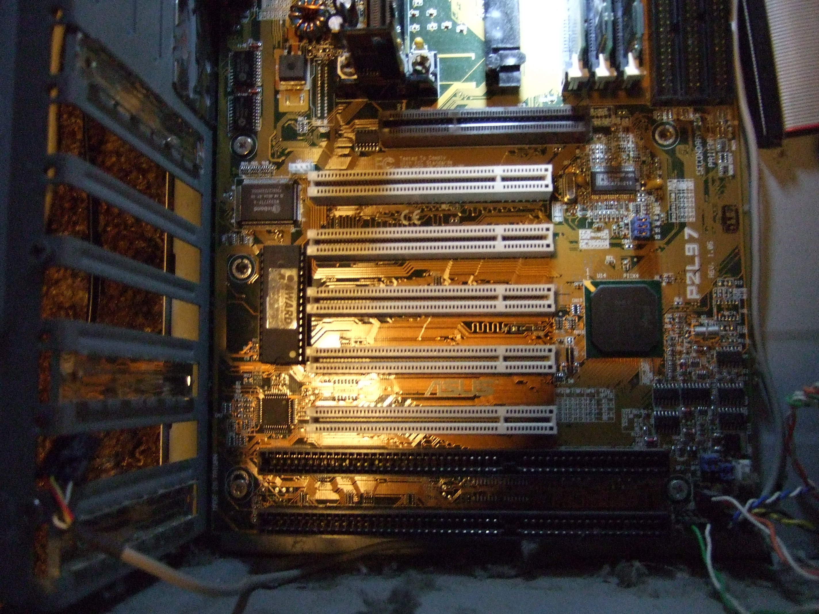

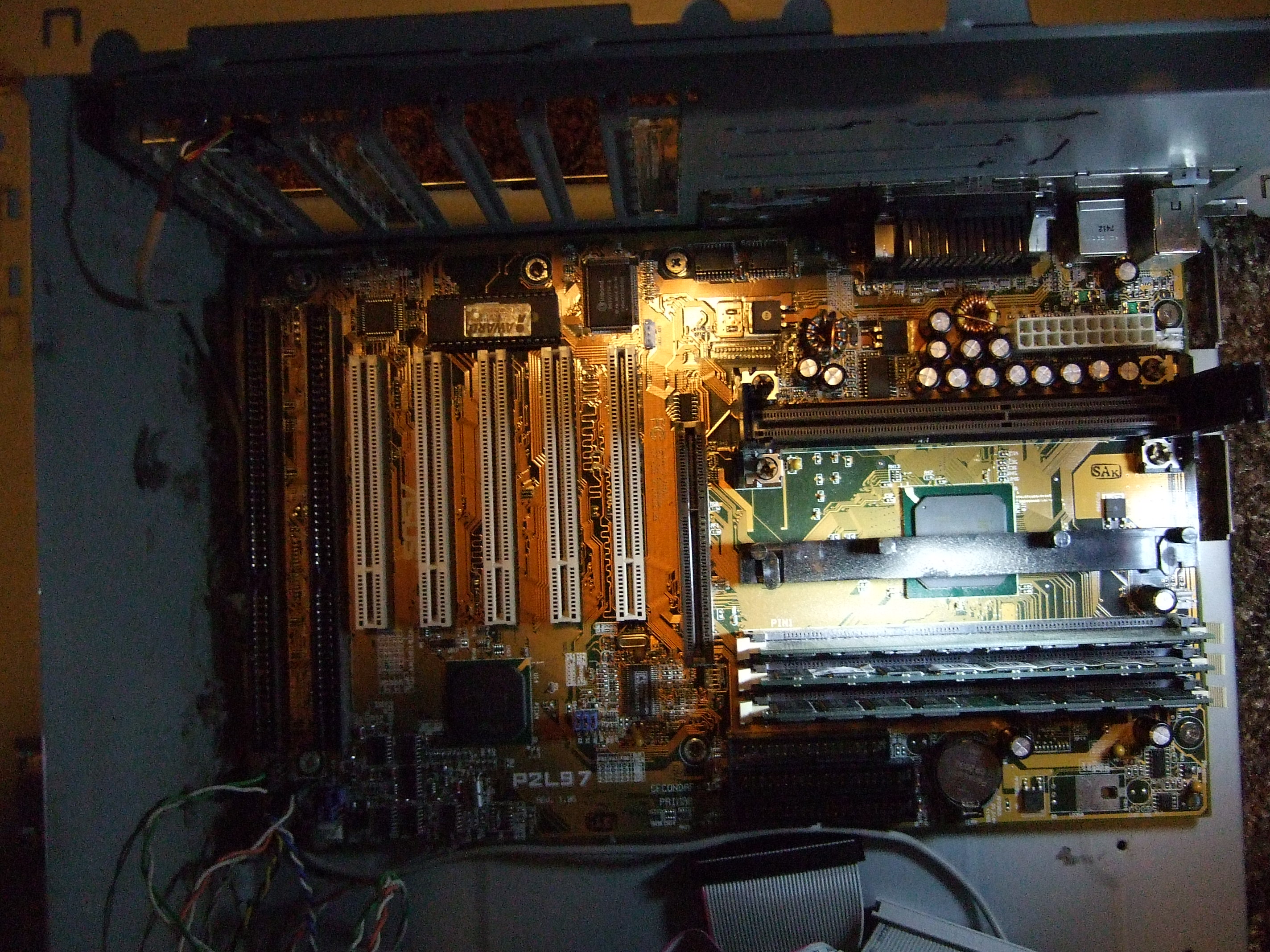

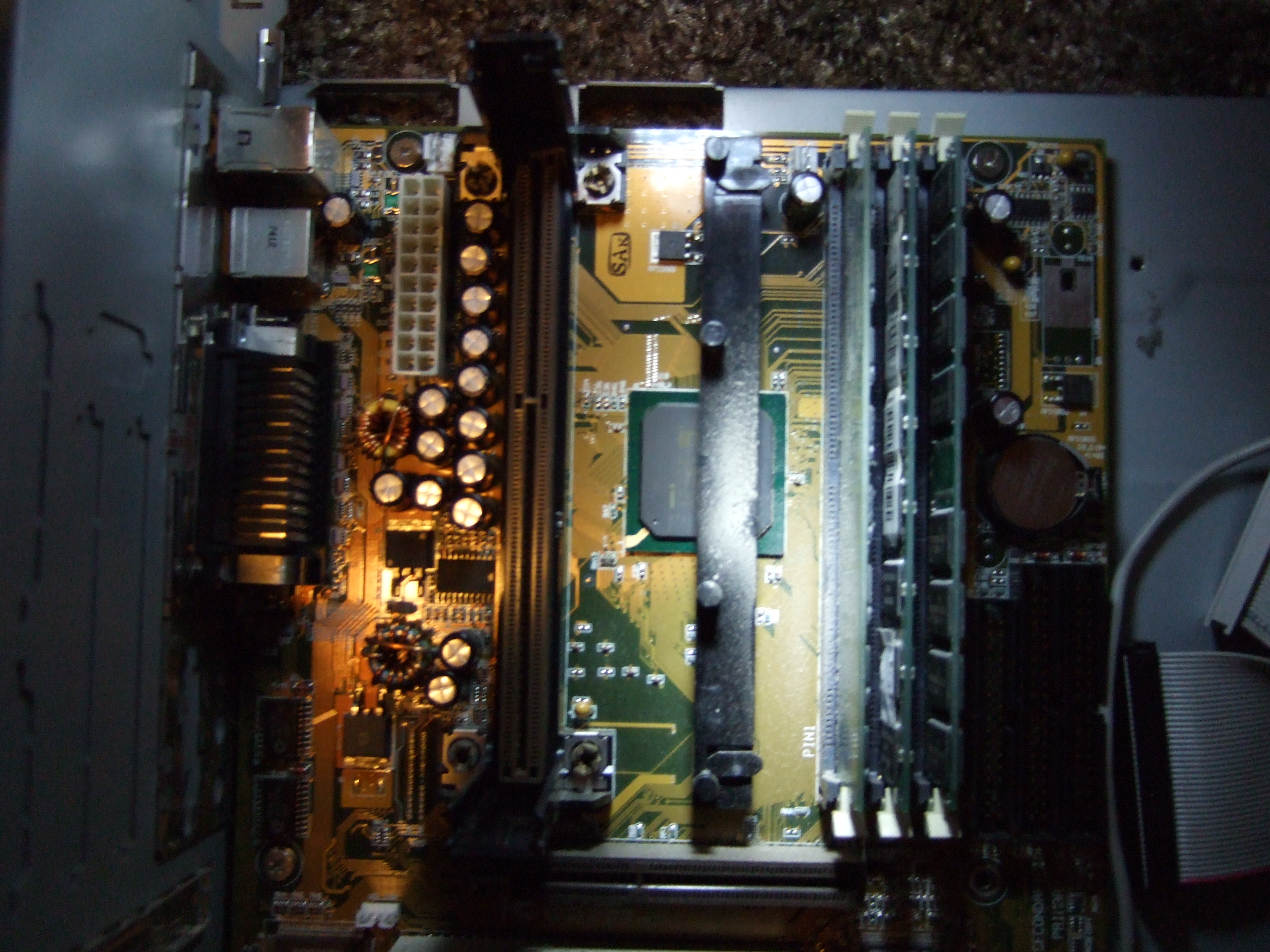

                  My board is a little different than the one described it also says Rev. 1.05 on the MB.
                  Here are some pics sorry if their not good enough I can retake.
                  canadaboy25
                  canadaboy25
                  -Sometimes the light at the end of a tunnel is an on-coming train
