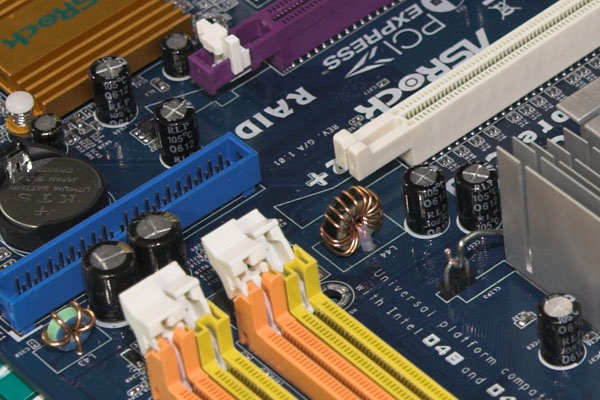

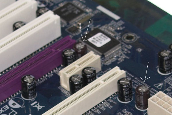

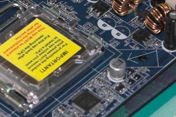

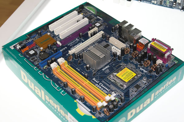

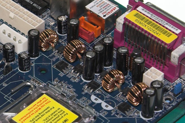

        well i would say the best mobo for intel would be an intel original board.
        i saw this asrock board at an exhibition during oct/06 and it was using Panasonic ??, Ost RLP, Teapo and a Nichicon?
        teapo?
        nichicon?

            My Asrock 939Dual-VSTA has Chemicon, Panasonic, Sanyo, and OST on the board. I'm happy with it so far

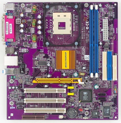

                                With GigaByte, you can get a decent board with good caps or total crap with GSC and Choyo.
                                I'd say that ECS is better than ASRock. Some ASRock boards have really stupid design mistakes - such as powering P4 CPU from 5V rail or using a linear regulator with underrated transistor (runs hot and simply dies after some time) for powering the chipset and DIMM.

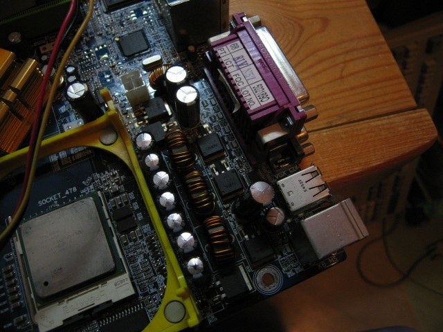

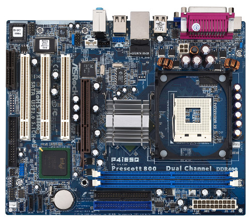

                                  I have two choices of motherboards now.... This is because these are the only socket 478 boards my supplier sells now.
                                  Well they have the ECS 661FX-M and Asrock P4i65G motherboards in stock and i think thats about it.
                                  The ECS 661FX-M is based on the SiS 661FX chipset and the Asrock one is based on the Intel 865G chipset. The ECS one uses OST caps i think and Asrock uses a few Chemicon caps.
                                  Can someone help me identify what caps are around the CPU in the Asrock board?.... They look like OST caps.
                                  Someone help me choose a board.... hard choice....
                                  I don't know which is better? Asrock or ECS? or are they just practically the same?
                                  Heres the site if that helps at all....
                                  ECS: http://www.ecs.com.tw/ECSWebSite/Pro...uID=45&LanID=0
                                  Asrock: http://www.asrock.com/mb/overview.as...P4i65G&s=Intel
                                  I have enclosed some internet images of the boards.... hope that helps also.
                                  Thanks.

                                      I'm skeptical about the claim that the Asrock is a dual-channel board. It may use the 865 all right, but the DIMM slots are spaced too close together to have permitted routing both channels to the slots. I'm guessing that it's a single-channel, 2-slot board. I've also seen an MSI 865 micro-ATX board that uses this configuration.
                                      Other than that - I'd probably go with the Asrock and recap it before use.
