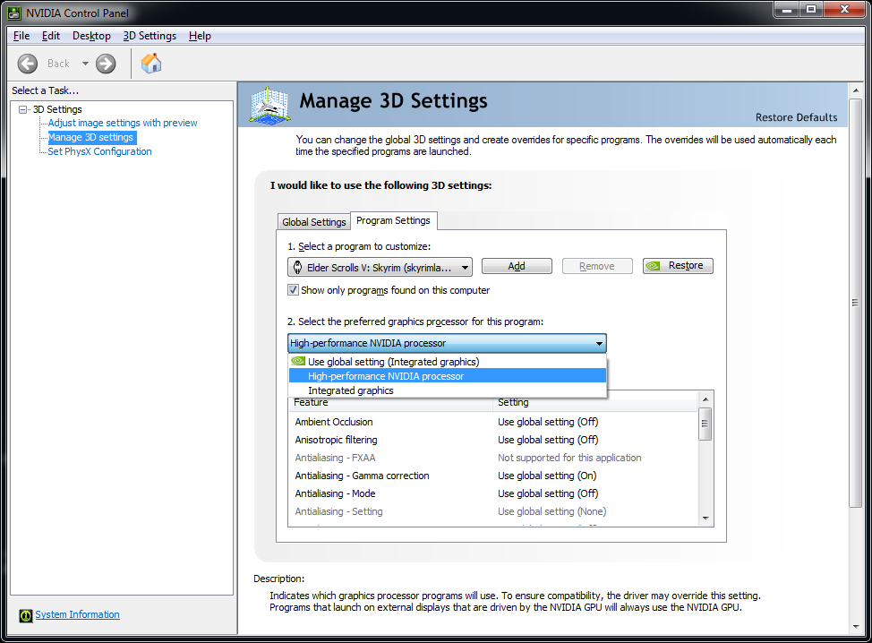

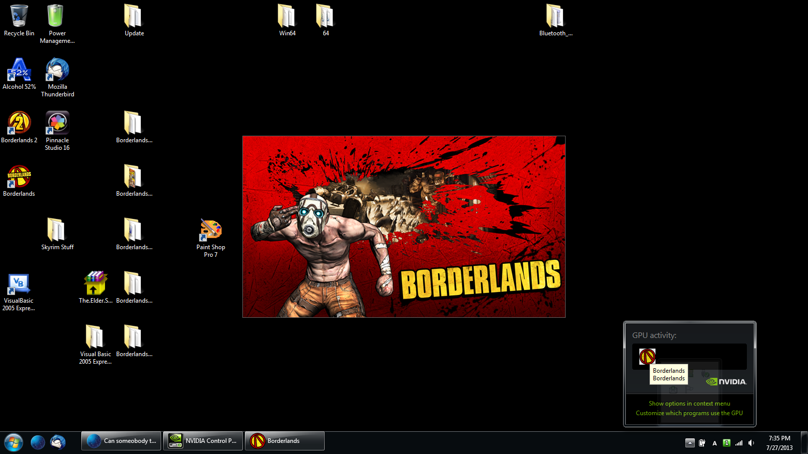

                    Re: Can someobody tell me WHICH graphics I have on my laptop????
                    actually its done through then nvidia panel. You can literally accelerate an open window to nvidia while having the intel gpu run explorer.
                    you can choose which programs to to use nvidia or intel. There are plenty of profiles that will switch the nvidia gpu on. I ran skyrim two nights ago on high settings it and it ran beautifully on this GT730 (about equal to a GTX 285 desktop)
                    a little icon also lights up on the system tray if a program is running on the GPU. Here are some pics of the control panel with Optimus.
                    sorry about my desktop, I just moved in, haven't gotten everything unpacked and its just a mess
