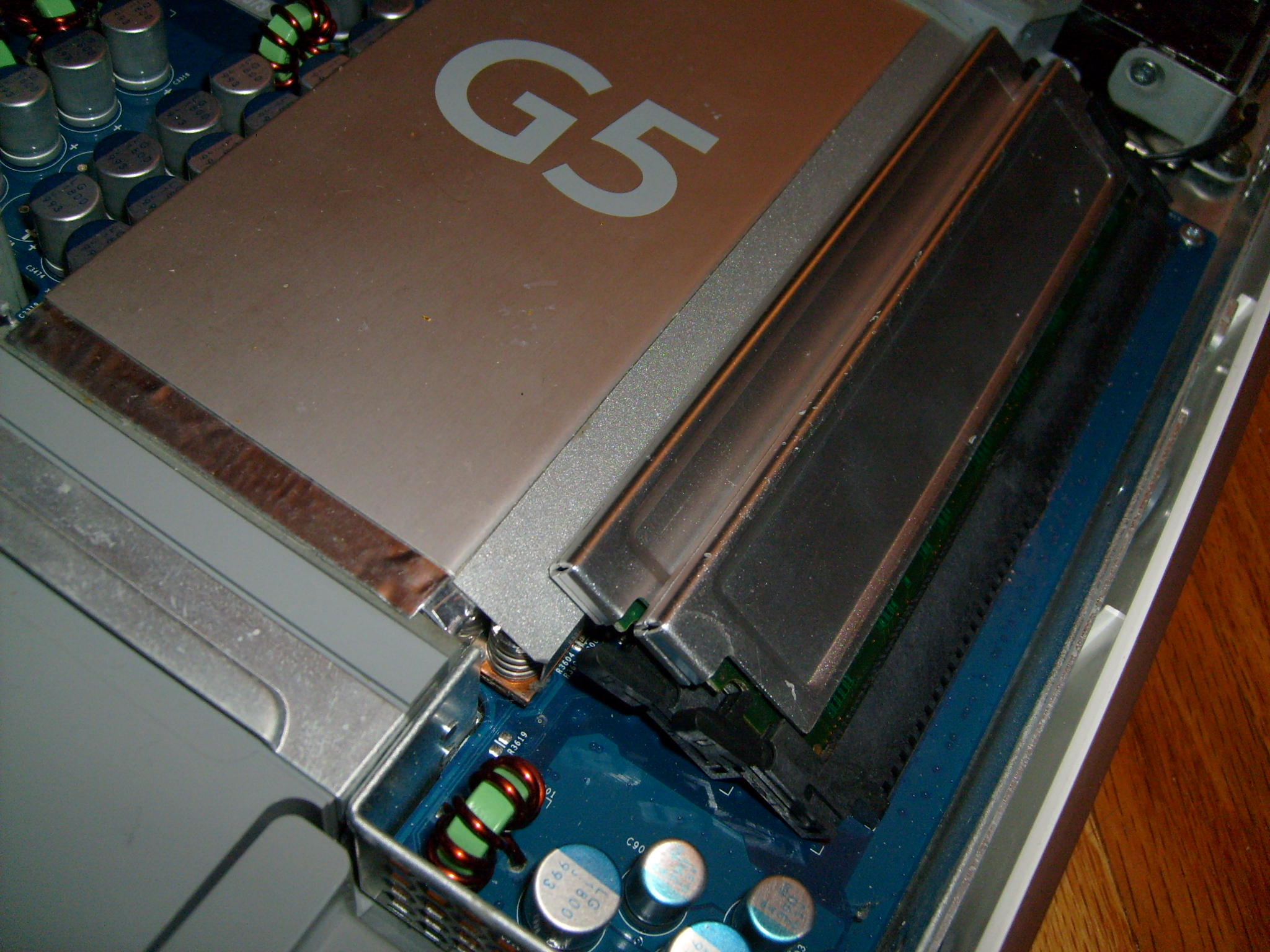

    Yesterday my fresh (to me) RAM for my gen 1 Imac G5 came in... 2x 1GB of PC3200... however, it's heatsinked super talent gaming ram (got it for cheap, what the hell). I figured the heatsinks/spreaders would help given the G5's piss poor cooling... but..
    It was a VERY tight fit. It barely fit... the heatspreaders are touching eachother and the inner one is also touching the CPU heatsink.
    The system sees and seems to like the RAM... but does the tight fit nullify the cooling effects of the heat spreader? Would I be better off finding a mate for my 1gb PC3200 kingston module that came out instead?
    I'll have to get a picture...

    I thought the low power levels of those RAM chips and their high temperature ratings (85C) made heatsinks completely unnecessary, and heatsinks are put on retail memory modules only for marketing purposes and to cover up the fact that the chips are no-name or overclocked. XbitLabs.com and APHnetworks.com have taken the heatsinks off some modules to reveal that fact, but in the process they sometimes ripped chips or copper traces from the circuit boards.
    Many years ago, I found that about 8 out of 13 Kingston 512MB PC3200 modules had defects, and about 1-2 years ago I got a defect rate of about 30% with Corsair 1GB PC3200 modules.

      My understanding was that the use of heatsinks was to allow easier overclocking by the end user... the RAM seems to work OK and all. I also got some 512mb OCZ PC3200 sticks as well in the shipment, also heatsinked.
      It should be safe to use, right?

          Heatsinks have almost nothing to do with overclockability and a lot to do with marketing because it's cheaper to slap on fancy heatsinks and use untested or overclocked chips rather than use branded, guaranteed chips of the advertised speed rating.
          I haven't done much checking, but the highest operating temperature spec I've seen is 95C case temp, if the refresh rate is doubled. Otherwise 85C is the max
          Back in 2006, Corsair tried different heatsinks on a Corsair or OCZ DDR module run at 3.4V and 2-2-2-5 timings in a 68F (probably a misprint for 68C) test chamber, and the best heatsink allowed only a 1.6% faster speed than no heatsink:

              I don't think that's what's being implied. That RAM is good quality; just because it has heat spreaders doesn't mean it's crap. The heatsinks are more commonly referred to as heat spreaders for a reason - they spread the heat from the little RAM chips to a large surface area. They don't really cool the chips that much more. However, in low airflow situations I doubt they make a huge difference, but they also won't make it worse.

                So my ulitmate question is: if the heat spreaders are right against eachother and a CPU heatsink like so:
                is the fact i'm using ram with heatspreaders helping or hurting me?

                  Helping you.

                    Personally the only concern I'd have is whether they're putting pressure/stress on the sockets, I don't see an issue if they're just touching though.

                      I say you have to test it like crazy with both MemTest86/86+ and Gold Memory, running each for at least 2 hours, preferrably in at least 2 different types of motherboards. About 10% of the modules I've checked that had heatsinks or unbranded chips were defective, but I've seen only one bad module with prime quality chips and no heatsinks. Actually that module may have been OK, but I refused to run it because it made a crunchy sound when I plugged it in, and it turned out to have solder on 2 of its gold contacts, and a sliver of solder probably fell out of the DIMM socket.
                      Those 1GB Corsair DDR modules I bought were rated 3-3-3-8 on their label but 3-4-4-8 according to their SPDs. I couldn't find any DDR chips as slow as 3-4-4-8 at Micron or Samsung, leading me to suspect they were made from failed 3-3-3-8 chips.
                      Those heatsinks on your modules are making no difference at all. I've tried heating up DDR2 and DDR3 modules during testing by covering them with anti-static foam sheet, but they stayed below 70C. The sockets seem to tolerate the modules having some side pressure on them because I had a DIMM socket that was sensitive to wiggling and would make the computer freeze each time the DIMM was touched, but it turned out a piece of lint was stuck to one of the socket pins, and after removing it I could wiggle the module quite a bit without causing MemTest86 to report errors.
