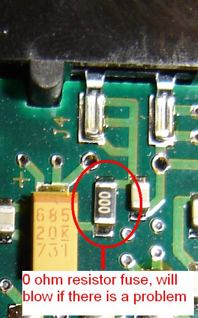

    Somebody was telling me there are some fuses on the motherboard... if there is I don't recognize them, and that sometimes this is what causes a motherboard not to power up even after recapping, is this correct?

    They are surface mount, usually green in color, and are prefixed with 'F'. EX: F101 might be the marking on the motherboard for it. I'll try and get a pic of one next time I'm at the shop.

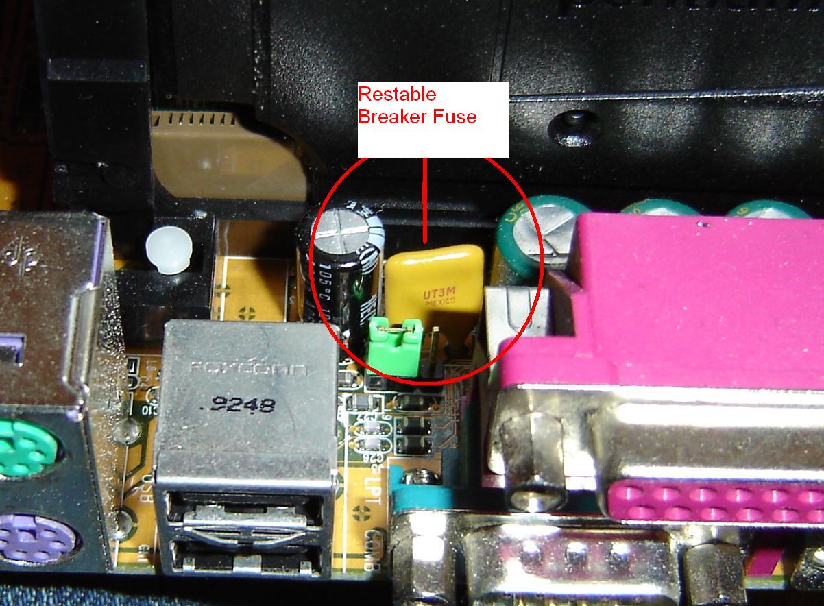

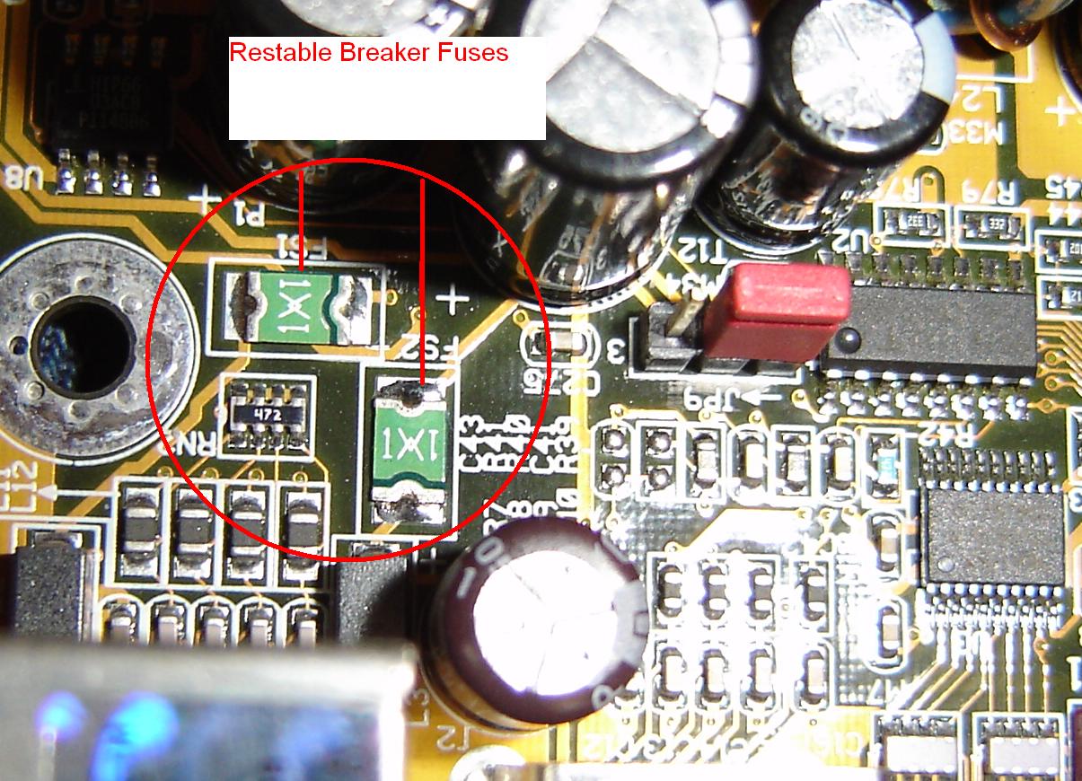

      There are some through-hole polyfuses for the keyboard, mouse and USB. They might be grey, beige or similar in colour, and look like a 1/4W through-hole cylindrical resistor in appearance.

          And no, they don't cause the board not to work. However, they can cause the keyboard, mouse, USB or game port not to work.

            Well I had the camera handy so heres those pic's topcat was going to show.

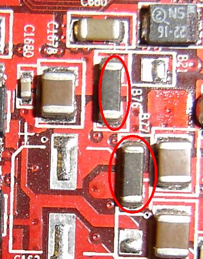

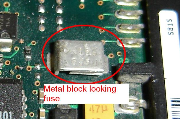

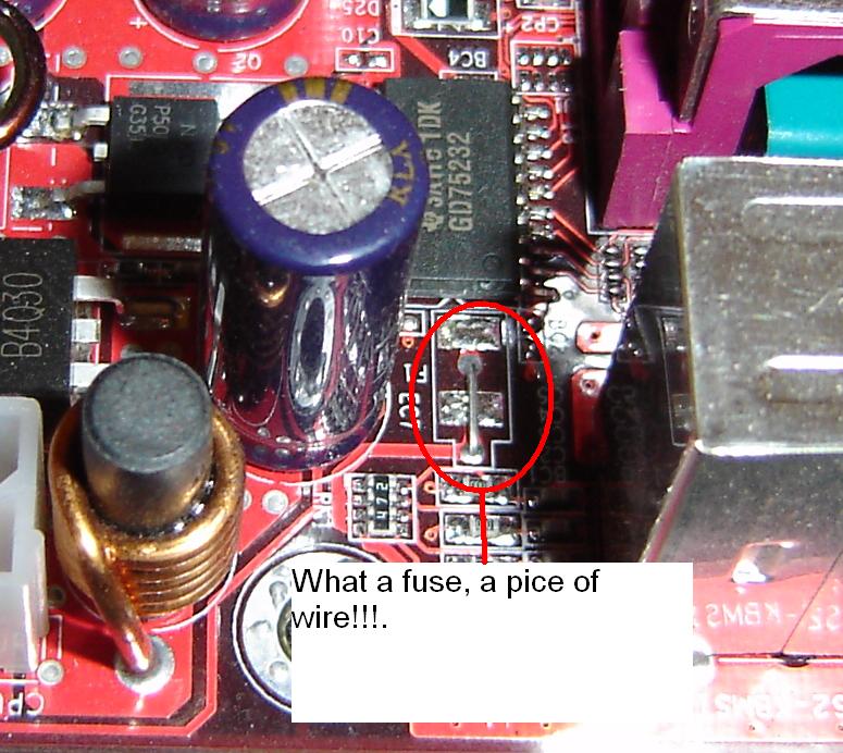

                No problem, heres a few more I forgot about and maybe not known of.
                I don't have a pic for the 1/4W resistore fuse.
                BTW the little grey retangular blocks in the first picture are actually coils but they will open if there is too much current, hense acting like a fuse(seen usb ports use this and even replaced them)

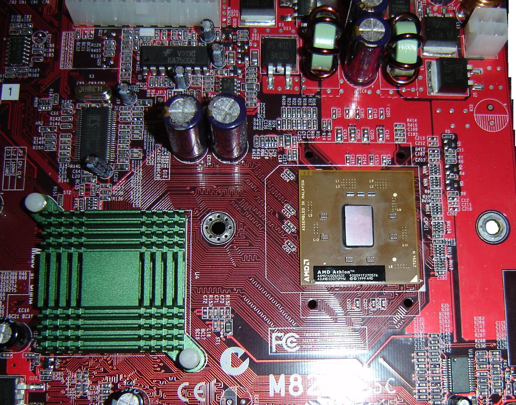

                  Last pic is from a PCChips motherboard isn't it..?
                    Damn, it must of been that OST caps that gave it away .
                    Ya it's a M825 V7.5C, has the cpu soldered to the pcb. I would recap it if I can find a heatsink for the CPU.

                        BTW the fuse can be changed, tweesers and good lighting and you have it set.

                              Nope, my M848 V2.x had "fuses" like that..
                              Hey cool a SMT mobile athlon XP...
