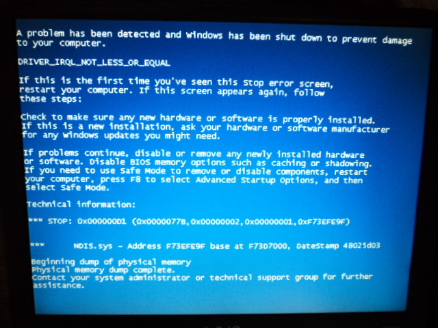

                    i think i'm going to give demian 7,0 wheezy another try,my win xp is giving me trouble again see atachement,i hope i count on you to help me on the wireless trouble,
