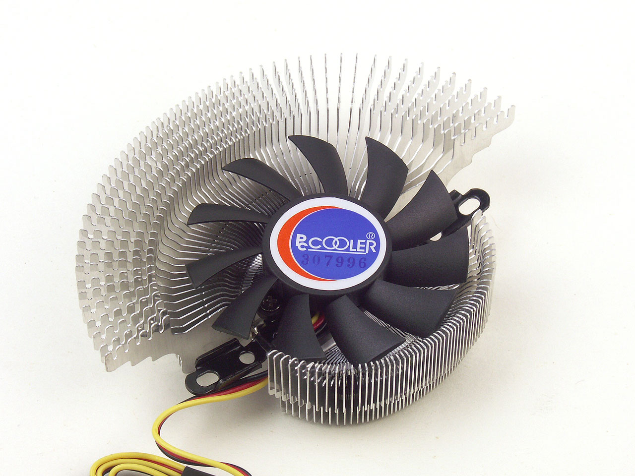

    Help me guys ,
    I brought a VGA copper HSF with only HKD$15 , a few weeks ago. It is the same type as the attached image. It was so cheap that I just brought it before having any idea to use it for.
    It comes with a small 3-pin fan connector. The wires are red, white & black respectively. Now, I wanna make it a standard 3-pin fan connector. Can you guys tell me which is 12v, speed sense & ground ?

    Usually black is ground, yellow is +12v, and green is the speed sense on a regular HSF. You can easily test yours by taking pairs of wires at a time and checking DC resistance. Of the two minimum resistances you find, the common line in the two pairs is ground (probably black). You also should have fairly low resistance between the +12v and GND lines on the fan. You can check them by momentarily touching the two candidates to +5v/GND. If the fan spins, your guess is correct, otherwise repeat with each of the other pairs.

      Thank you so much. I finally made it.
      I measured the resistances between wires as fellow :
      - between red & black = 9.6KΩ
      - between red & white = infinity
      - between black & white = infinity
      So , the red is for 12V , the black is GND & the white is speed sense.
      I soldered them with a 3-pin connector. Wow, it spins at 4500 rpm which is quite noiseful. I think this is the only draw back. For the price of this HSF, I have no complaint at all.

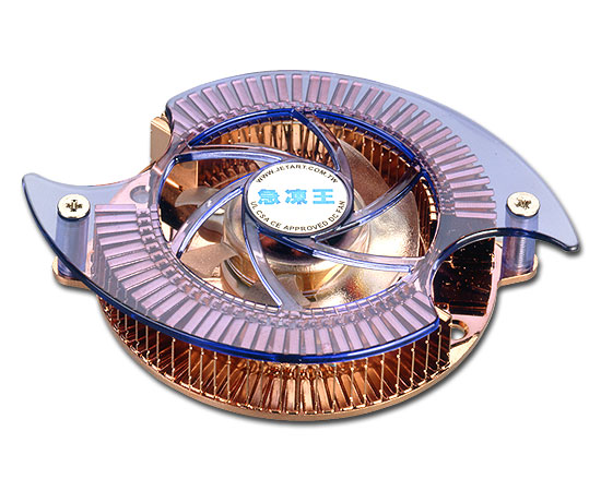

                Take a look on the images and guess which one is better !
                Well, the copper one has a small & slower fan with red , blue , yellow blinking LEDs. The aluminium FSH has a higher CFM, over 3000 rpm fan and much larger surface area for heat dissipation. AFAIR , they cost around CNY¥65 and CNY¥4x to 5x respectively.
