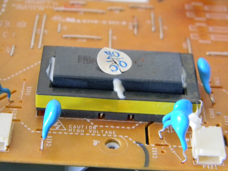

    After replacing caps transformer starts to buzz
    After replacing caps transformer starts to buzz when display is not lid up.
    For example if display goes to standby mode it starts to buzz on powerboard.
    Is there any general fix for that ?

    Re: After replacing caps transformer starts to buzz
    What caps did you replace? Sometimes small caps can cause buzzing if you don't replace them
      35v 470uF
      maby try biger voltage ones there?
        pic of transformer:
          You could try removing the old solder and resoldering it with new leaded
          solder. You could also try varnish or superglue on the windings.

            What brand are the replacement capacitors?
            Also, have you replaced the big high voltage filter capacitor yet?
              LG - W1942S
              Pics of power board:
              http://imgur.com/a/IdW5I
              C207 one leg copper is loose from board but works fine.
              haven't replaced big high voltage filter capacitor. Seems all flat from top - no need to raplace.
              all soldered legs tested with beep function - all good. Also tested loose copper track from various distant points.
                Testing the transformer legs with a beep function means nothing!.
                Remove the old solder and resolder them with leaded solder.
