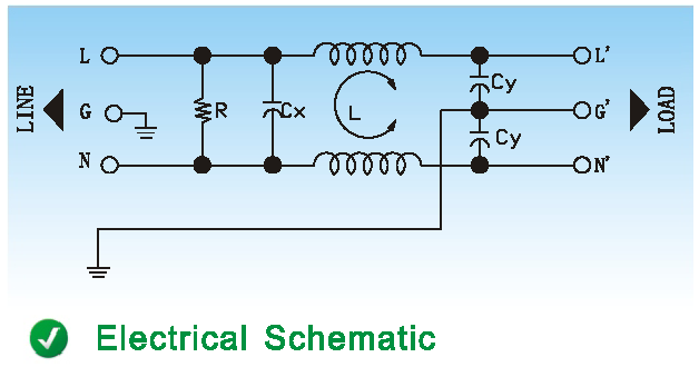

    AC/Input Filter
    nothing special, really. i'm just bored seeing psus without a proper input filter. so i made it in it's own separated board. yes they're expensive. it cost me not less than $8.
    but for PSU, usually i spend $2 or 3 for a smaller double choke, 2 caps type x2 (matsushita or philips), three leg power connector (moded).

    what does the resistor between ground and neutral do?

      Re: AC/Input Filter
      it will limit the current when something 'bad' happens, i guess. cmiiw.
      i got the pcb and all components from the shop and just tried to make that schematic.

        Re: AC/Input Filter
        It may be keeping the MOV happy.

          Re: AC/Input Filter
          Without R1, depending on what part of the AC sine wave you turn off power, the X-caps can be charged to whatever the peak voltage of the AC line is. And those film caps will hold that charge for a lo-o-o-ong time. Murata and TDK make ceramic Y-caps, and those might be less expensive than the film types you used.

            Re: AC/Input Filter
            Thanks for your explanation!

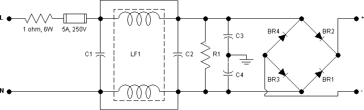

            more schematic i 've found:

                                The bypass capacitors, depending on value, filter out different frequency ranges. If I recall correctly, in many circuit, before IC's, the suggested combination is a 0.1uF, 0.01uF and 0.001uF or 100,000pF, 10,000pF and 1,000pF. Maybe it's different when you're dealing with mains, but I can't imagine why. EMI/RFI happens in either case.
                                Question: In the first schematic in the thread, there are pairs of caps before and after the inductors, C1a+C1b and C2a+C2b, respectively. When wired in parrallel like this, won't that cause the two capacitors to act as a single capacitor of half the capacitance?

                                  Re: AC/Input Filter
                                  Nope. Caps in parallel add, so two .1s in parallel equal .2uF; OTOH, two .22s in series equal .11uF. Basically, it's the reverse of the series and parallel rules for resistors.

                                      Great job on the construction. A couple of comments on the circuit: disregarding the x-y caps for the moment, this is a low pass pi-network noise filter. What makes it unique is that the network is symmetrical (has L in each leg) and that there is inductive cross coupling between the windings. The inductive coupling improves the stop band (high frequency) cancellation and is effective when both source and load impedances are low. But the values of inductance and capacitance are important for the filter to work. Most inductors are not marked so they would have to be read with an inductance bridge. Secondly, the wire size used on the inductors needs to be matched to the current requirements of the power supply. Seems like a simple enough circuit until you look closer.
