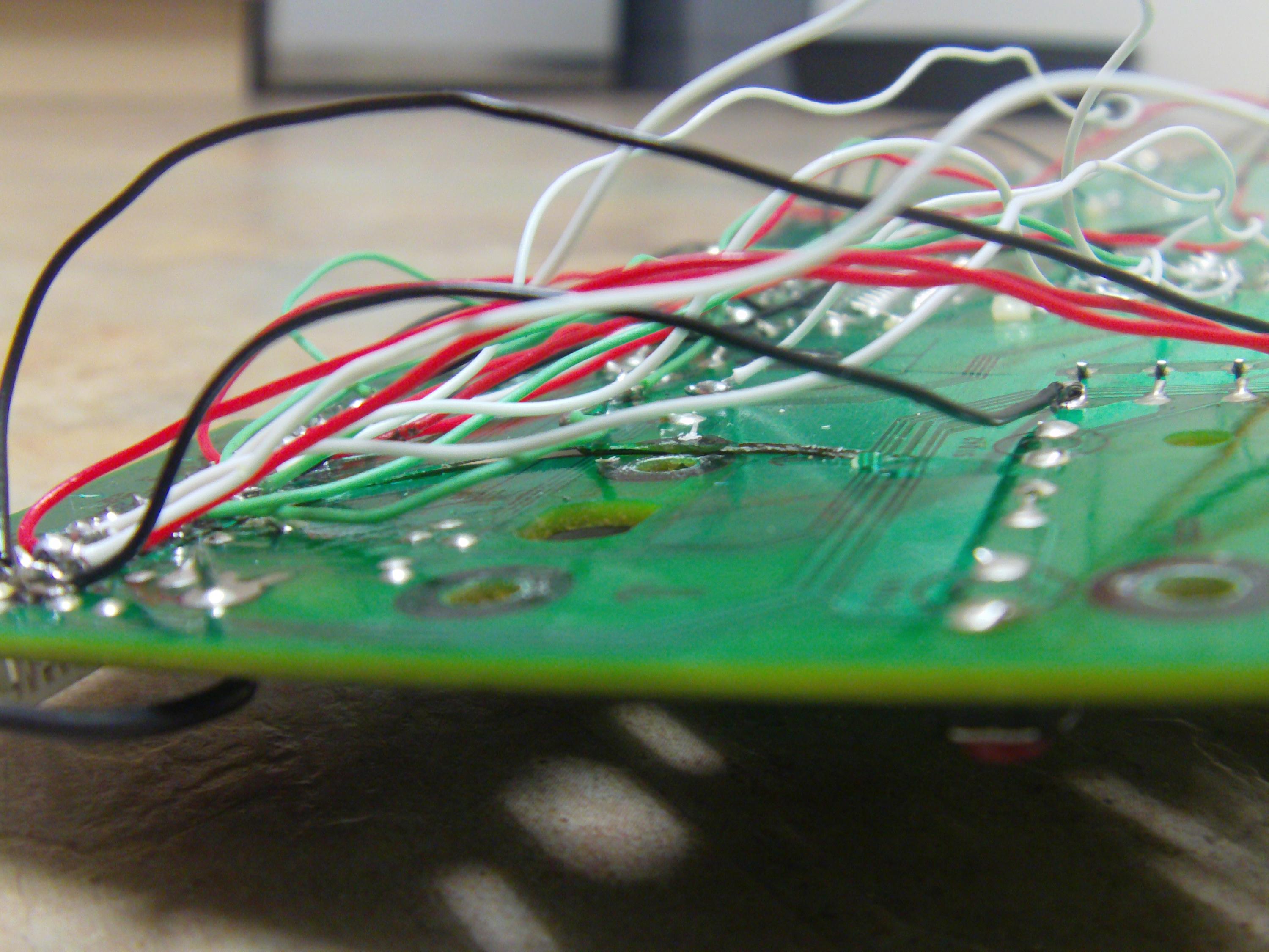

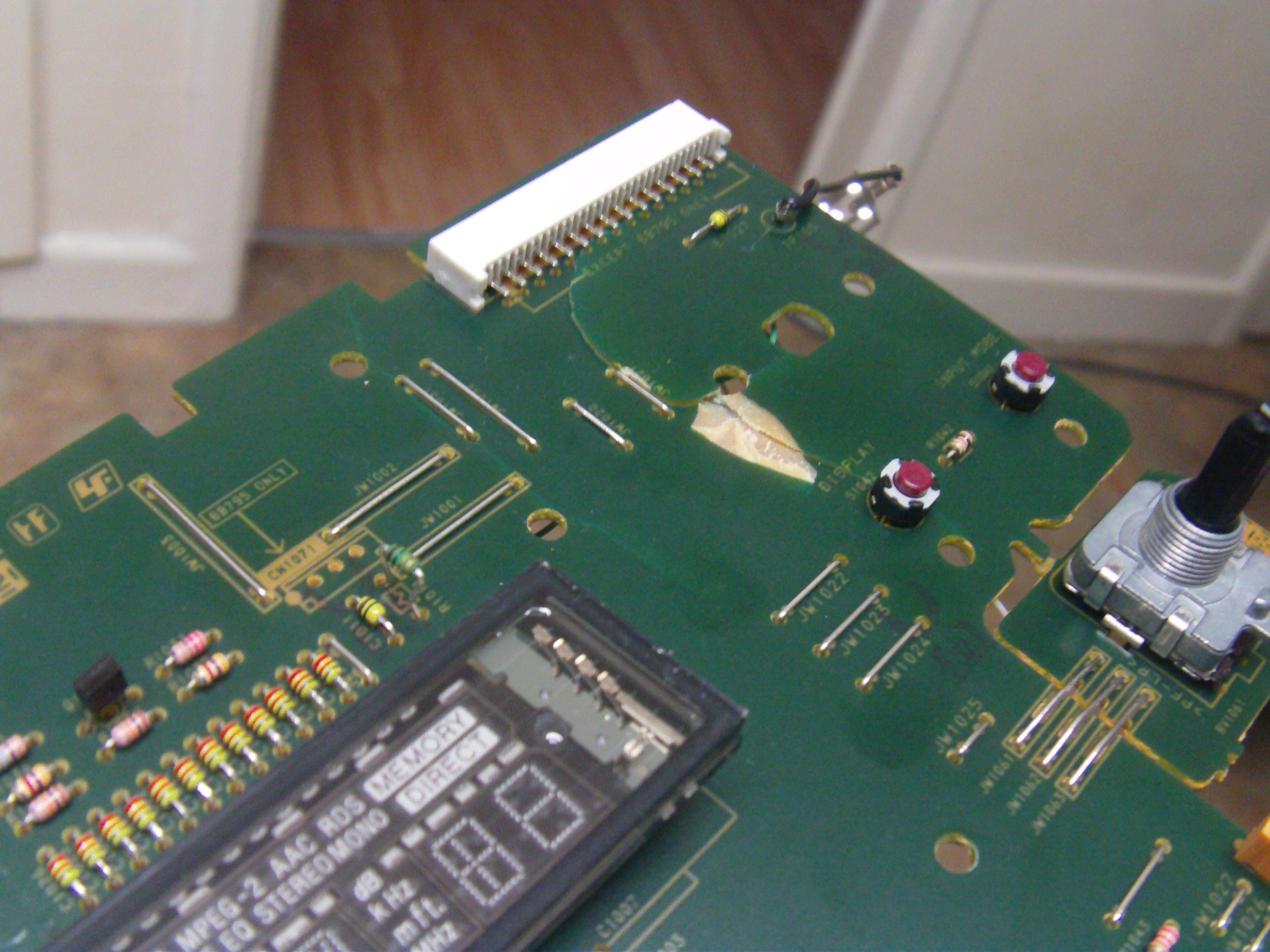

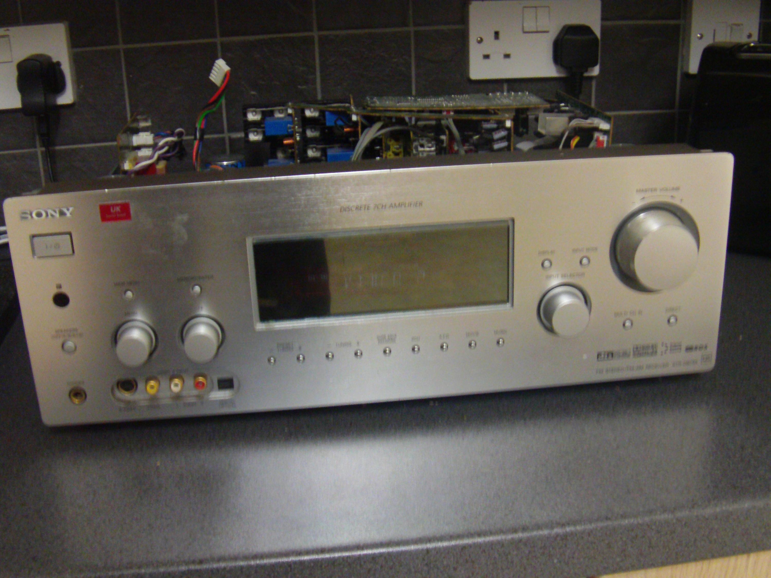

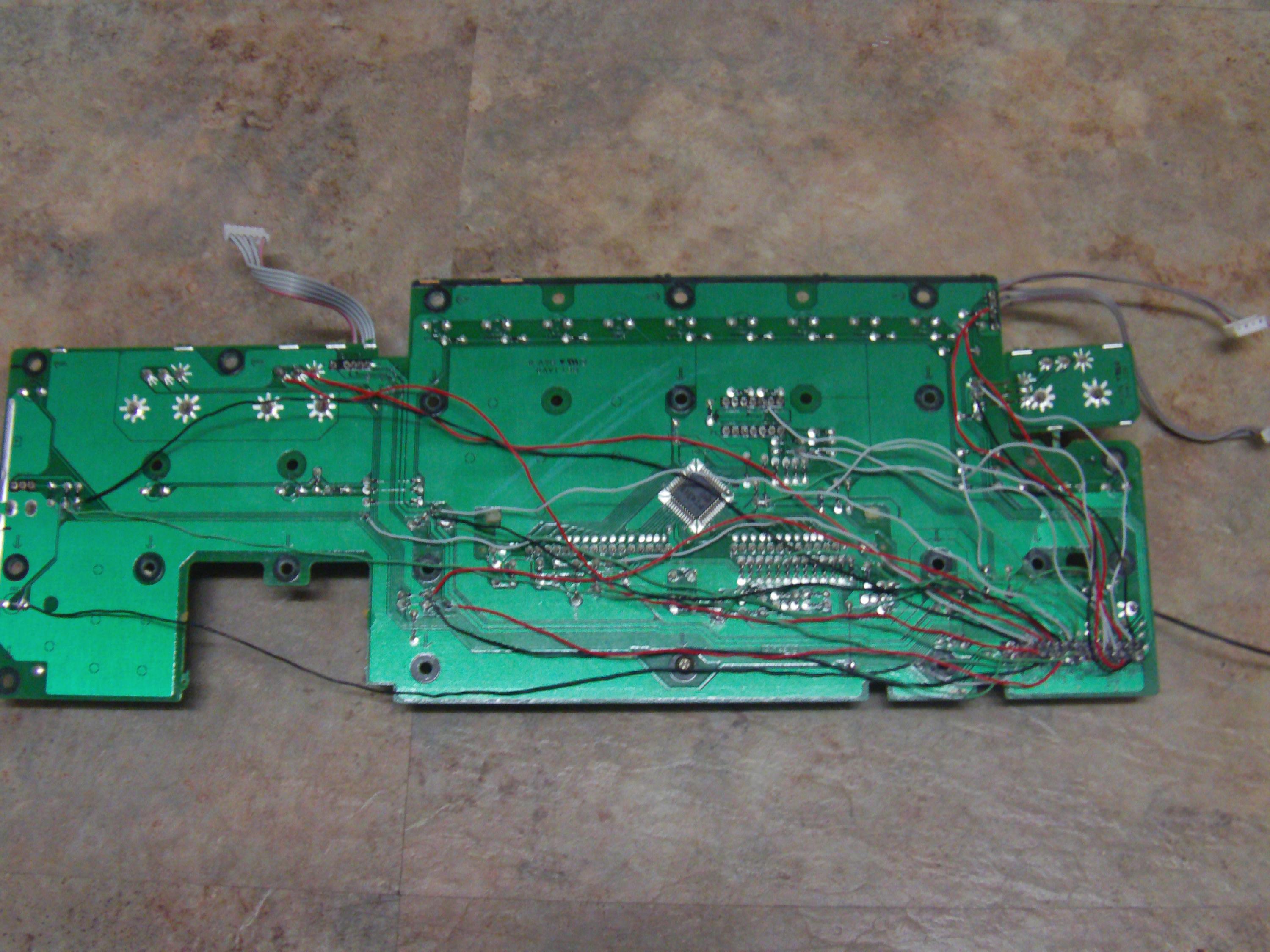

                            I am now an expert at fixing traces on circuit boards, that good you cant even tell where i mended them
                            The fix/mod/whatever can be found in the audio section on this site.
                            Amp is now working fine, just a dim vfd
                            https://www.badcaps.net/forum/showthread.php?t=25220

                              Cool repair. Glad it works too . One of my friends tried to repair a laptop before but ended up scratching traces on the board badly when he had an "oopsie" moment with the screwdriver. Asked me to mend the traces and I did. Those were all tiny hair-like traces as well going between the CPU and SB and I could solder only to the vias. He never found the original problem with the laptop, though, so it was a complete waste of my time (I kind of knew that already).

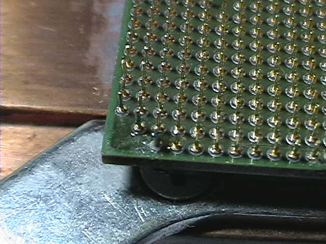

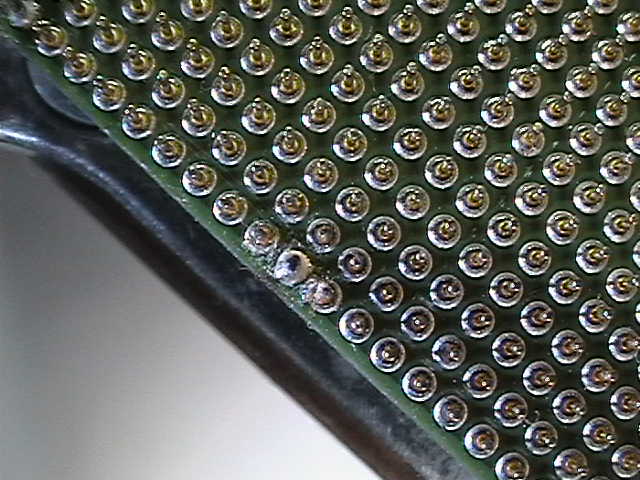

                              On the line of fine repairs, here's an S939 AMD Athlon 64 FX-57 CPU I fixed:
                              https://www.badcaps.net/forum/attach...1&d=1357267053
                              This CPU was left by some customer in my friends repair shop and sat on my friend's desk for over a year (if not 2). During that time, the CPU has had various stuff sitting on it. It even took a drop to the floor a few times. As a result, almost all of its pins were severely bent. 2 of them were actually broke when I found it, but as the pictures show, I was able to solder a thin piece of wire from some through-hole 1/4 W resistors. I expected fireworks when I plugged it in my mobo, but it actually worked fine. Unfortunately, my only working S939 motherboard - an AsRock 939Dual-SataII - is a finicky piece of turd that crashes very often even with my Athlon 64 3200+. Installing the FX-57 just made the board crash even more often (in games, that is).
                              By the way, sorry for the crappy pictures. My camera cannot take such close up shots so I had to use an old camcoder that can only take snapshots in 640x480 res.

                                Is it worth the time to fix that cpu? I have no idea about 939 cpus?

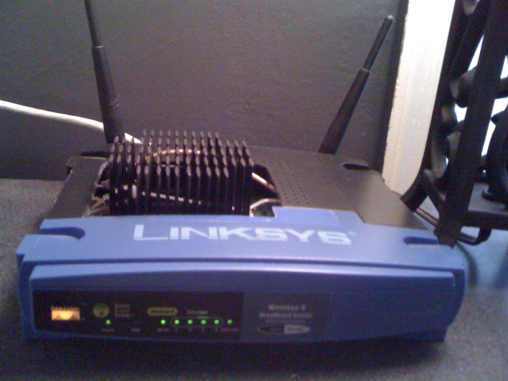

                                  Added a heatsink from an old SGI Origin 200, which allowed me to overclock the router safely in DDWRT. Plus it looks fast.... ;-)

                                      That router reminds me. I did something like that to a Netgear DGN1000. I might still have it.

                                        That's superb craftmanship . Processor pin fiddling is a difficult art that can easily drive you insane . My Tualatin 1400-S is still trembling from the incredibly harsh language it required to run OK in the i440BX mobo .

                                          looks like my overclocked desk lamp with the altilon led mod.
                                          i dont think there is anything on my workbenches or desk that has not been modded.
