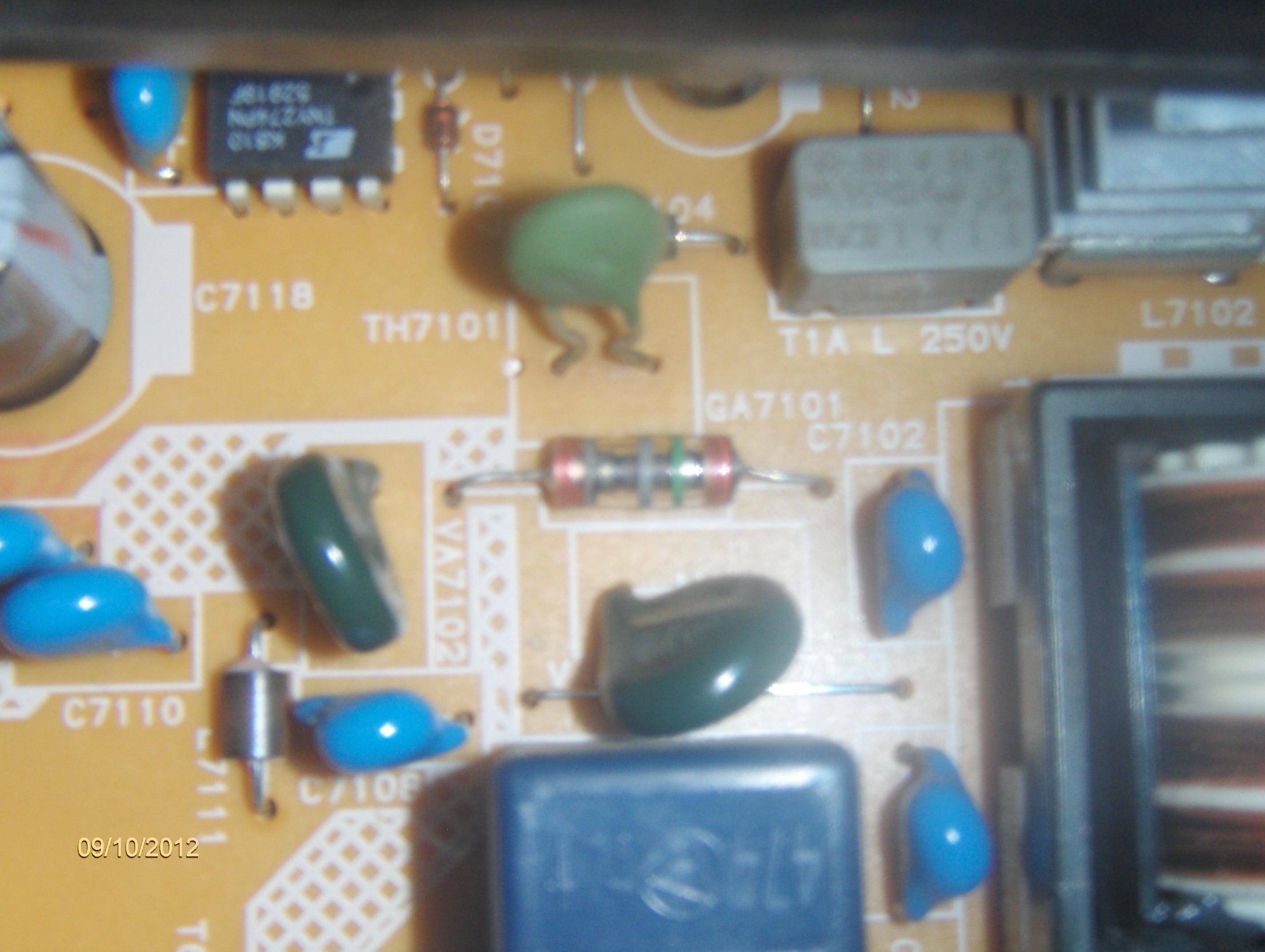

    What is this
    It is on a Sanyo power supply, It looks like it is glas. It does not have continuity, no resistance and no capacitance. What is it and how do I test it.

    Re: What is this
    GA might be
    http://en.wikipedia.org/wiki/Gas-filled_tube

      Re: What is this
      IS there a way to test it?
        Re: What is this
        It is TVS (Transient Voltage Suppression) Gas discharge device, which will conduct when breakdown voltage is reached, you can only check for shorts, you will see the inside will be blackened if it was exposed to real high voltage.

          Re: What is this
          It does not have continuty, does that mean it is good?
          Thanks budm

            Re: What is this
            Should be
