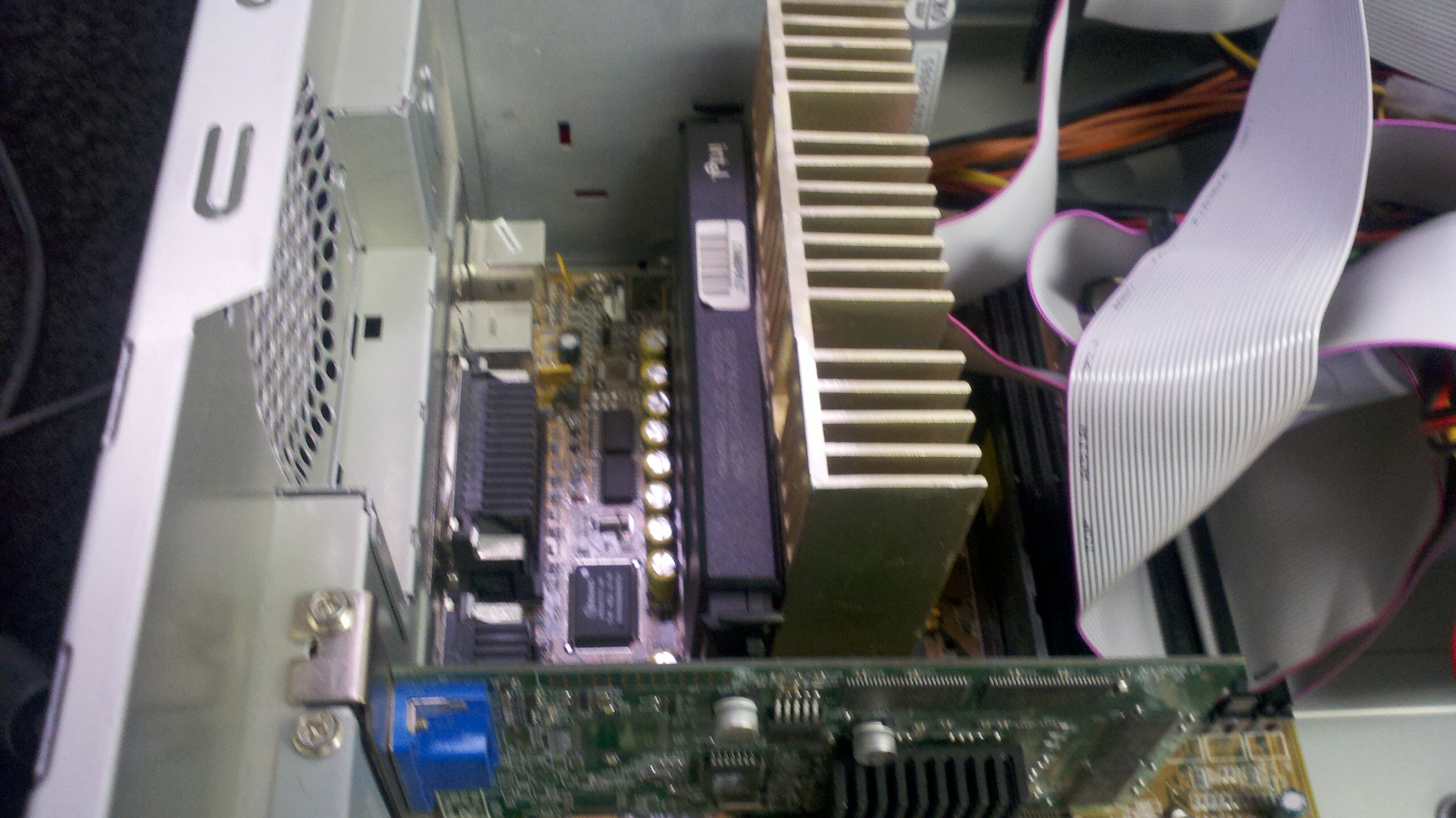

    polys in a slot 1 board for a cmm
    overkill but i got a ton of these caps.
    originals were iq.

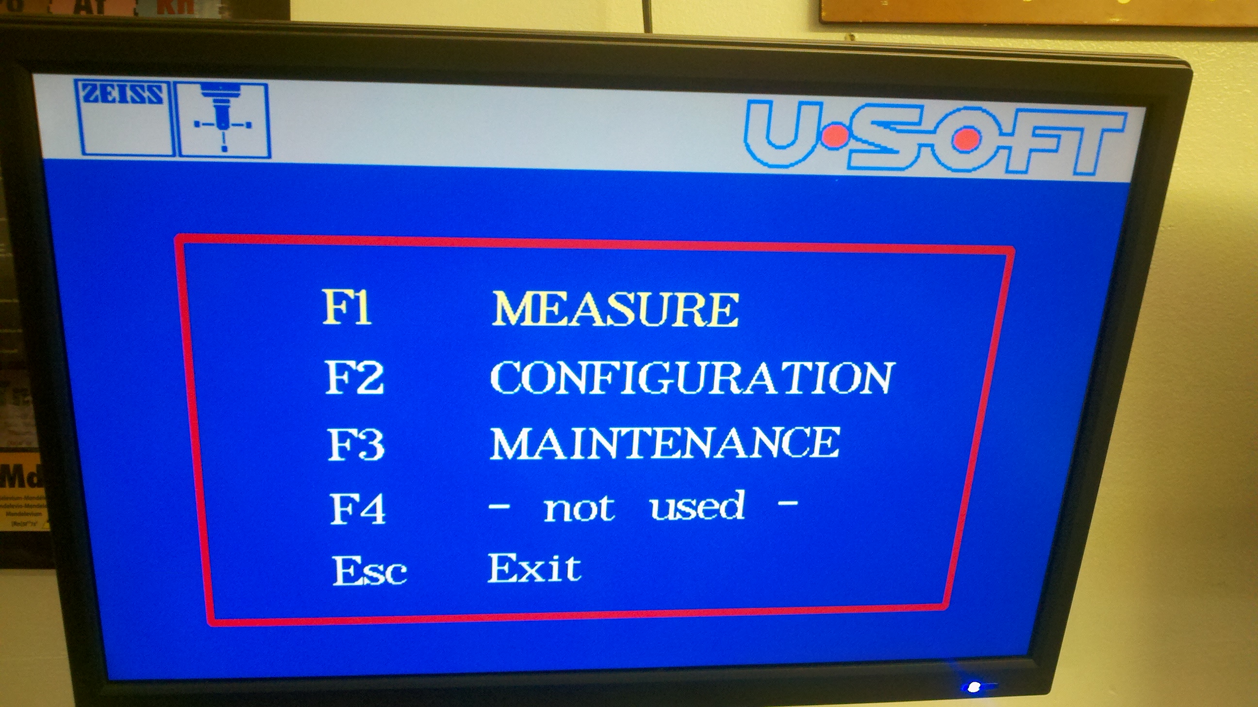

    would lock up and then reset after the software started.
    been running several days now.
    this cmm is fussy about hardware.pain in the ass to find boards they like.
    i maintain a bunch of these.

    Re: polys in a slot 1 board for a cmm
    I'm calling this an Epic Win! There is nothing better than "set it and forget it" fixes.
      I have a feeling this thing will be a museum piece in 100 years from now, still fully functional and running.
