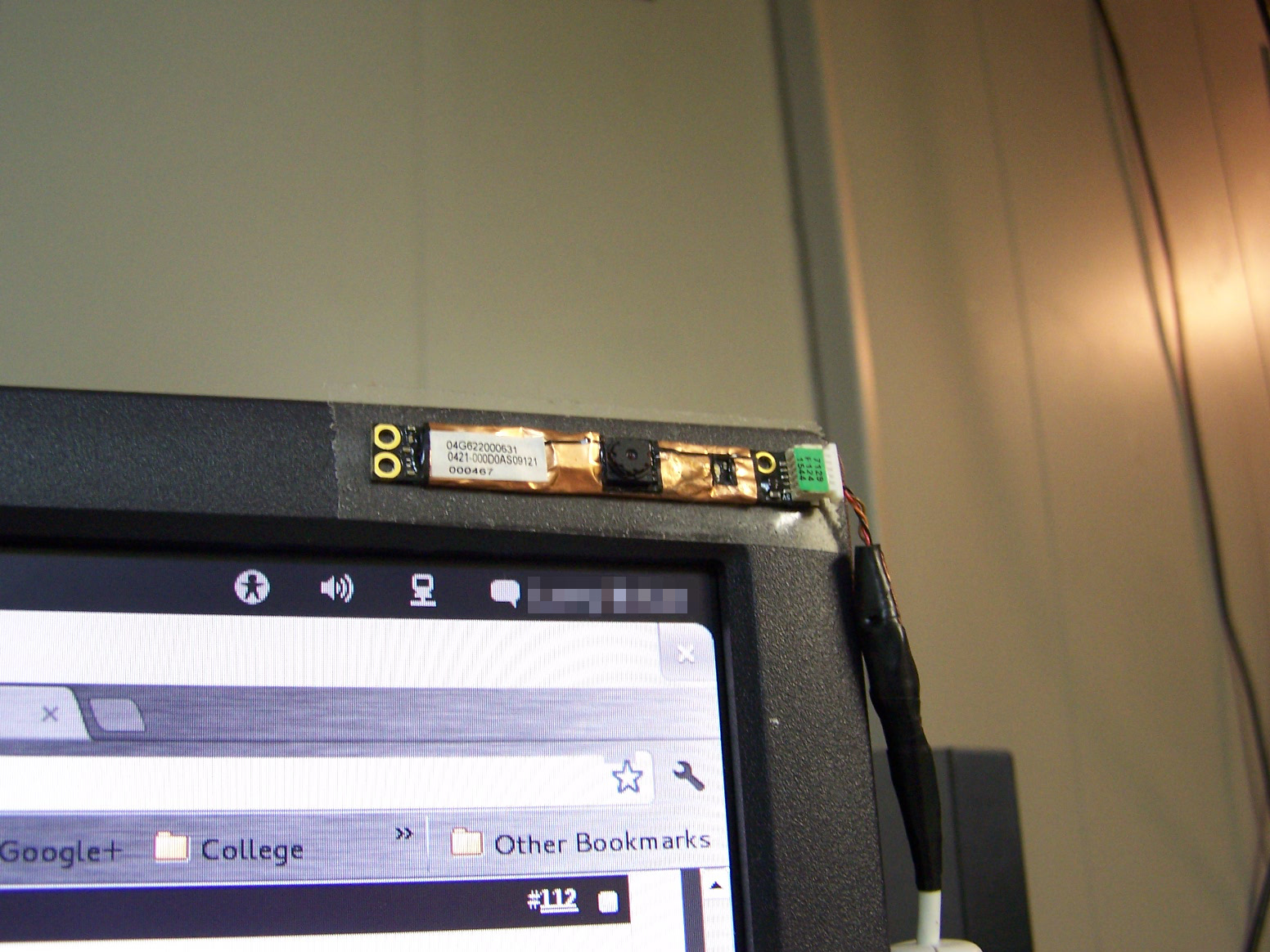

    Recently I have been using skype to video chat with buddies abroad. While the webcam I use with my laptop is running great, the old crappy Quickcam Chat I had was DOA.
    I happened to have the remains of an EEE PC 1000HEb lid that I pilfered a screen out of last fall... combine that with a skinny useless Canon USB cord and you get:
    Yes, I used double-sided tape to attach it. To connect it to the computer, I chopped off the mini-USB plug from the donor cable and solder spliced it to the cable pulled from the EEE lid.
    Splice pattern:
    EEE cable : Standard USB
    Black : Red (5V+)
    Brown : White (Data+)
    Red : Green (Data-)
    Orange : Black (GND)
    So far it has been working great.

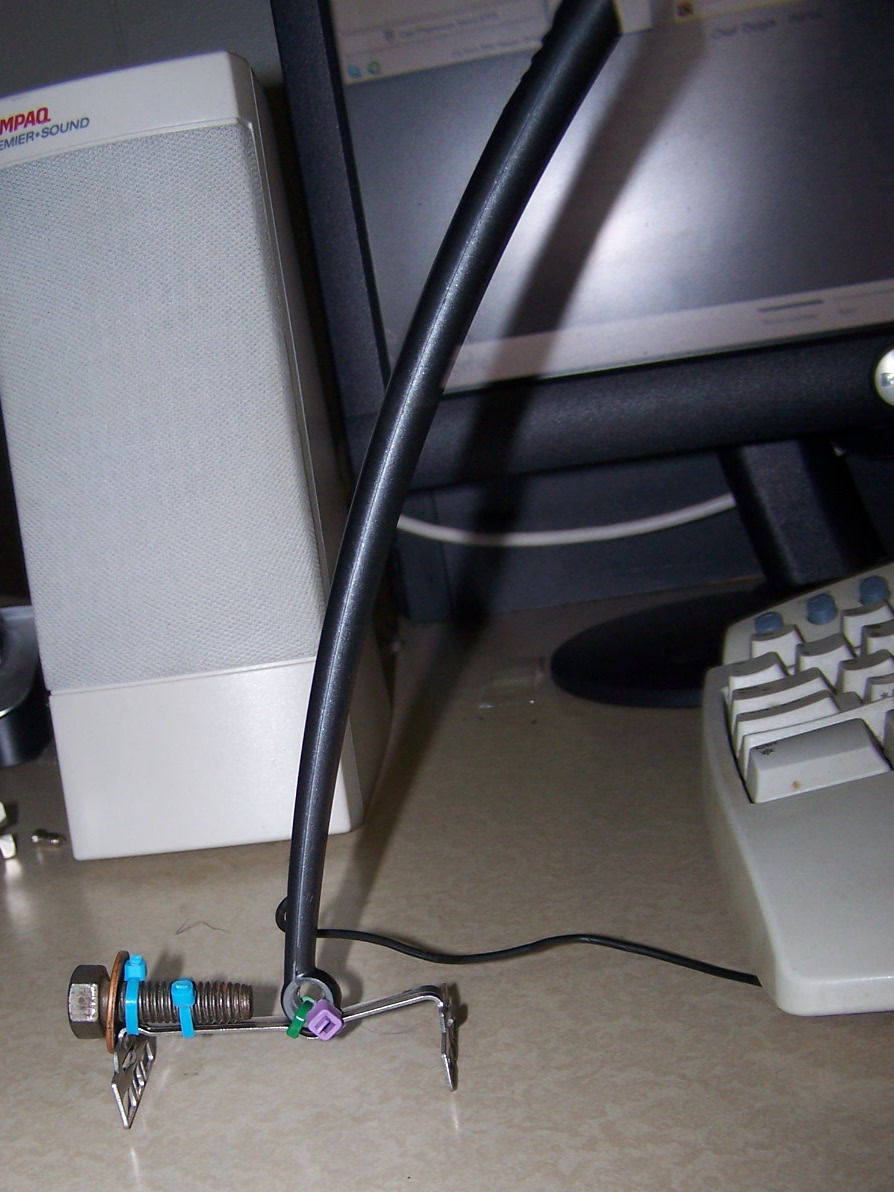

    However, it has no built-in Mic so I am using this instead:
    What happened was I was given this Logitech stand Mic for free but the base was slipping and wasn't really fixable. I had tried bolting it to something but that failed (hence why it's drilled out). This desing, Using a 462 Cooler clip, zip ties, and an old bolt (counterweight) actually works pretty well. I may eventually get a headset mic but for now this will do. Besides, its noisy down in the basement and webcam mics picked up too much background clutter.
    Pretty ghetto, eh?

          no pics of the fix
          It was probably the hardest solder mod I've done in some time... I stole a mini-usb jack off a dead mp3 player, nipped the "x" pin between pins 3 and 4, and nudged over pin 4 to make the legs match the solder pads.
          after soldering all 6 joints (4 data + 2 anchors), I added super glue to reinforce the jack.... I accidentally glued the USB cable into the jack in the process, at least it's solid
          the tape isn't working too well... I'll probably just buy another webcam but I figured this would be a fun project.

            Still no pics of the final job, as it has been finicky... I should have remembered that that particular cable was on the "iffy" list before I glued it into the plug... . I wish there was a good way to fix that... oh well, I'll probably buy a webcam like I was going to in the first place.
